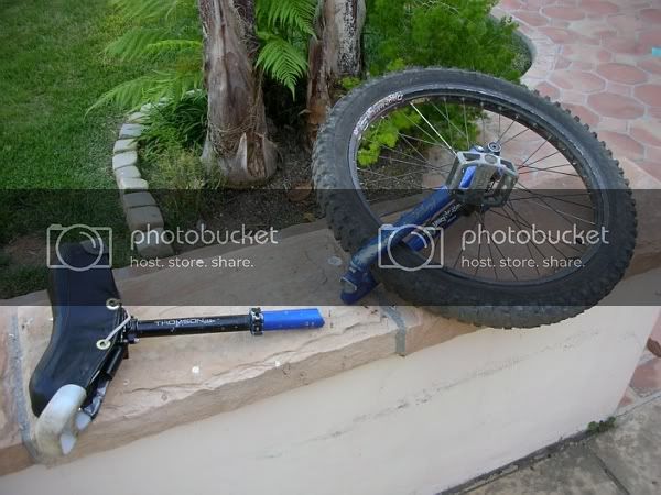

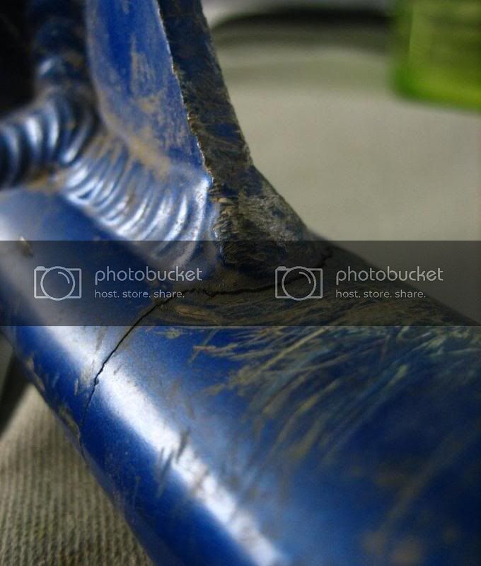

Yes, the KH line has come to replace the Wilder/Profile combo, though the later still remains a classic, perhaps the first world-class Muni set up in terms of technology. I wish mine (in that picture Josh posted) was still in one piece.
