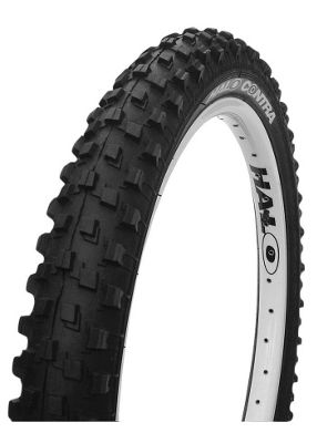

there are other tyres out there just not many. for muni i have only ever used the duro both 26 and 24 a quick search and i found this one it says it is 24 x 3
http://www.chainreactioncycles.com/halo-contra-24in-tyre/rp-prod12381
Rebranded Duro Wildlife?
I just compared the tread pattern of the photo of the Halo Contra 24" x 3" on the Chain Reaction Cycles website with the actual Duro Wildlife 24" x 3" that came on my N24 and it’s the same tire!
So there’s your answer: What happens when the Duro Wildlife 24" x 3" disappears is we start buying & using the Halo Contra 24" x 3".
And at $34.49 from Chain Reaction vs. $55 from UDC US, we get a $20 price break.

Yes, great find by UnicycleSam123 and also some very good photo forensics by UPD in Utah.
One of the user reviewers at chainreactioncycles even says, “I am onto my third Halo Contra (previously marketed as the Duro Wildlife Leopard).”
I just checked and I agree, the halo looks exactly the same. And for the person that asked where i am at; I am in the United States.
This was discussed a while back, and the consensus was that it is the same tire. AFAIK Duro is a tire manufacturer, and Halo is a brand that markets the tire. Who knows maybe one day that tire will be available as a Nimbus “TerMUNator”. I know it’s a reach, but …
It can’t be too hard to keep this tire around with one name or another. It’s not like a new mold needs to be made. Look at the threads on the development of the Todd tire. My guess is that if someone wanted to make it available, or maybe the intense, the order number would be far lower than for the Todd due to the existing molds
A little sleuthing and yes, Duro is a tradename of Hwa Fong Rubber Inc out of Taiwan, which has been around since 1945 and produces tires for all sorts of applications.
In looking that up, I noticed that there is also a Duro Razorback which has been offered in 24" x 3.00" and which several have said was also identical to the Wildlife Leopard.

Yes the Halo is a rebranded Duro. But because the tread and even weight the same, doesn’t mean it’s the same tire. Casing, profile, or tread com point could be different.
The Dura wildlife leopard is still going to stay in production for the next 12 months. We actually asked Dura this question last week.
Currently there are 2 importers of the 24" Dura wildlife leopard in to the UK, Unicycle.com and Ison. Ison Distribution (sometimes called ID) rebrand their tyre as the Contra.
