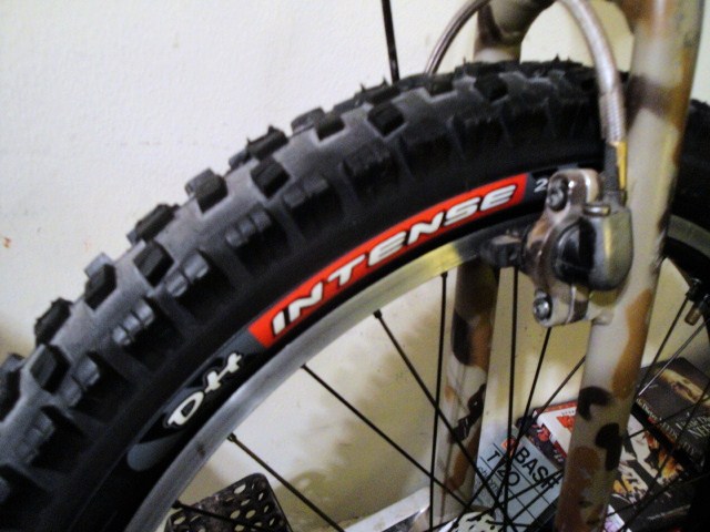

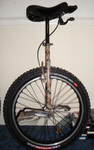

I would recommend the 24x3 intense! Jamey (from uniproshop) still has some left and they are waaaay better than the duro, and 1/2 pound lighter! They also wear much longer. I think he has them for only $39. I also had an orange nimbus MUni frame, and there was even more tire clearance for a 24x3 (it seemed) than my kh!
