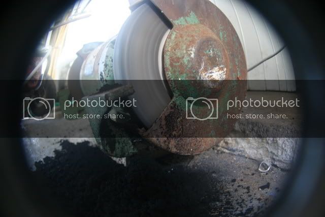

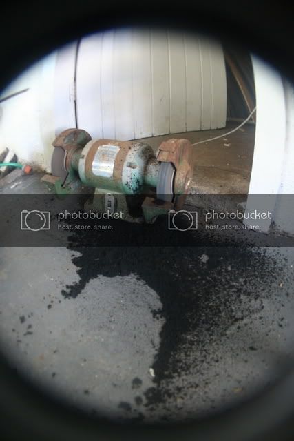

I just ran around the outer tread with the bench grinder, shaving a pile of rubber off each knob.

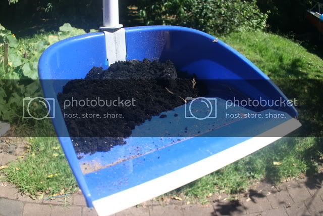

No photos of the before, but heres some photos of the aftermath.
Took maybe 10 mins to get it like this, maybe 10 more to make it completely smooth using the grinder. Balding a tire using other methods usually takes upwards of an hour!!!

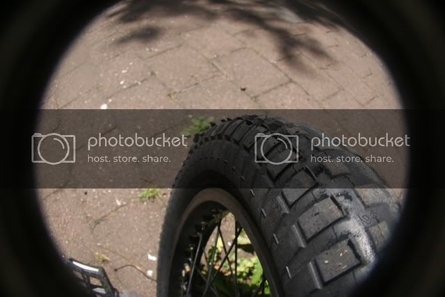

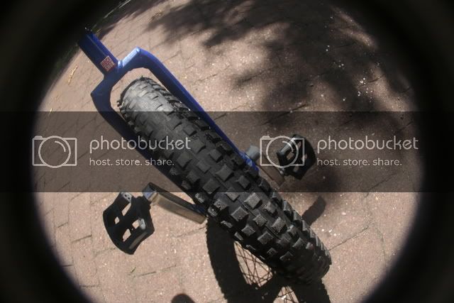

…and photos of the tire itself
It’s also noticeable to most people, that the trials tires tend not to wear on the outer edges, so essentially all I have done is even out the wear across the tire. But I prefer a worn tire anyways, even if only slightly smoother.
I have shaved it a bit more since posting that, but I left the tread in the middle as that will go on its own. The side tread is now shorter again.

muzzle what kind of tire is that in the pic?
Isaac
Edit: if I read correctly its a Monty Eagle Claw?
Monty 2.7, I think the Eagle Claw is a 2.6.
