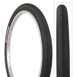

I reckon a Intense micro knobby in 19"x2.7" would be sweet as for flat/street. On rocks and concrete it would have more grip than a Trials tyre I think, as the small pins would grip into small crevaces etc.
19"x2.7" !?
Where ?
I don’t think Dandelion meant that it was available. I think he was saying that it would be his ideal tyre. I think he’s got a good one there, now we just need some manufacturers to realise there is a market for this type of tyre.
