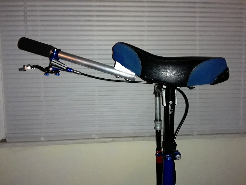

This modified setup feels as solid as any handle I’ve ever used, and I really never put a lot of weight on it either pulling up or pushing down. If I’m doing steep climbing my grip is much closer to the front of the saddle so there’s less stress on the interface. I’ve ridden it pretty hard the last few days and it feels solid as a rock. This started out as just an experiment while I was waiting for the mad4one saddle handle.

Here’s a shot showing the interface:
That bar is steel, so it’s a lot less vulnerable to fatigue failure than an aluminum bar.
I was looking at bolting the handlebar end of a 4-bolt bike stem to 4 new holes in a KH style plate, and clamping a MTB handlebar in the steerer tube end. That way all the parts are being used the way the designer intended. The project lost momentum because cutting my own KH style plate seemed like too much work. And cost of buying one from UDC (a half hour up the road from me), plus the shipping, plus tax, seemed excessive.
Do you think is rigid this handle?
May be too much torque…
I put machine screws through both walls of T6 aluminum tubing. Solid as it gets.
The way I see it, the problem is not about how strong the screws or whatever components are, it’s that the distance between the two attachment points is very small compare to the handle’s length.
A long lever applying a (potentially) massive amount of torque on a small area. Kinda like a crowbar.
Yes, for me is the same concern… For instance the KH handles break under hard use, I´ve seen someone selling a spare replacement made of steel as an upgrade!!!
Also the saddle base is taking most of the stress (may be yours can handle it because is fiber carbon ???)
All I’ll say is well done Terry for staying positive during this round of… constructive criticism.
Build it, ride it, if it breaks then improve it.
Sorry for the thread hijack!
I love the idea of a straight post or a U post as a handle evolution!!
Great work, well done, keep pushing and share with us your impressions!!!

Continuing to modify and refine my mono handle. With this version the base is attached to a plate which is secured by all 4 mounting bolts just like a standard handle. Total weight: 135g. I plan to shorten the handle by about 4 inches, roughly the length of the foam grip.
