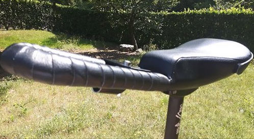

While I’m waiting for my hoop handle I decided to experiment with one of my aerobar tubes which weighs almost nothing and doesn’t even register on my digital scale. It’s instantly 1.5 lb less then my KH T-handle & brackets. I cut out a lightweight piece of wood to fill the recessed area under the front of the saddle, (Scott Wallis CF base) then drilled two holes through the wood piece and aero tube, and attached it.
I don’t mind not having an up or down adjustment since this particular configuration is just right for me. I can always use washers to change the angle if necessary. This setup is actually ideal since I usually only ride with one hand on the handle anyway.

I’m no engineer but I remember Archimedes’ lever principle.
Can you really pull a little hard or put some weight on that long handle without tearing off its attachment?
Here it is flipped upside down. After a test ride I prefer this position.
:o
Definitely seems to be solid. It’s held by the same bolts used for a lift handle or KH brackets. If necessary, I guess I could reinforce it with a couple of U brackets.
I’d worry about it failing - when you push down, all the stress is going to be at that forward bolt, where there’s a hole drilled top and bottom to weaken things. That’s a recipe for fatigue failure, even if it’s solid enough in the normal sense.
Probably be fine for me, since I don’t ride much, but not for you!
Time will tell.
People are always so worried about failing parts here.. They don’t usually lead to spectacular bails, just regular ones.

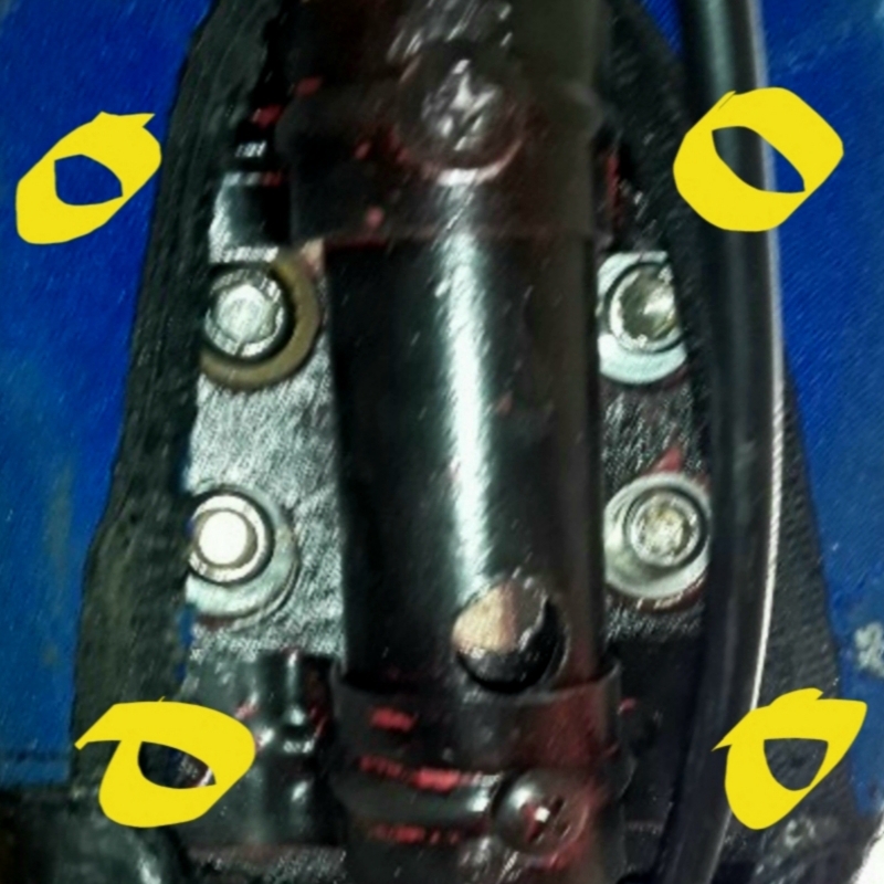

I redesigned the setup so now the wood insert that fills the recessed area is attached directly under the saddle via the existing four bolt pattern. And the handle has now been attached in the center using two pipe straps. Everything now comes out in one piece and is very easy to install without needing to remove the saddle cover. If I want to flip the handle 180 I simply remove the screws from the center of the straps, flip it 180 and reinsert screws in the corresponding holes on the other side. Out for a test ride and this modification is super sturdy.
Reckon it’s an improvement.
Now if it was to fail, I reckon it would be at one of these spots where the pipe strap attaches. I’m going off an assumption it’s attached screwed into the wood piece or plastic only. If the screws are really long, then I reckon it will be fine.
Those are machine screws and they go all the way through with holes countersunk on the other side for the corresponding lock washers and nuts so it’s pretty secure. But because wood can crack I am planning on making a mold with J-B Weld to replace the wooden insert. If that turns out not to be satisfactory then I will find a piece of half inch nylon or polyethylene and cut that out to the same shape.
Having an aerobar break with your weight on it, on a geared road uni, is pretty much a worst case failure - result would likely be a high speed faceplant into a rock hard road surface. Ugh.
U-bolts sounds like a pretty good way to attach a bar - no holes drilled in the bar, and bolt spreads the load out instead of concentrating it at single already weakened point.
