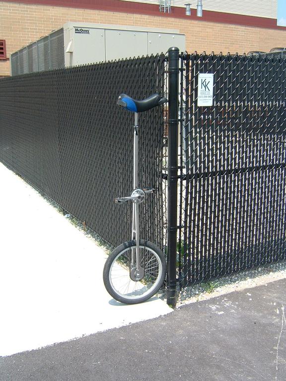

OK leadpan, I went out and did a photo shoot just for you. Here is how I mount my 5 footer with assistance from various things:

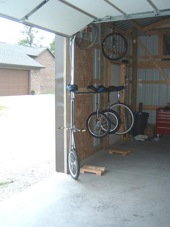

Pic 1. I open the overhead garage door in my shop and place the giraffe as shown so the wheel is in the V between the overhead door track and the wall. The seat positions in the V as well so that neither the wheel or seat can move sideways. The pedals are placed horizontal with the one I’ll step on first placed so that it drives the uni forward into the V. I then mount as follows:
  1. Left hand holds the seat, pushing it forward; right hand grabs the overhead door track.
  2. Right foot on the wheel.
  3. Left foot on the pedal.
  4. Right foot on the pedal.
  5. Sit down.
  6. Get situated comfortably.
  7. Continue holding onto the rail as I use an idling type move to point the uni outwards.
  8. Lean forwards slightly as I let go and begin riding.
Pic 2. Same concept but using a pole mounted on the side of a school. Use the V that exists between the pole and the wall.
Pic 3. Same deal but using a fence and fence pole.

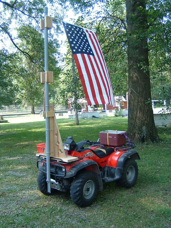

Pic 4. Mount in parades using my U.S.V. (Unicyclist Support Vehicle) pole. The pole has a cut-out for the wheel and wooden contraptions for keeping the seat from moving sideways.
Last but not least, tennis court fences are great because they are tall and you can grab them anywhere with your hands. Unused tennis courts are great because there are no cars to worry about.
Hopefully that helps. Please follow up with some success stories.
