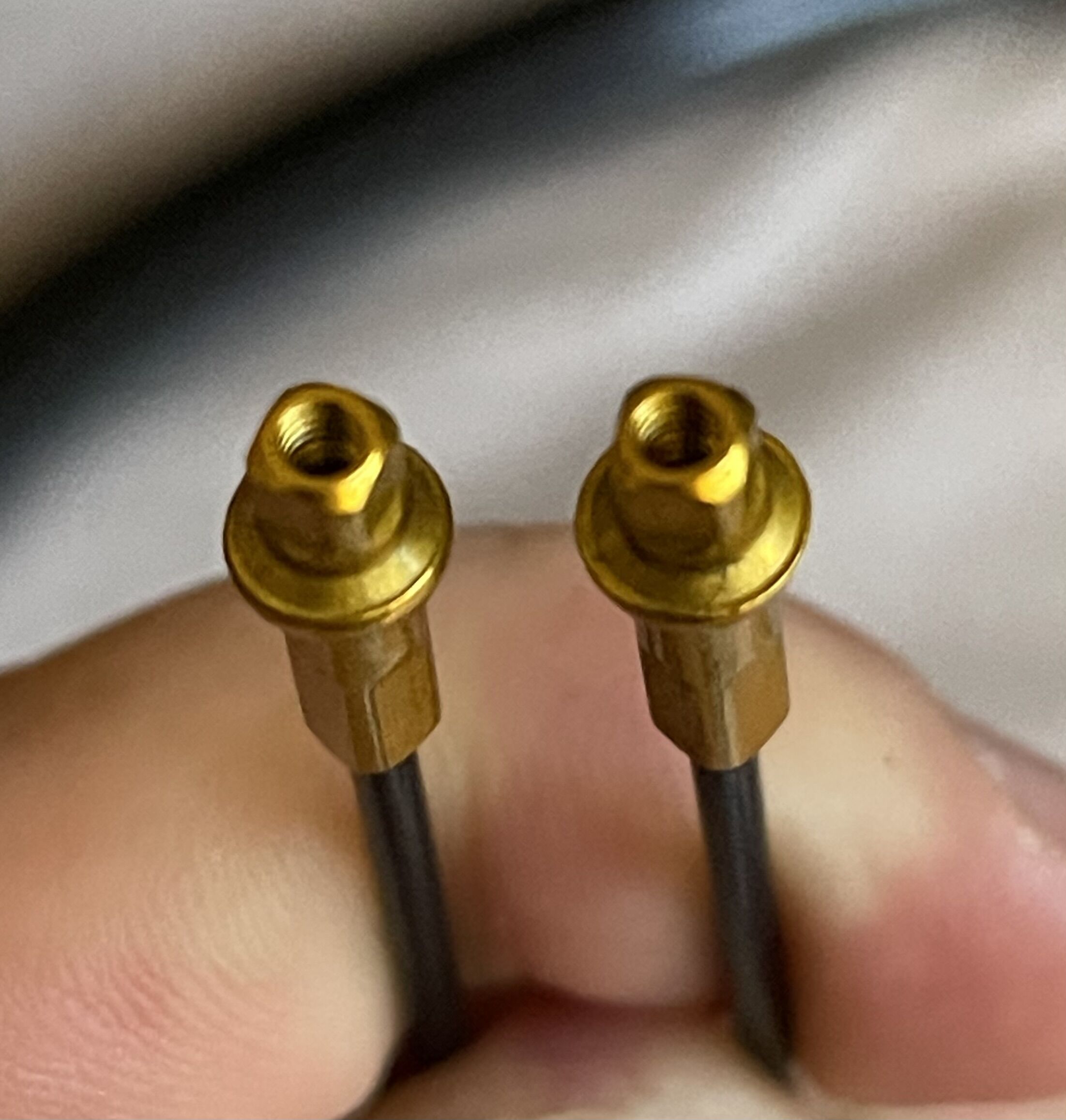

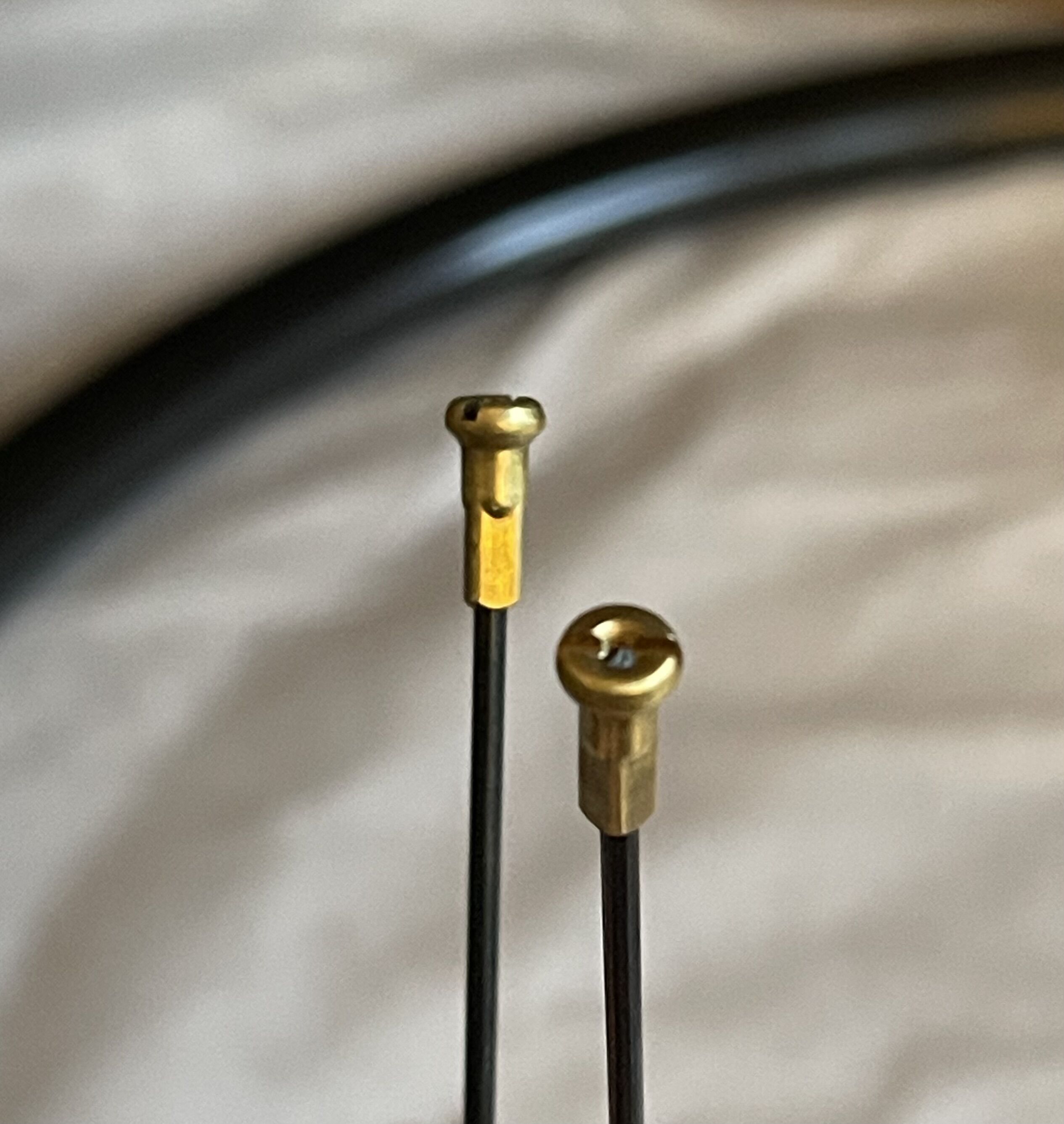

ERD updates - measured using ERD sticks we have some interesting results:
Sapim Double Square nipples: 763
SimWorks Brass Nipples: 759
Note these are professionally made and cut ERD sticks so I trust there settings - and the SimWorks nipple would in my view correspond directly to any standard nipple style or shape we’d have on classic 36” spokes. They’re nice but nothing different is design as far as I’m aware.
Double Square do require longer spokes as they have a deeper thread into the section beyond the seat of the nipple.
I am 99% sure that this means I can reuse my Nimbus 36” rim spokes from my current G36er build - which would be ace!
Using the Schlumpf125mm hub
—> ERD of 759:
I get spoke lengths of: 358.5/360.8 (359/361 rounded)
—> ERD of 763:
I get spoke lengths of: 360.2/362.8 (361/363 rounded up by closest 1mm)
This is using a calculator that factors in asymmetrical builds.
The spoke lengths of the current build using the Nimbus 36” rim are I believe: 360/362
I’ve checked this on UDC’s rim data which shows ERD 764.5 but the site calculator shows 762. (Bit odd right?)
Question:
Do we think that 360/362 lengths are too short to use when looking at the output for 763 ERD (this would be using DoubleSquare nipples?
Or would it be safer to use the standard nipples (reusing I know isn’t best but it hasn’t been ridden long) which would put my current spokes at over by 1mm each when going by the 759 output.
Penny pitching isn’t needed here really but I don’t really enjoy buying fully custom cut spokes for the sake of 1mm ish if I can help it.
I’d naturally prefer to find a way to use the DoubleSqaure nipples I got for this build - but want to be sure I’m not pushing the spoke length minimums here.
My gut says I should probably use the normal ones as I’ve have room to play with.

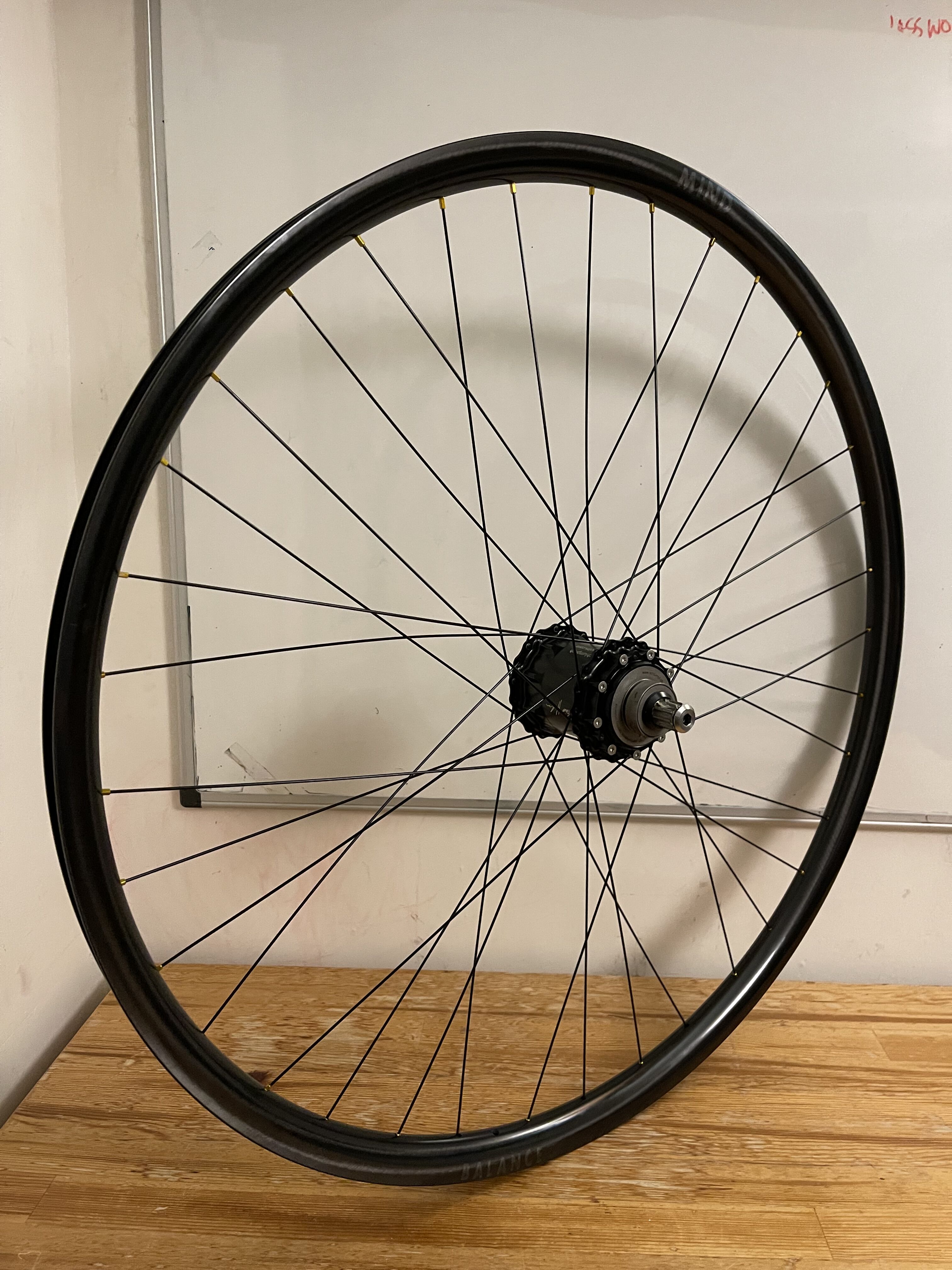

Progress - re laced it 2.5 times as I change my mind on pattern a few times …
Sadly recent urgent hospital visits are restricting my time to complete this fully.
I suspect I’ll get it true in a day or two :gear:
I’m sure you’ve seen it before. It’s the basic one - following Ryan’s approach.
I toyed with copying what Ali Clarkson advises re starting the first quarter of spokes on the “most important” side - that being the disc side (NDS) but changed my mind as most of my other wheels including ones from Ryan have the first sequence done on the NDS (non-disc side) first - this all leads to a difference in the twist one does with the hub and the way spokes trail or lead.
I did toy but decided not to follow Ryan’s step for Shimano lacing where the second quarter spokes perform the first “cross” and lock the pattern.
Might be good for bikes and front disc brakes. But for this wheel it is part rear and front wheel.
Yeah. Just the angle of the photo and the fact it is a bit baggy at the min.
Off to visit Ryan re other wheels - but hoping to pick up a square nipple driver which will be great :+1:
Photos of wheels always tend to look odd I find. Possible to figure out perhaps if a mistake was made but even looking at a lace in person issues can sometimes go unnoticed.
But I’m confident it’s right - in part due to the fact the rim as alternating spoke hole drilling angles and the asymmetrical nature of it making it very fixed as to where to put spokes.
Think we have a winner (don’t jinx it Felix!)
I’ve built the wheel and tensioned it up to true.
Rim: Unicus 36” from LightBicycle
Tyre: NightRider Lite
Tube: TPU
Tape: Two laps of Scotch tape (official brand)
Park Tool Numbers: DS 20, NDS (disc) 25-26
Install: it was very very very hard to get this tyre in the rim - even the first side needed a plastic lever.
The final edge again needed two plastic lever and it was a nightmare to have the TPU tube not get trapped under one edge section after I got the lip over and on. Managed to free it by holding tyre edge up a bit with tyre lever and pumping some air in.
Metal ones don’t use - don’t even like using plastic but the rim is tougher than you’d imagine.
It is now neatly seated and holding 55ish PSI.
Spokes have gone floppy so I’ll have to add tension
I got to that level as that’s where I’d max my needs - and then I ran away from the wheel after stowing it in the summer house in the garden.
I’m not really worried about this rim but if it is going to blow off it’ll happy I think within the first few hours after install or directly after pumping.
So - yes I think this is going to be reliable as much or more so than the Braus rim - but of course this could be in part thanks to the TPU tube.
I do think that when a rim is very tight to get the tyre on - and one that is supposed to be a loose fit - we are where we need to be.
It’s even all the way around and the hook plus rim dimensions all speak of this being THE rim we always wanted. Just wear a T-shirt, stretch your thumbs and hands and be ready to muscle a tyre on with the use of plastic tyre levers.
I’ll get a photo when I trust it won’t make a bang!
