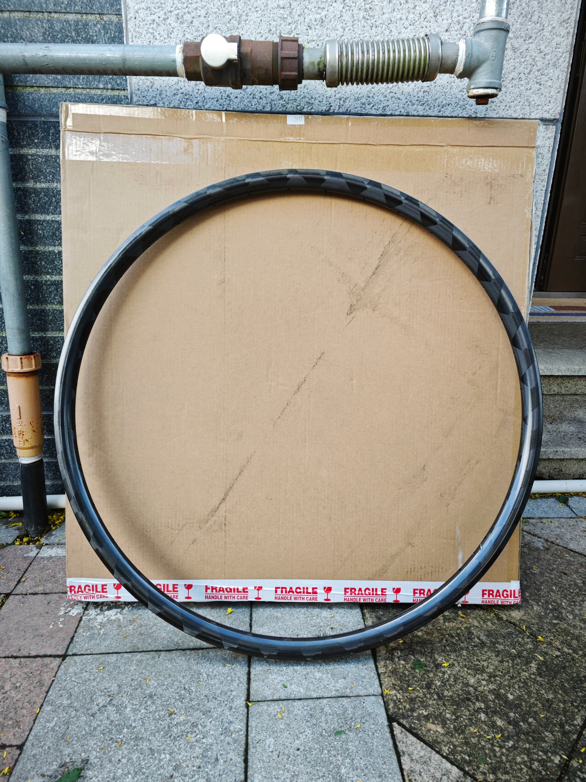

Just got my rim from Light Bicycle - it looks gorgeous! I’ve chosen the Braided UD pattern just for the look, with it being ~50g heavier as one of the tradeoffs (another one is more expensive).
Still waiting for the spokes to get it laced up. Updates later!
