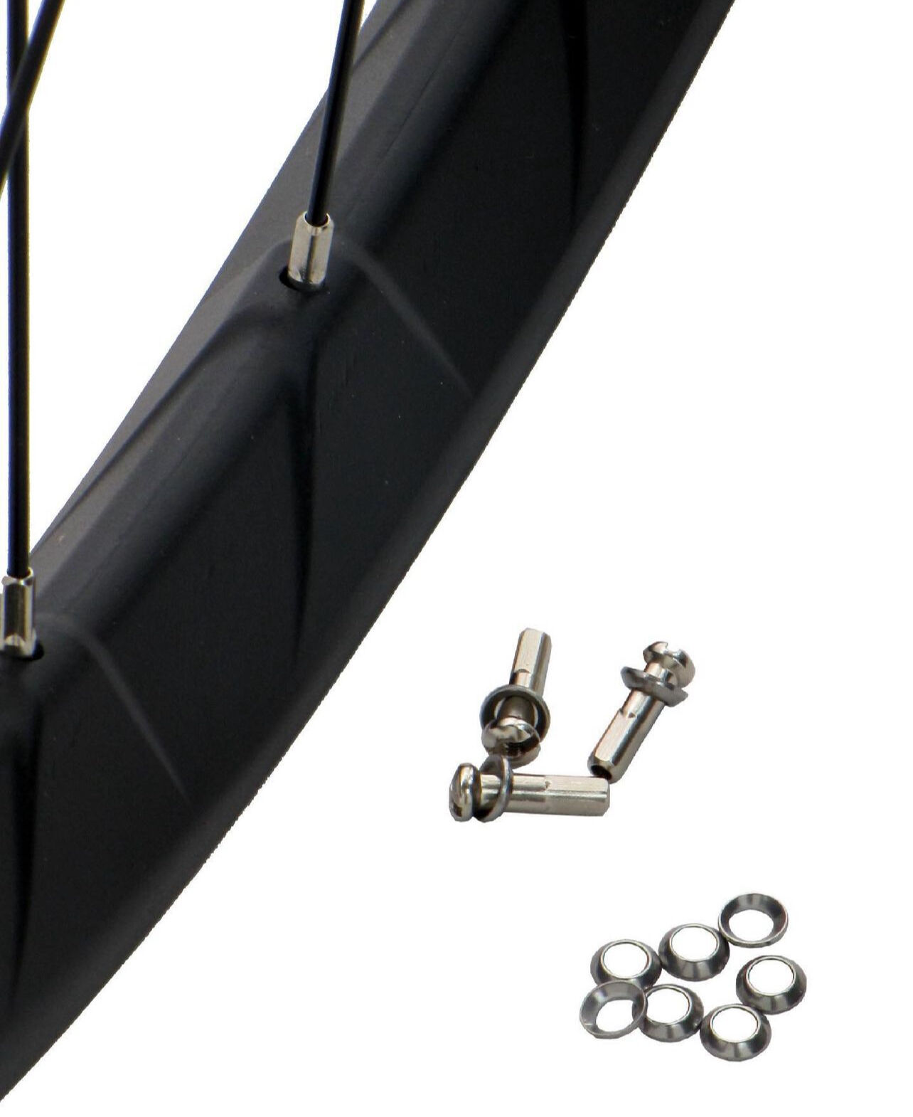

Going back to a question about people’s Braus rims.
Have people here built with this spoke head washers or no?
:thinking:
No washer for me

I really like my Braus rim but I learned it should have been built with spoke washers behind nipples and the spoke tension ratios on a 100mm are 100%/45% - whereas with this 36hole 36" rim on my 125mm hub I’ll get 100%/63%

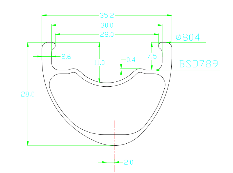

  1. Its asymmetrical design will be great for inboard disc hubs
  2. It is a 28i/30i rim - narrower than the Nextie and more in line with the Braus
  3. They’ve tweaked the BSD from the spec of 787 to 789 which means it will likely hold on to tyres that are slightly too flexy in their bead
  4. Its their Pro line rim mold and layer up
  5. They offer custom hub hole drilling angles
  6. It has a hook
  7. They actively listened to unicyclists and this rim will be highlighted as a unicyclist’s rim (I think)

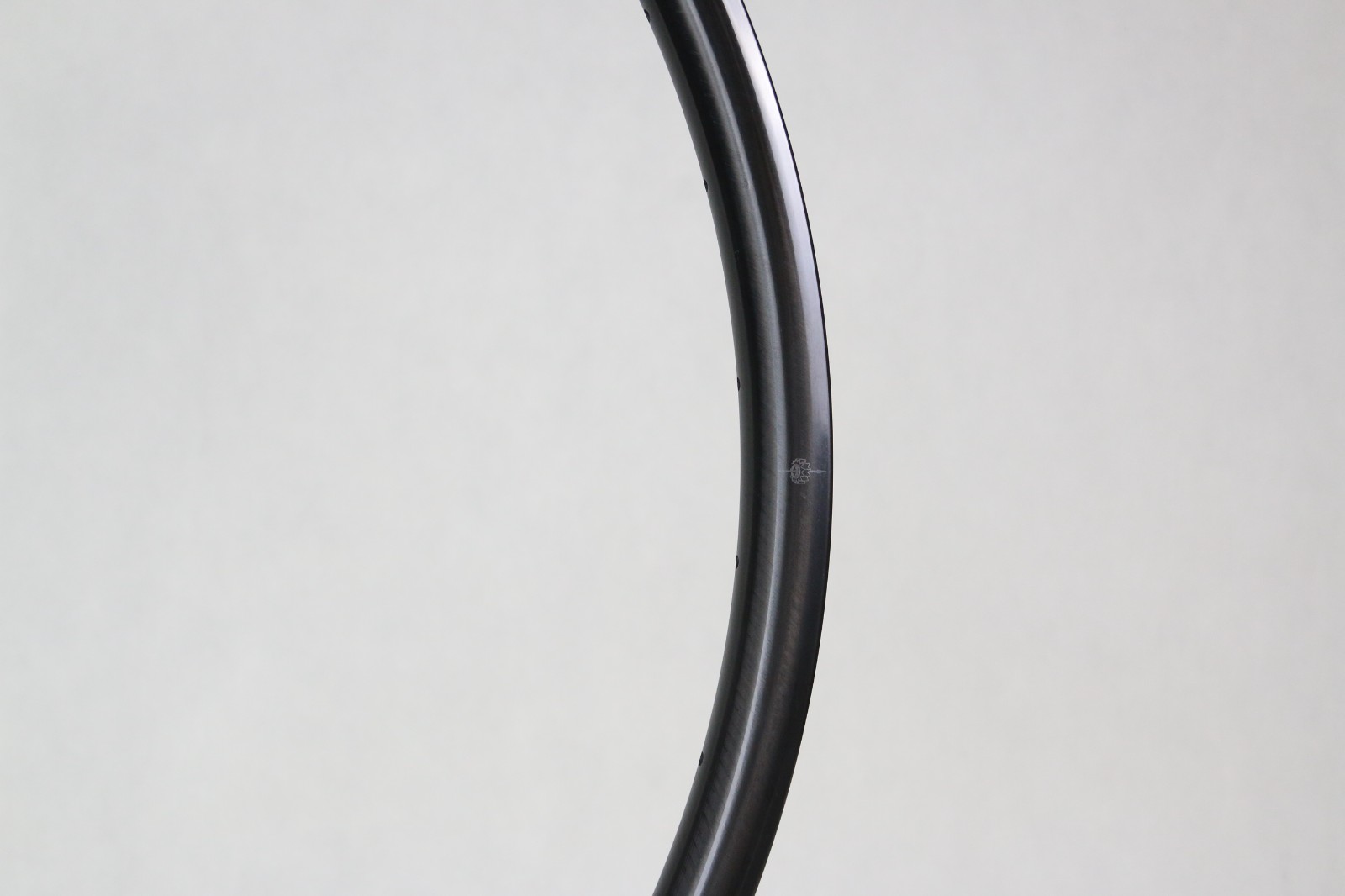

Look at that design again… tasty! :drooling_face:
FYI its ERD is 755 (which I will confirm when I get with ERD sticks and Sapim Double Square nipples!)

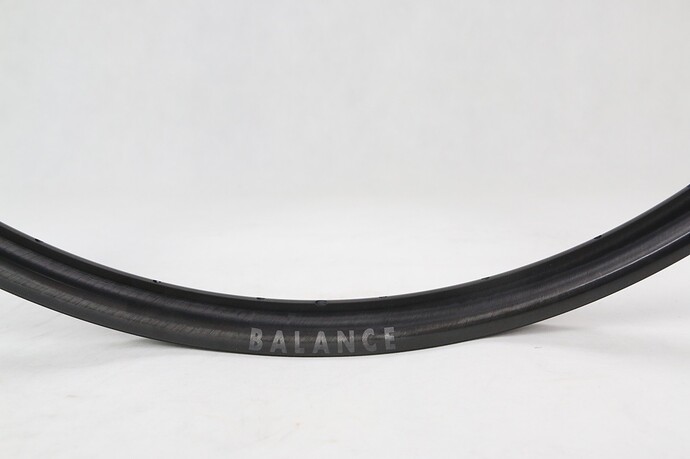

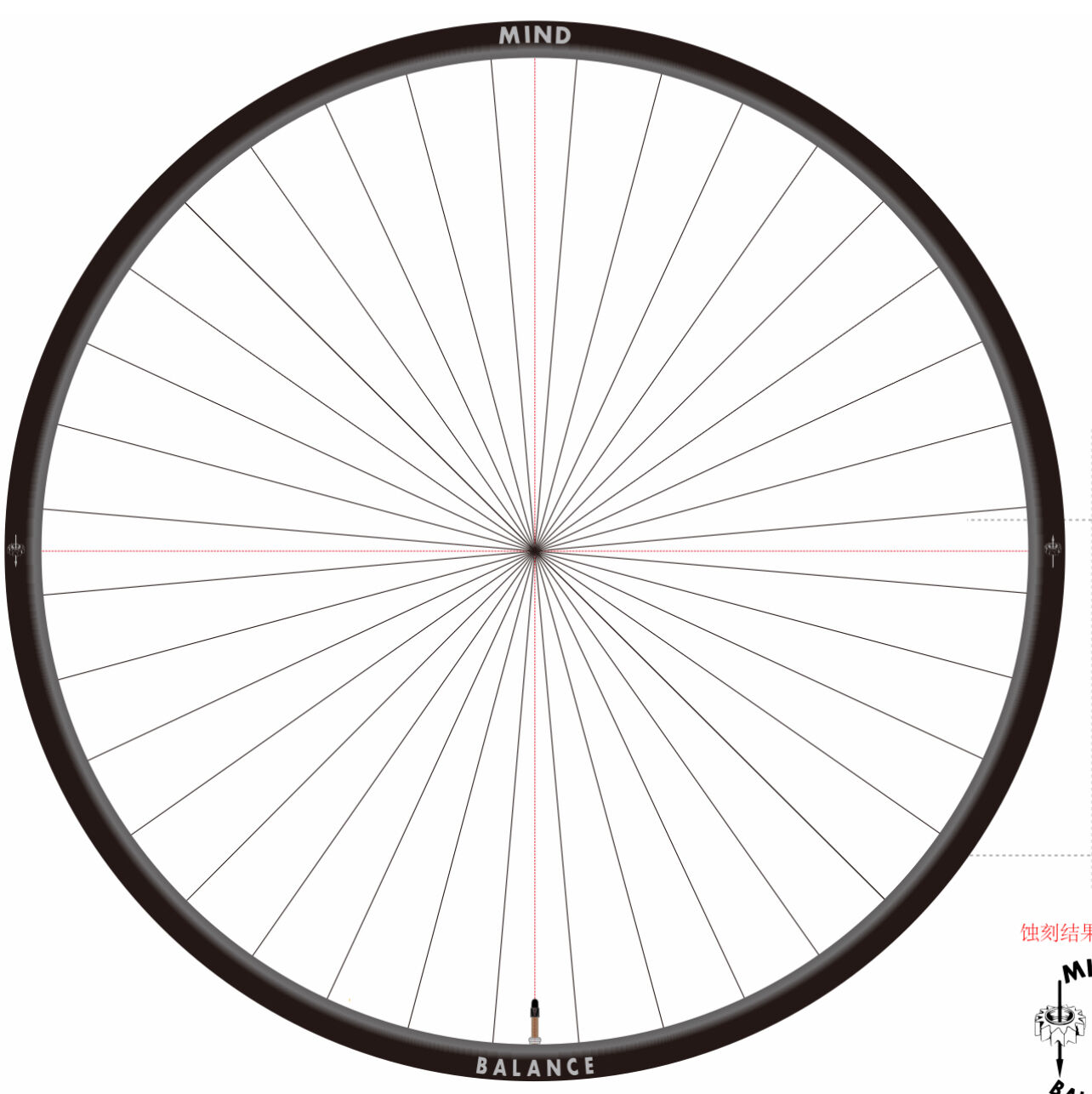

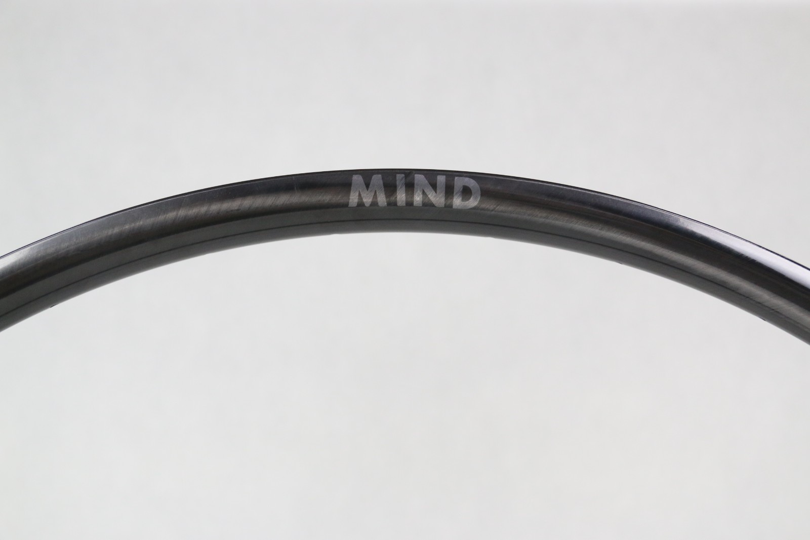

Laser engraving design is spot on and they did it off a basic photo I sent of what I wanted :star_struck:

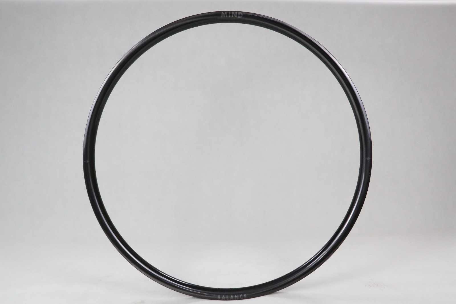

Here it is :star_struck::gear:
And I have been advised the rim held tyres on for 24hours - no blow offs at 65psi.
