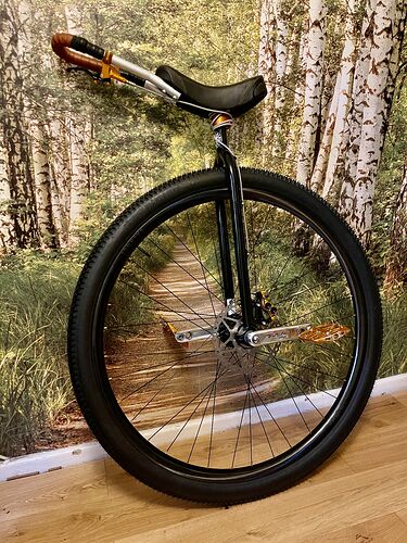

Nimbus Oracle G36 Carbon” - Updated to LB Unicus Rim
- Frame: Nimbus Oracle 36” Disc
- Hub: Schlumpf 2022 Disc 125mm M1424 36h (Fixed Drive)
- Rim: LightBicycle Flacon Pro Unicus-36
- Spokes: 14g (Black) 360mm/362mm - [with Sapim washers on spoke heads non-disc side]
- Nipples: Sapim Double Square 16mm (Gold)
- Brake: Hope Tech3 E4 (Orange)
- Brake Mount: Hope B (Black
- Rotor: 203
- Tyre: Nightrider Lite
- Inner Tube: 36pollici TPU Presta
- Saddle: Qu-Ax Eleven + Ursli Bar (Long)
- Seatpost: UDC Steel 25.4
- Clamp: Mad4One 2-Bolt (Orange)
- Cranks: Kris Holm Moments 125/150
- Pedals: Hope F20 Pedals (Orange)
Updated G36er to carbon rim as discussed in this thread:
Main takeaway is that this is a magical asymmetrical rim that can be custom drilled to match the hub flange spacer and hole count - and so far fits tyres well with this one holding 50ish PSI flawlessly. It also seems to require less pressure then I’ve experienced on other rim set ups - meaning the rim and tyre at 45ish seem as firm as other rides when at 50PSI.
In short a brilliant upgrade for the 125mm hubs ![]()
