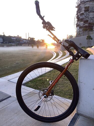

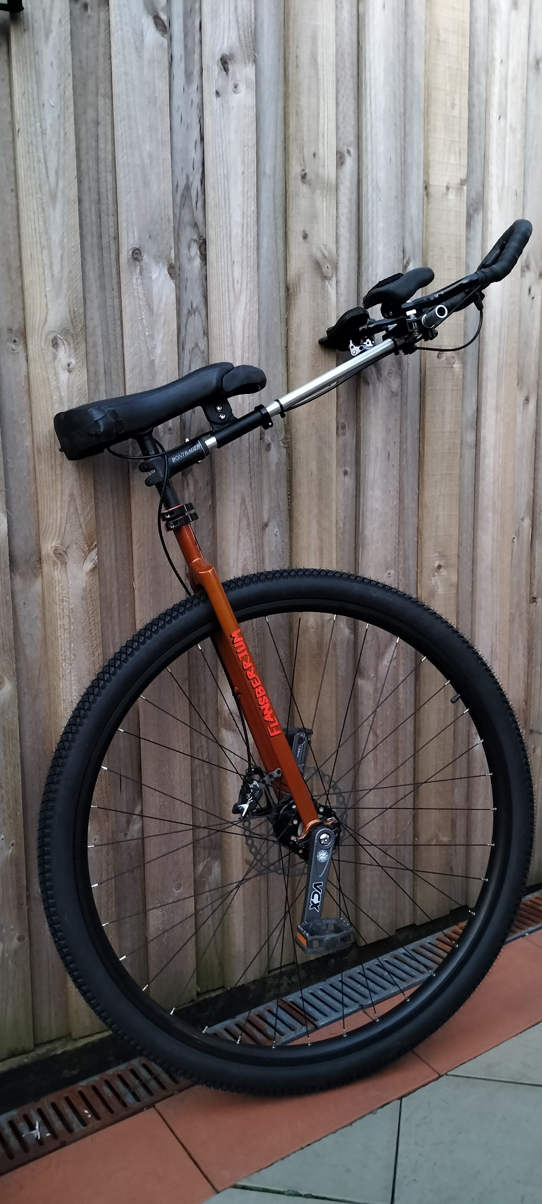

Flansberrium G36
  • Frame: Flansberrium 4130 Steel 125mm tapered from Crown to hubs
  • Hub: Schlumpf 2022/23 Disc 125mm (Fixed Drive)
  • Rim: Nimbus Dominator 2
  • Spokes: 14g (Black) - [with 13g washers on spoke heads non-disc side] 360mm/362mm
  • Nipples: Brass (Silver)
  • Brake - Primary: Shimano XT (BR-M8120) c/w1700mm hose (rear left)
  • Brake - Secondary: Shimano GRX BL-RX812-L
  • Brake Caliper Mount: PM to IS 203 Front
  • Rotor: 203 Schlumpf
  • Tyre: Nimbus Nightrider lite 36”
  • Inner Tube: Unicycle.com 36"
  • Saddle: Kris Holm Fusion one
  • Bar: Flansberrium custom Aluminium T-Bar 520x200 reinforced with Stainless tube OD 16mm
  • T-Bar seat mount: KH TBar touring
  • T-Bar Seat post mount: ex.Bontrager Handlebar stem
  • Aero Bar: Alloy Triathlon Aero Road Mountain
  • Seatpost: KH 27.2
  • Clamp: Nimbus 31.8mm Oracle seat clamp (Red)
  • Cranks: Nimbus VCX ISIS 138mm
  • Crank installing Axle Bolt: Crank Spindle Bolt 22mm (M14 Thread) from localbmx.com.au
  • Pedals: from kids 20" bike (worth a try)

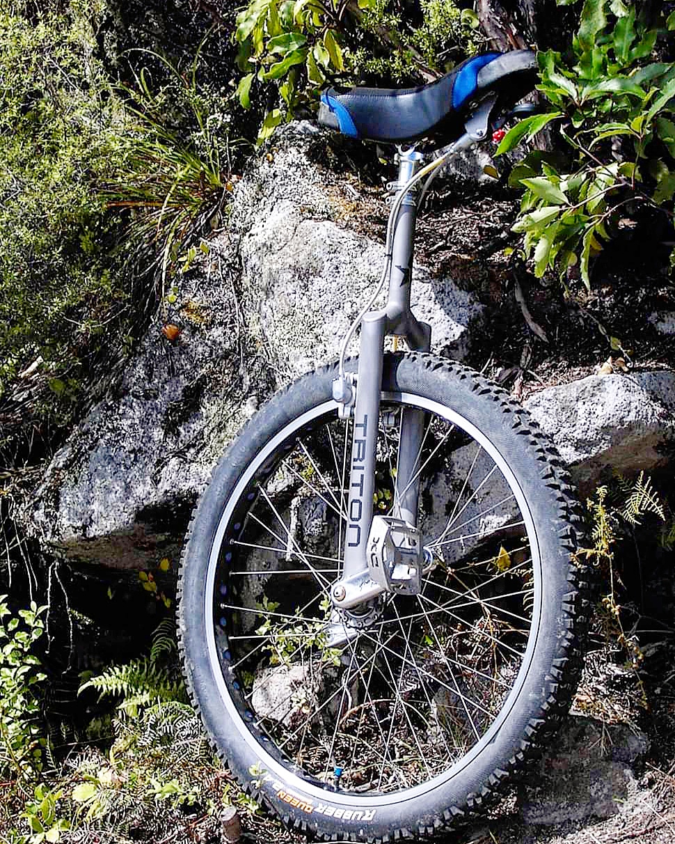

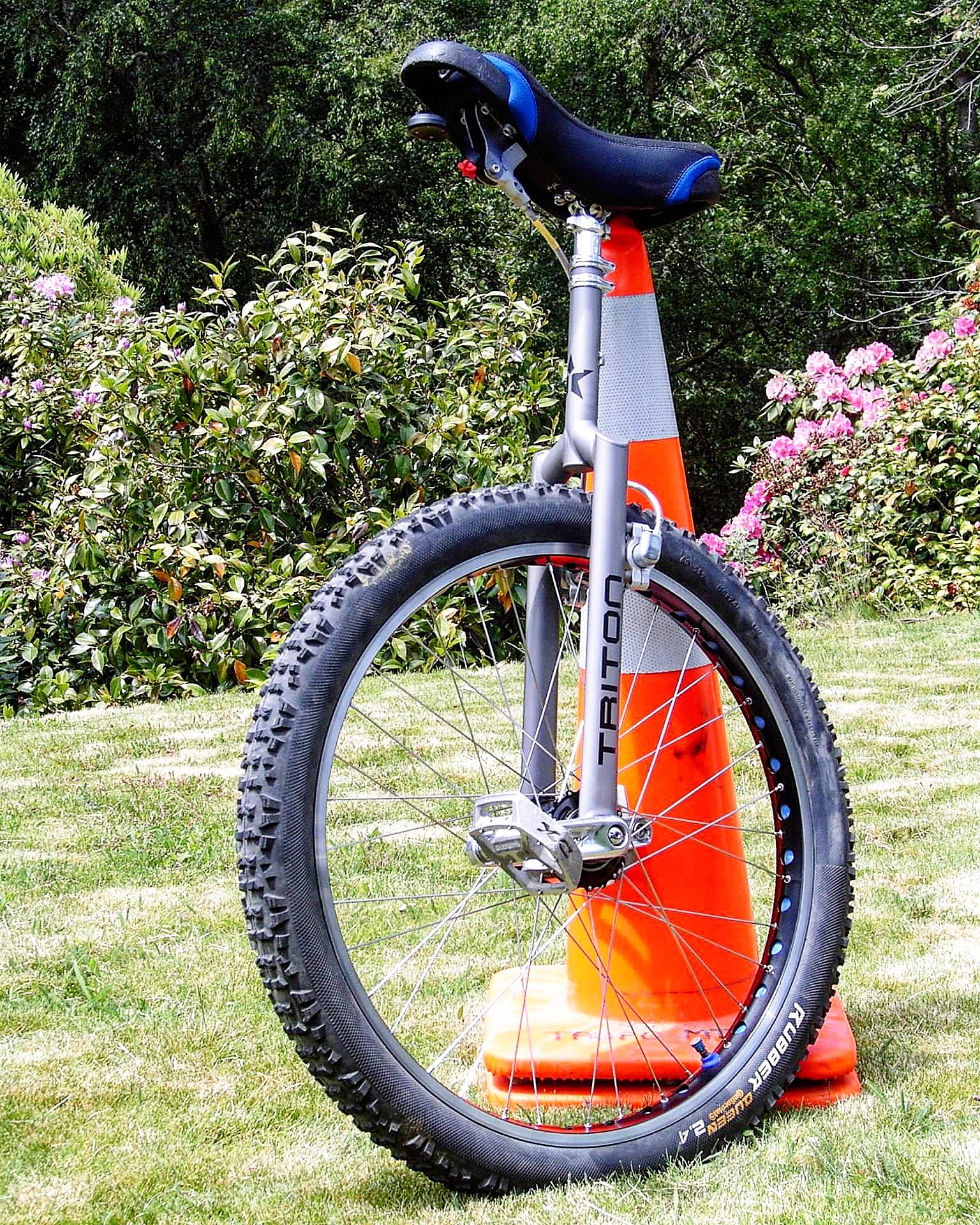

Here is my old Ti 26” Guni that I sold to Ken Looi in late 2011 to help fund my Africa misadventure.
Ok, I could give a review of the brakes.
First off, it took 3 goes (over 3 days) to bleed the brake line with 2 brake levers.
Also my review is probably going to be
“amazing brakes!” after only ever having had stock brakes that came with KH29 and KH36.
I hope to get on the “thing” tomorrow. My wife has a mountain of chores wanting for me, having seen me spend so many weekends building the Unicycle.. haha..boohoo

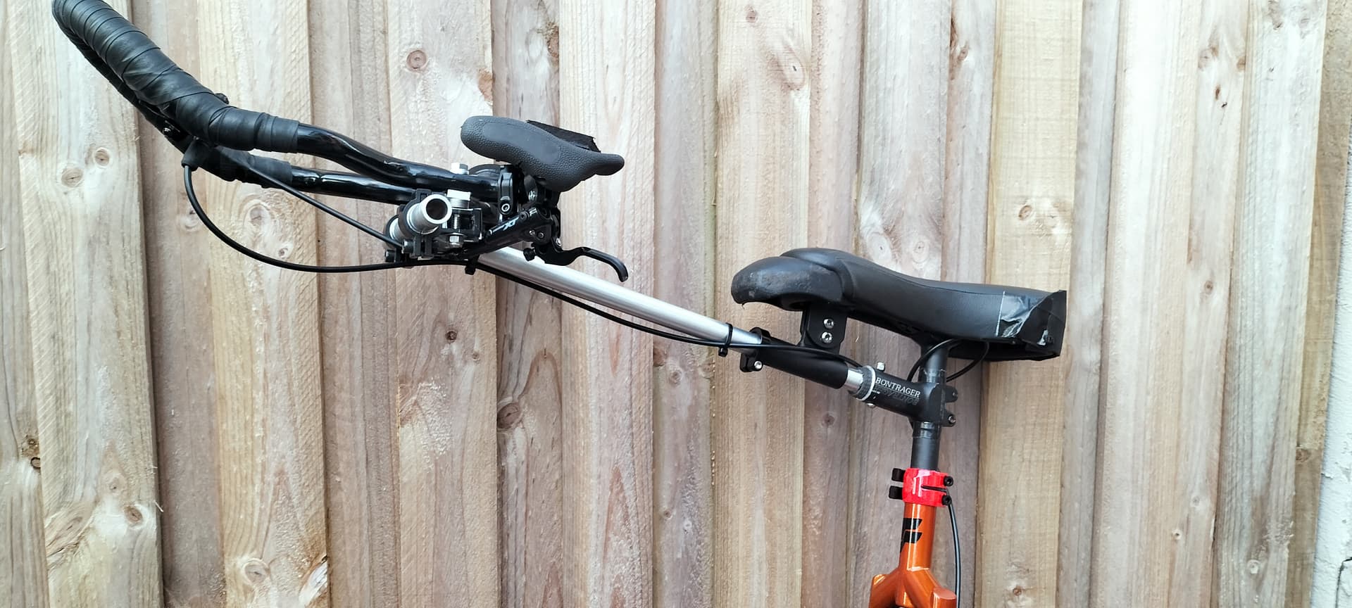

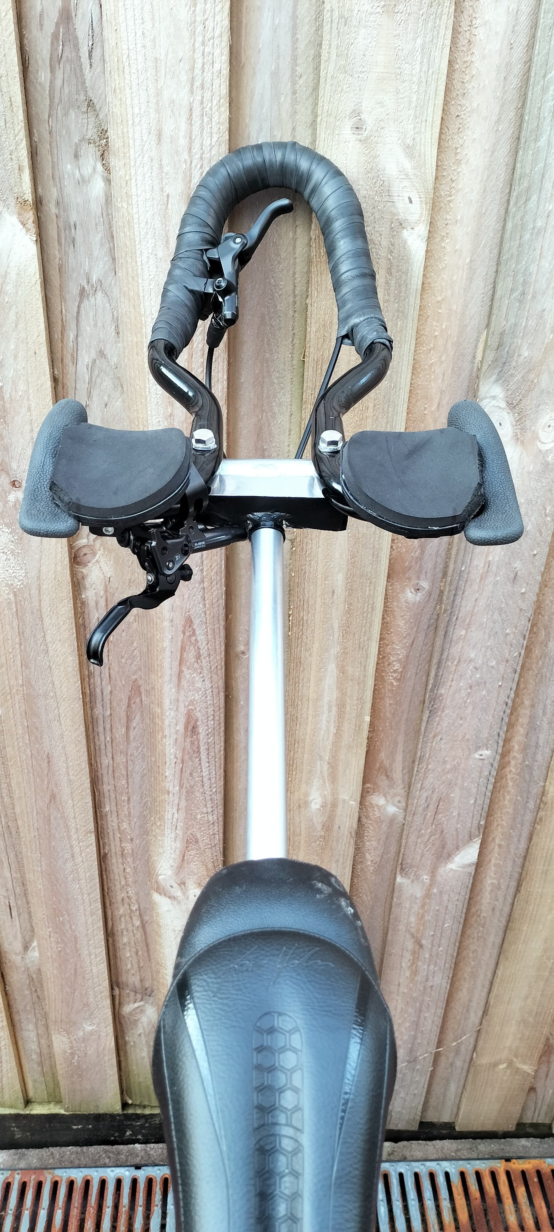

Impressions so far of dual brake levers on G36 and KH36.
First try of G36, I now realise the high gear with 138mm cranks requires alot of torque. No way I could start in high gear. I have not ridden in high gear yet.
I took the seat/aerobar/dual lever brake setup and put on my KH36 and am trying it out commuting to work.
Found I had to bleed the brakes a 4th time after the switch over.
To bleed the brakes, I need to disassemble levers and straighten out the line with main brake at high point (practically above head height)
It is really nice to have the small brake lever at the end of the aerobars - it has a nice “gentle” application of braking without grabbing.
I am thinking the dual lever brake reduces the effective brake force and may not be powerful enough for the G36.
I might look at another brake setup for the G36.
Thanks for your insight!
Are you sure everything is sealed correctly? You may have a leak somewhere :thinking:
That’s not great :frowning:

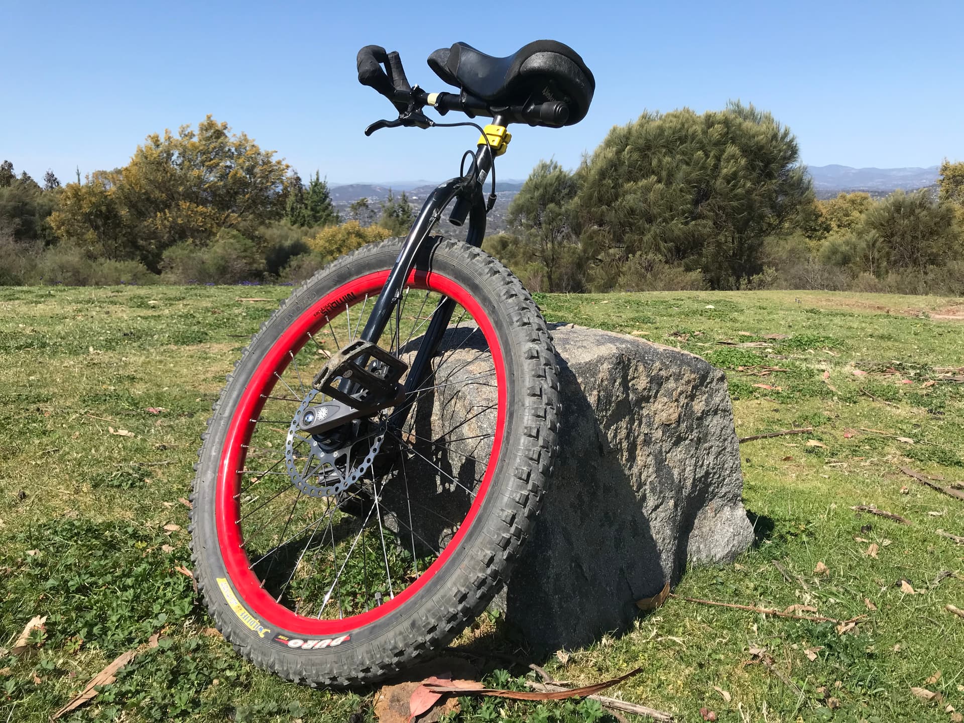

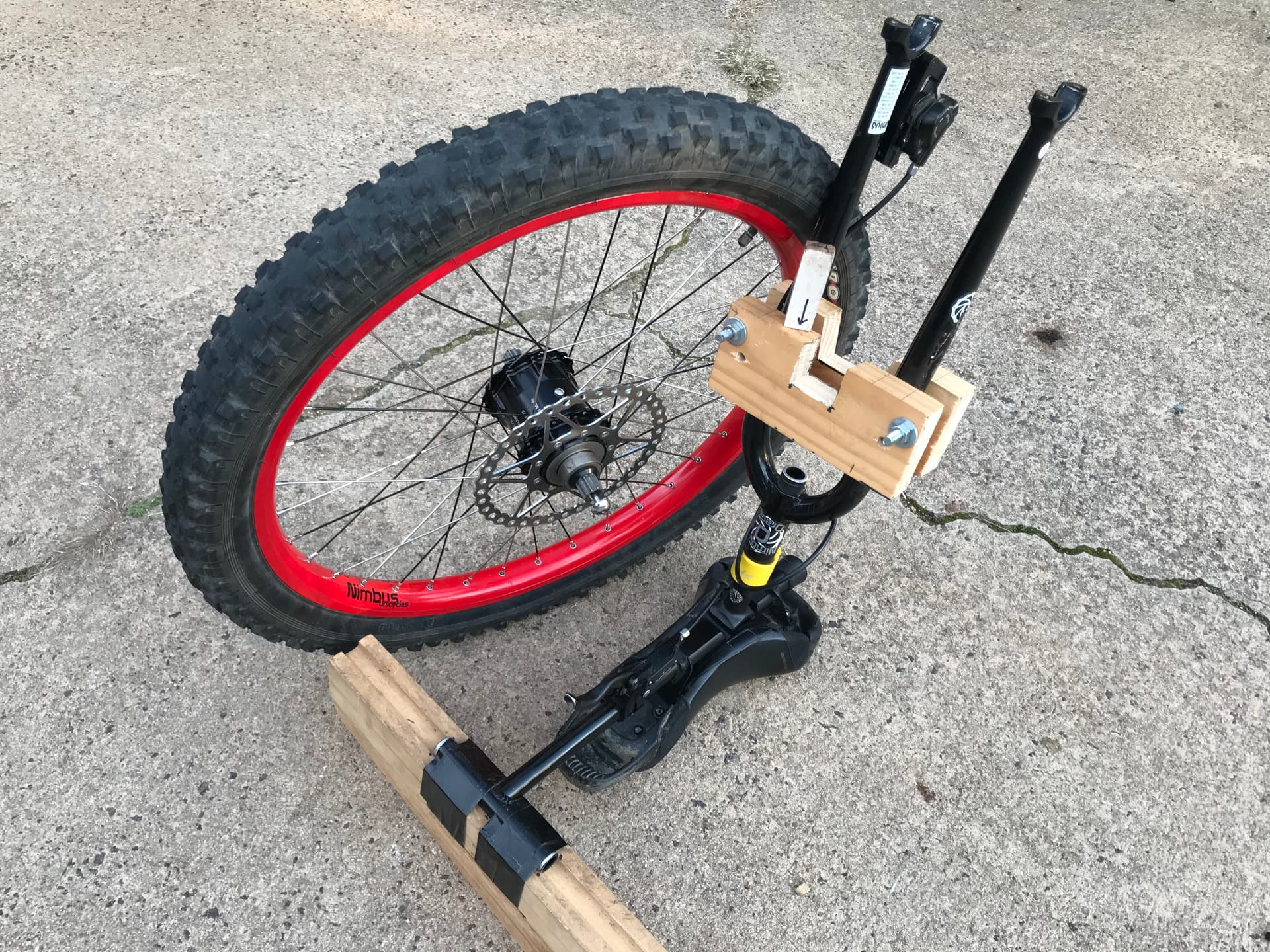

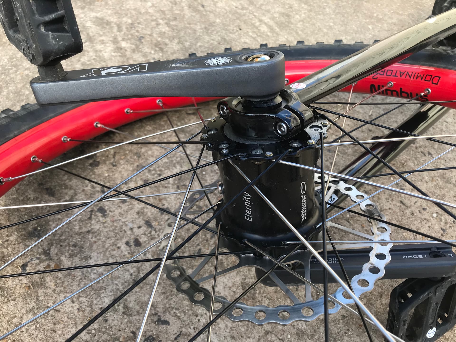

I’ve had my Schlumpf built since August 2023, and have been meaning to post an update for a while, so here’s 3 pics (hub with homemade truing stand, close up of wheel, whole g26 as ridden):
G26 DETAILS:
hub: Schlumpf M1429, inscription “Eternity”;
frame: repurposed from a Nimbus Oracle 32 (125mm axle);
seat: KH Freeride;
clamp: KH double bolt;
handle: Nimbus Shadow straight, cut short;
bar ends: zoom fat boy (ends cut to fit, wrapped in hockey tape);
wheel: Dominator 2 with 26*3.0 tire repurposed from a Nimbus Oracle 26;
rotor: 203mm Schlumpf disc rotor;
caliper: Shimano BR-M447 (with new resin pads);
caliper adapter: Shimano SM-MA-F203P/SA;
cranks: Nimbus VCX ISIS 150mm;
pedals: Nimbus plastic (not studded);
total weight: 9kg.
BUILD NOTES:
spoking: the spoke heads were fitted the “standard” way, against the flat side of the flange (i.e., not in the recessed part of the hole). All “head inside” spokes had a slightly longer J section. The 9 “head out” spokes on the non-disc side used a brass washer against the head. The cranks were tightened using a well-fitting T handle hex tool - I was very careful to push down firmly while tightening and so avoided any damage to the Schlumpf axle bolt. The brake rotor was put on the hub using a single (Schlumpf provided) set of spacers. Minor filing was done to the caliper/adapter.
No real issues after the build - I re-tightened the bearings and cranks early on and no problems since then.
RIDING:
I’m just your average rider (now in my 75th year on the planet), and I decided I would always stop to change gears. This meant I could happily ride with size EU 42 sandshoes and my foot arch (not ball) on the pedal, as is my habit, while using zero-Q 150mm cranks without worrying about accidental shifts.
Learning didn’t take too long. For a very short while it reminded me a little of learning to ride my first unicycle. The hardest part was after getting used to high gear riding, then restarting in low gear felt very weird. I use a standard static free mount, with just a little push before placing my rear foot - this means I get my front foot on in a good way to balance and push in a high gear start, and I am less likely to accidentally put too much weight on the back pedal when starting in low gear.
Braking downhill is surprisingly easy just using leg power - more force is needed, but the slower rotation speed makes it easier to control. I am trying to minimize use of the disc brake (because of forum comments about premature wear, and just to get more leg control practice in). So, I haven’t had much wear on the pads and rotor.
I didn’t have many falls while learning, BUT I have discovered that the way to do a “superman” fall is to become confident, ride fast on a dirt track, come to a hill and accelerate hard to make sure to get up the hill in high gear, get a minor road irregularity with the pedal in the dead position, discover that there is no more torque possible in the balance envelope, and… superman!
Anyway, very expensive, but plenty of fun learning. And it really does feel nice when riding with a bit of speed on a smooth cycle path in high gear. And it fits easily into the boot of my little car.

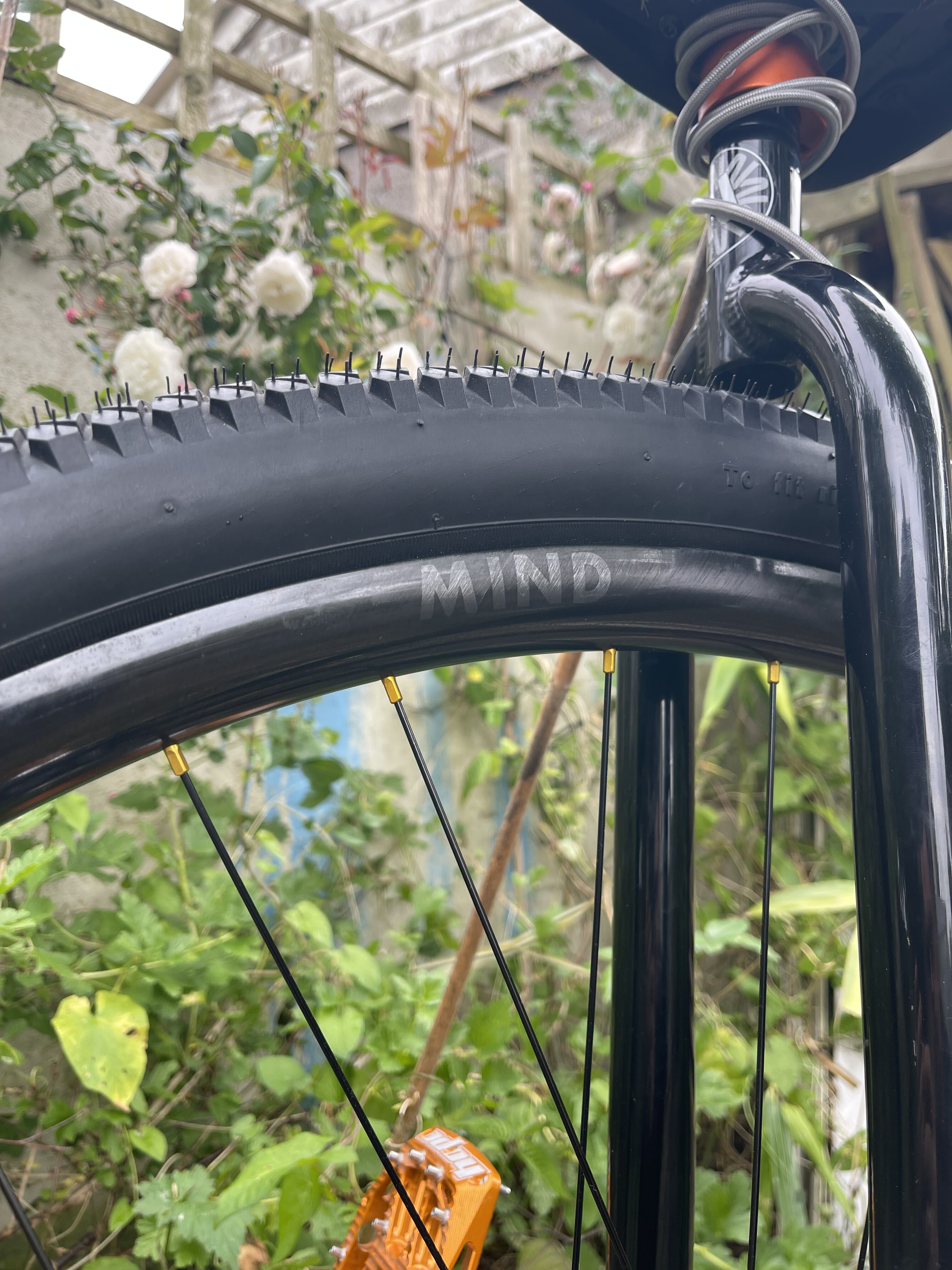

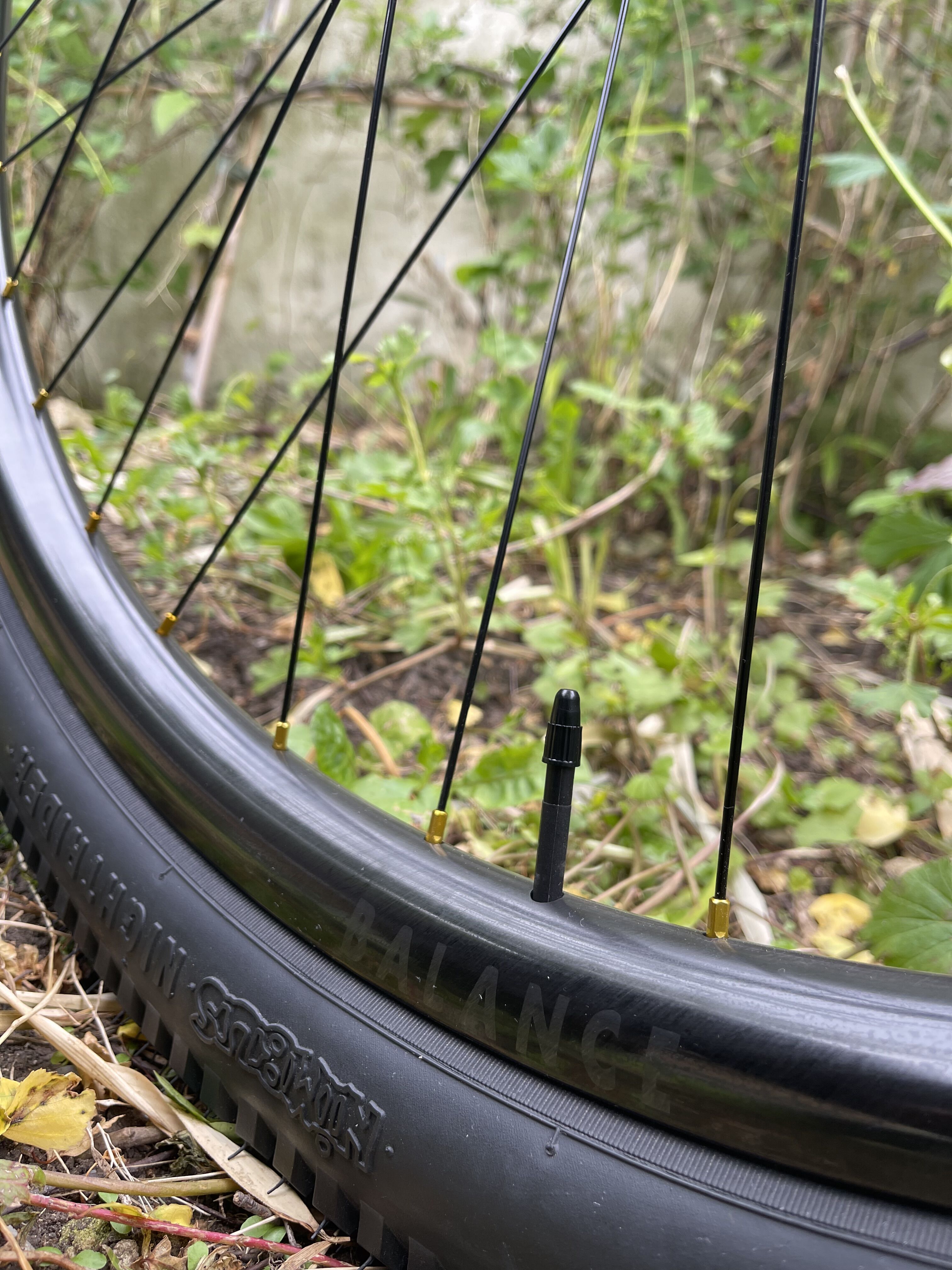

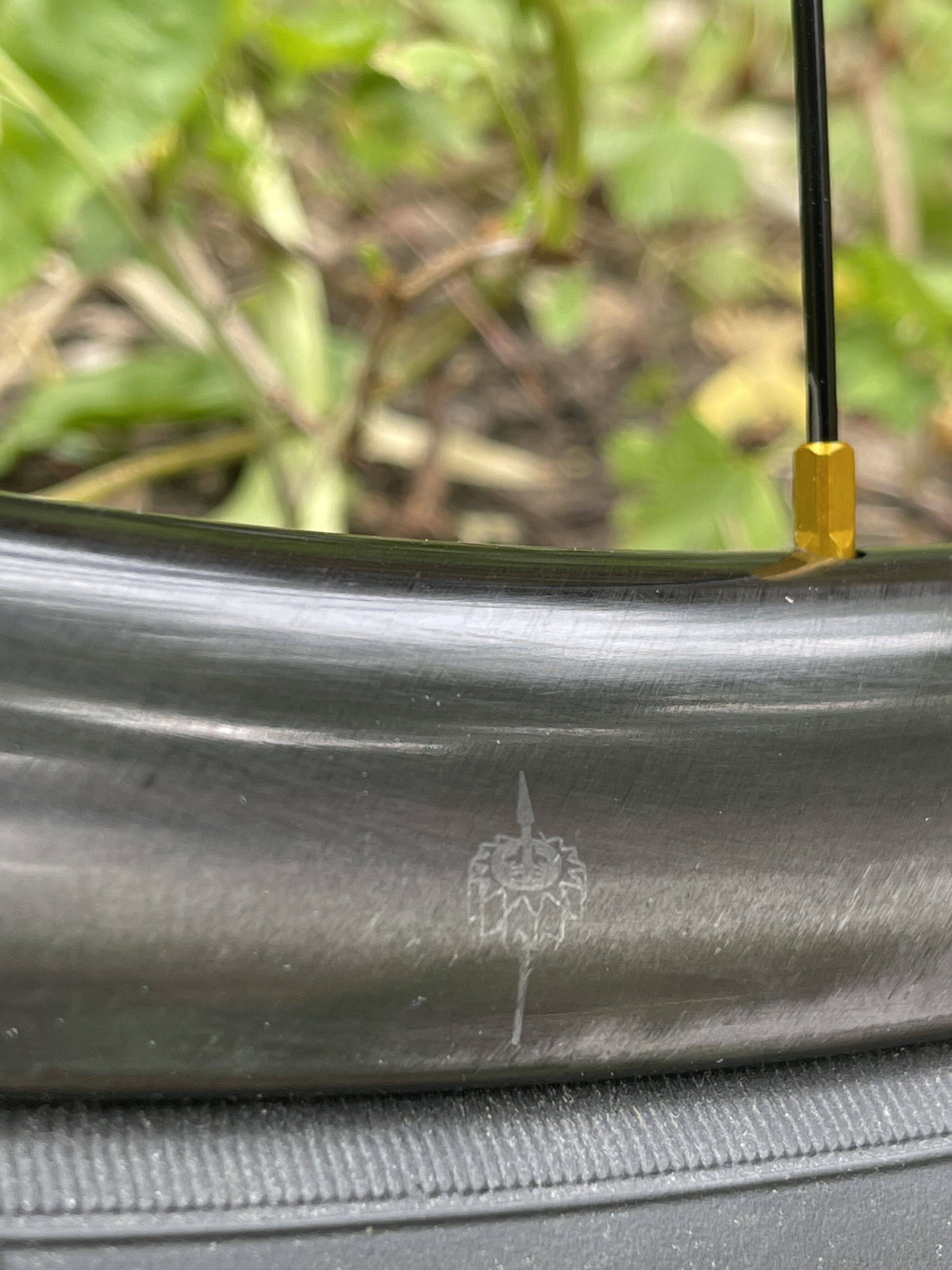

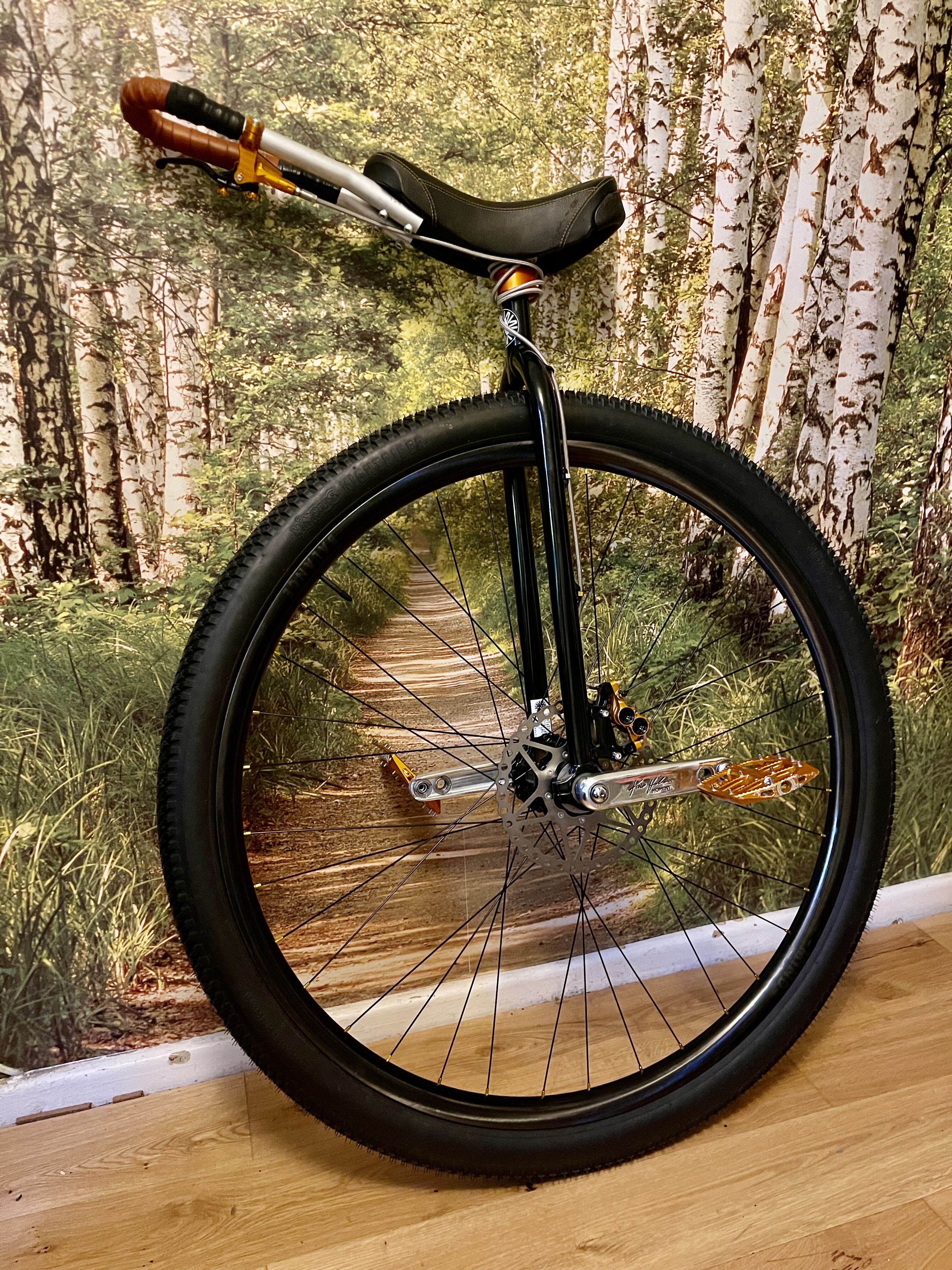

Nimbus Oracle G36 Carbon” - Updated to LB Unicus Rim
  • Frame: Nimbus Oracle 36” Disc
  • Hub: Schlumpf 2022 Disc 125mm M1424 36h (Fixed Drive)
  • Rim: LightBicycle Flacon Pro Unicus-36
  • Spokes: 14g (Black) 360mm/362mm - [with Sapim washers on spoke heads non-disc side]
  • Nipples: Sapim Double Square 16mm (Gold)
  • Brake: Hope Tech3 E4 (Orange)
  • Brake Mount: Hope B (Black
  • Rotor: 203
  • Tyre: Nightrider Lite
  • Inner Tube: 36pollici TPU Presta
  • Saddle: Qu-Ax Eleven + Ursli Bar (Long)
  • Seatpost: UDC Steel 25.4
  • Clamp: Mad4One 2-Bolt (Orange)
  • Cranks: Kris Holm Moments 125/150
  • Pedals: Hope F20 Pedals (Orange)
Updated G36er to carbon rim as discussed in this thread:
Main takeaway is that this is a magical asymmetrical rim that can be custom drilled to match the hub flange spacer and hole count - and so far fits tyres well with this one holding 50ish PSI flawlessly. It also seems to require less pressure then I’ve experienced on other rim set ups - meaning the rim and tyre at 45ish seem as firm as other rides when at 50PSI.
In short a brilliant upgrade for the 125mm hubs :gear::star_struck::tada:

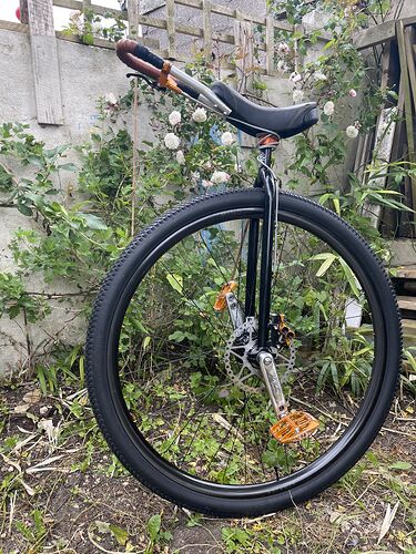

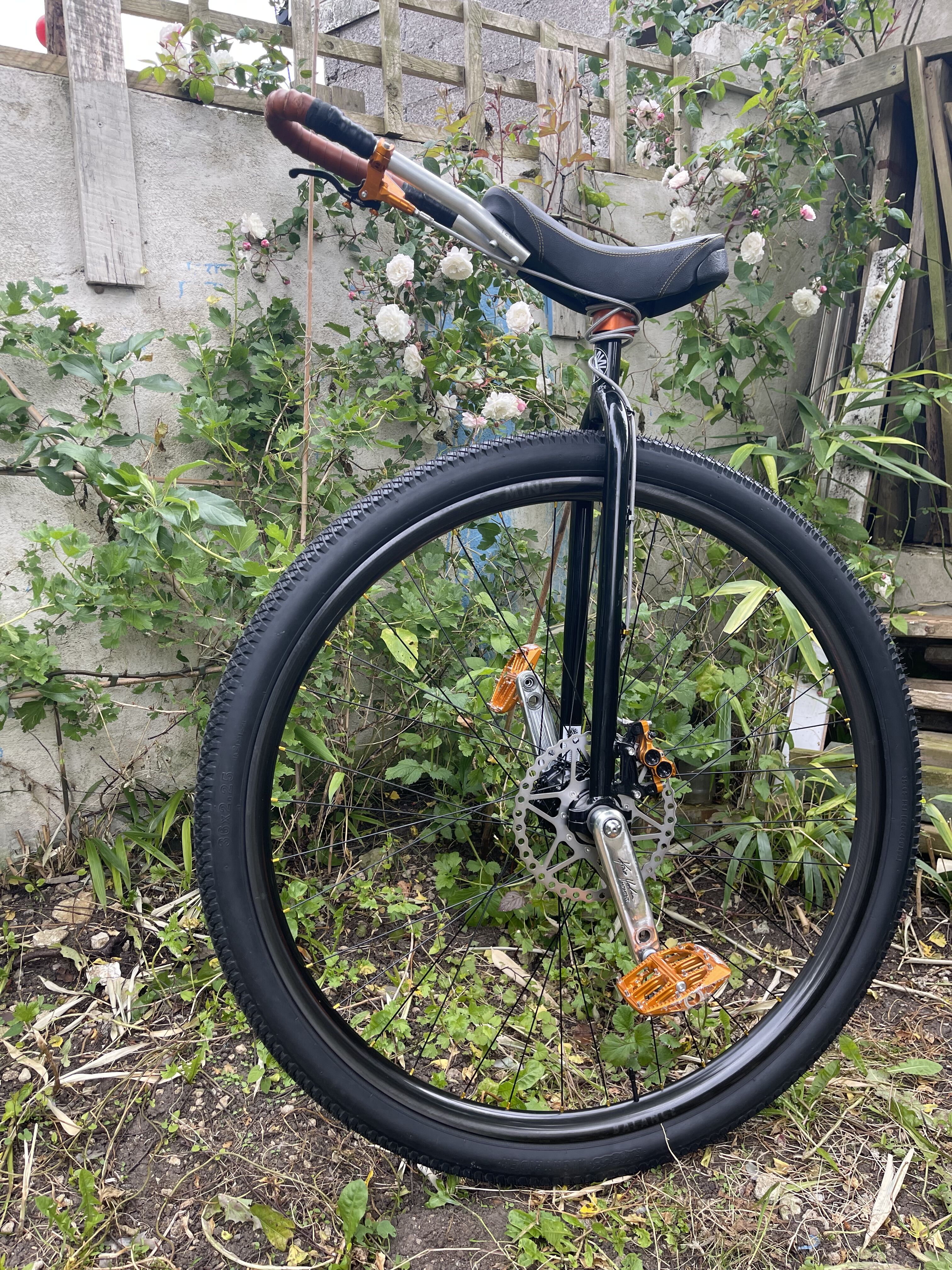

Few extra shots outside - inc close ups!

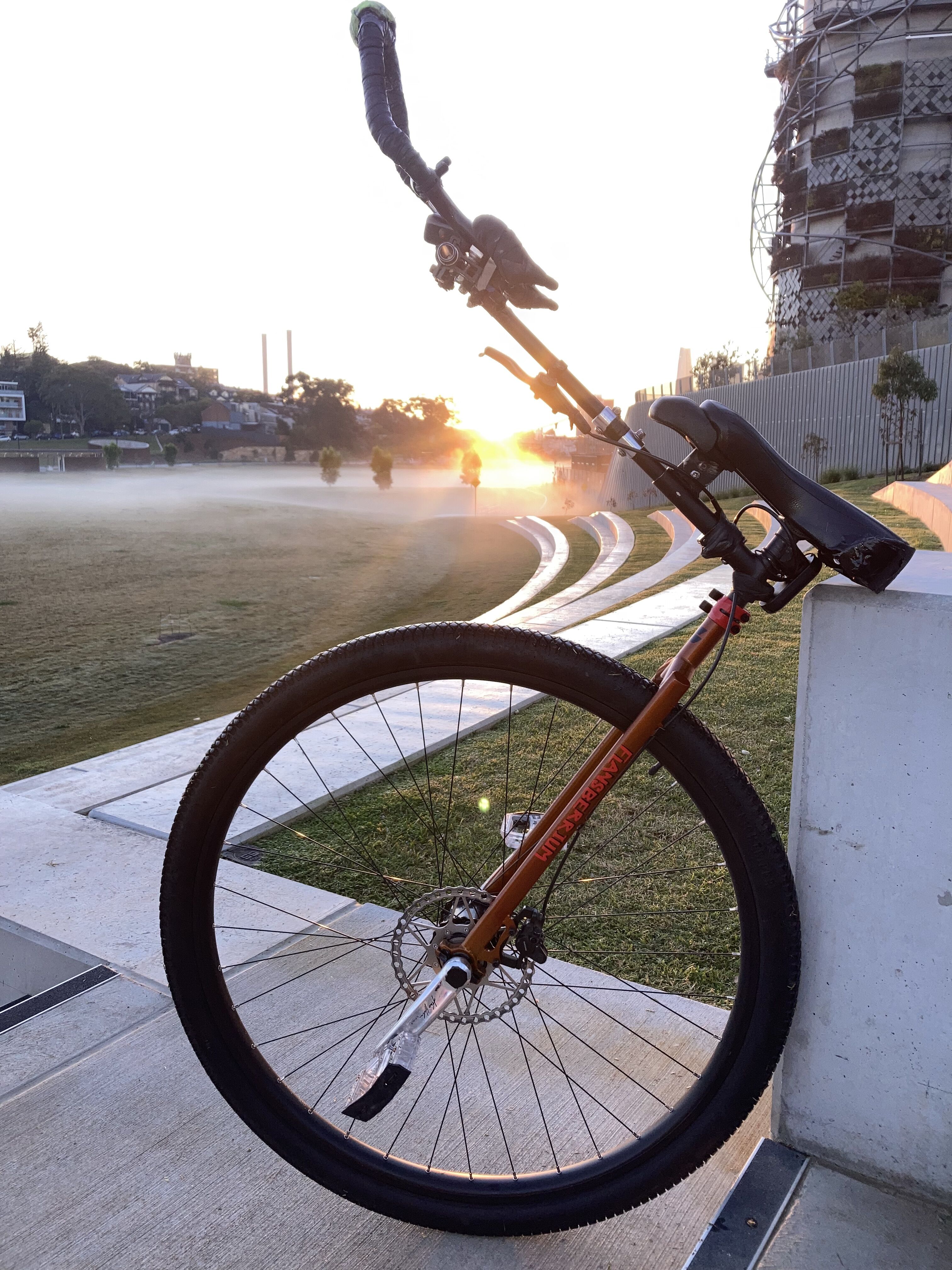

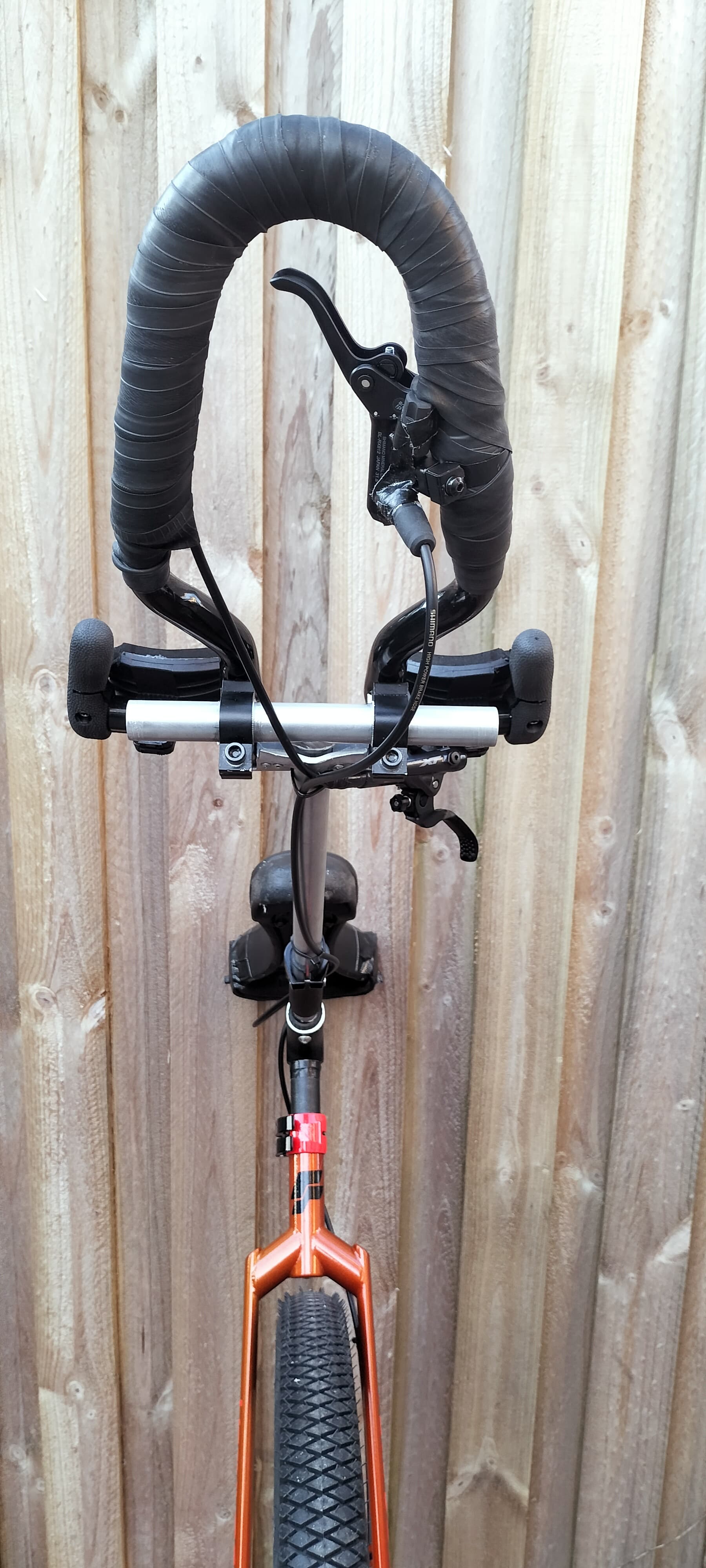

It’s been 11 months since my last posted pictures of my G36 Flansberrium Schlumpf 2022 125mm hub.
It is now going in to service - low gear only, pre learning curve. As my commuter. It will also give me regular practice opportunity with High gear.
The Flansberrium frame is in 4130 Cro-moly Steel.
After 2 1/2 years and 7300km, my KH36 frame has accumulated enough “battle” wounds including a crack in the stem. I had a seat clamp installed 180 deg rotated that didn’t help.
Recently I had a bearing inner race split that caused the left frame leg to wobble sideways, causing a crack just below the crown welds.
I transferred the Aerobar-seat assembly from KH uni to Flansberrium Schlumpf, having become so accustomed to the geometry after a couple of years of tweaking.

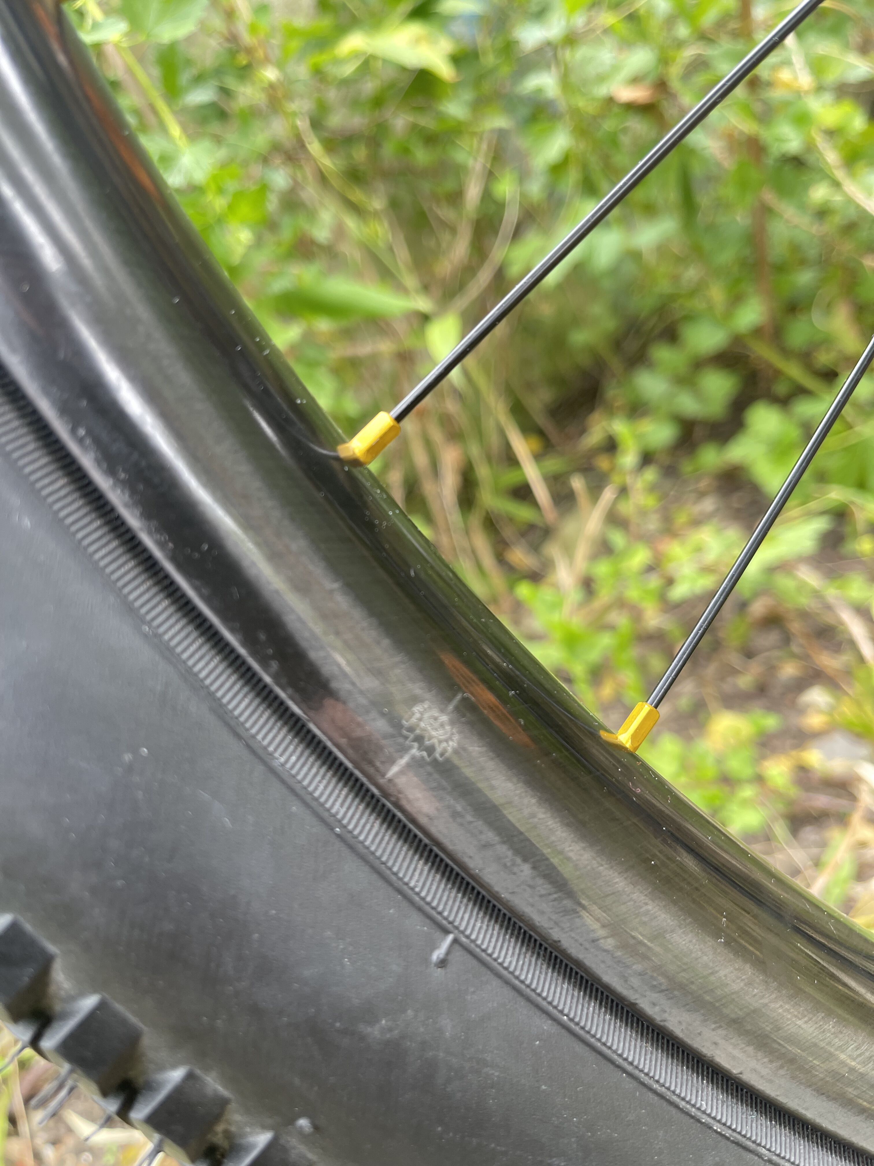

Mad4One G26 Berd-LightBicycle
  • Frame: Mad4One Medium Light Blue
  • Hub: Schlumpf M0274 36h + BrakeFast 32 (Black)
  • Rim: LightBicycle RM26C05 (Matte/Blue)
  • Spokes: Berd Dyneema® (White)
  • Nipples: Sapin DoubleSquare (Blue)
  • Brake: Hope Tech3 V4 (Blue)
  • Brake Mount: Hope B (Black)
  • Rotor: Shimano Donor Rotor SM RT86 203
  • Tyre: Schwalbe Nobby Nic 26x2.4” (Tan)
  • Inner Tube: Tubeless (Peaty’s)
  • Value: Generic (Black)
  • Saddle: Mad4One Haddle Saddle (Medium)
  • Seatpost: Mad4One 27.2
  • Clamp: Mad4One 3-Bolt (Blue)
  • Pedals: RaceFace Atlas (Kash Money)
This is a reworking of the Schlumpf shown in the first post in this thread - showing my Kris Holm G26. This hub / unicycle is what set my addiction to all things geared unicycling in motion and I’m hoping I’ve made the right call to shift to a BrakeFast system using Berd spokes. Should be fun!
