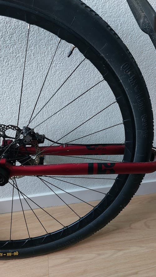

Game changer - 36er CARBON wheel!

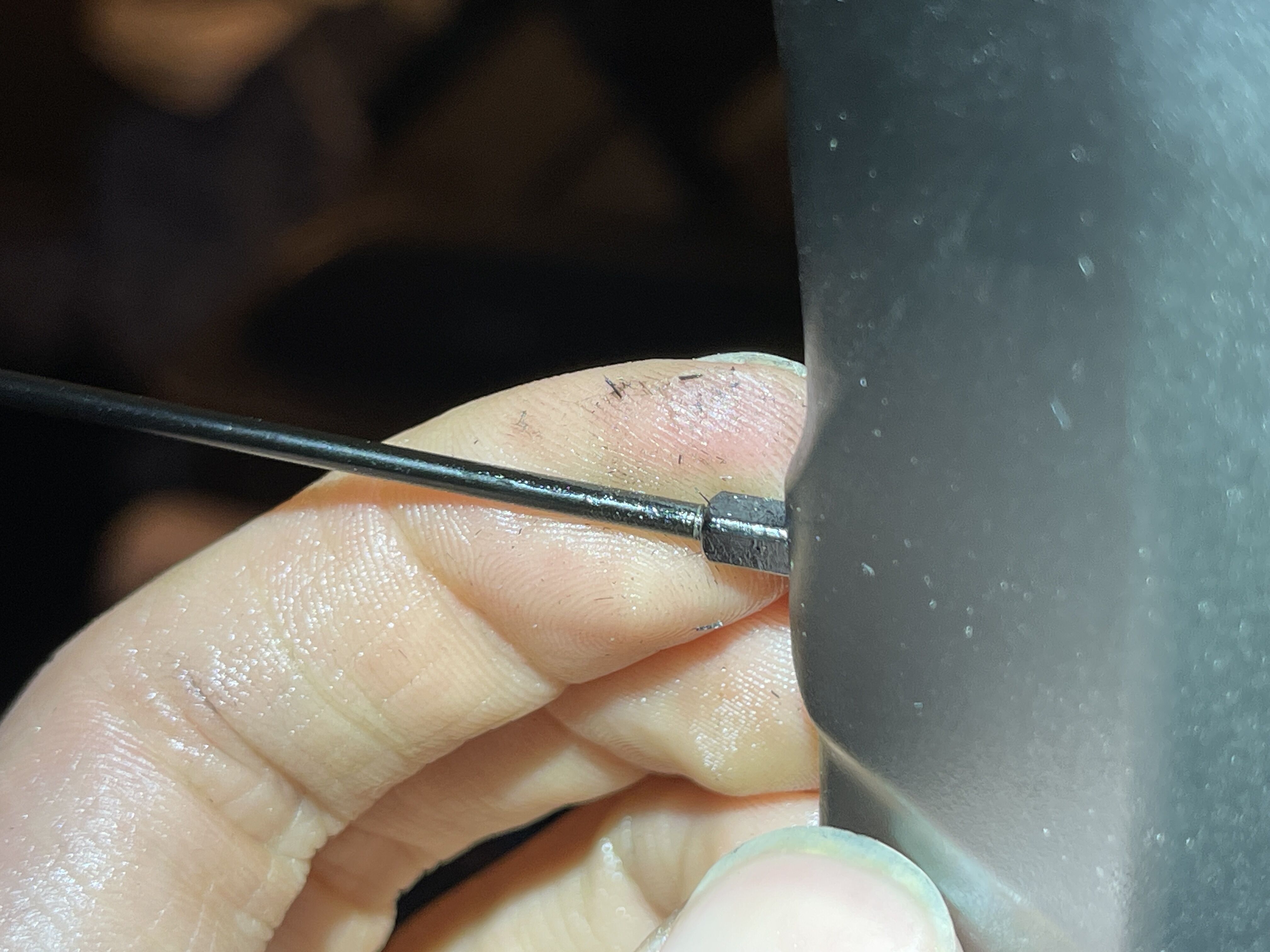

I gave up on trimming the carbon on the smaller spoke holes… (I lost the tiny razor blade sliver and am really hoping I don’t step on it in the future)
Trimmed the carbon on the larger access holes though.
I forced the nipples through with some effort. Plenty of carbon dust and shavings getting thrown around in the process though which is probably not particularly healthy..
The other thought I had (after you said you had a solution using the part of a razor blade) was to use an end-mill of the same size as the hole/nipple and just put it in the hole and rotate it with your fingers.
My reasoning for using an end-mill is that it probably has four flutes which have a shorter pitch and are sharper than a drill, so might have a reasonable chance of cutting the slivers of carbon fibre – bit of a moot point given you’ve got the wheel built but it might be an idea for someone in the future.

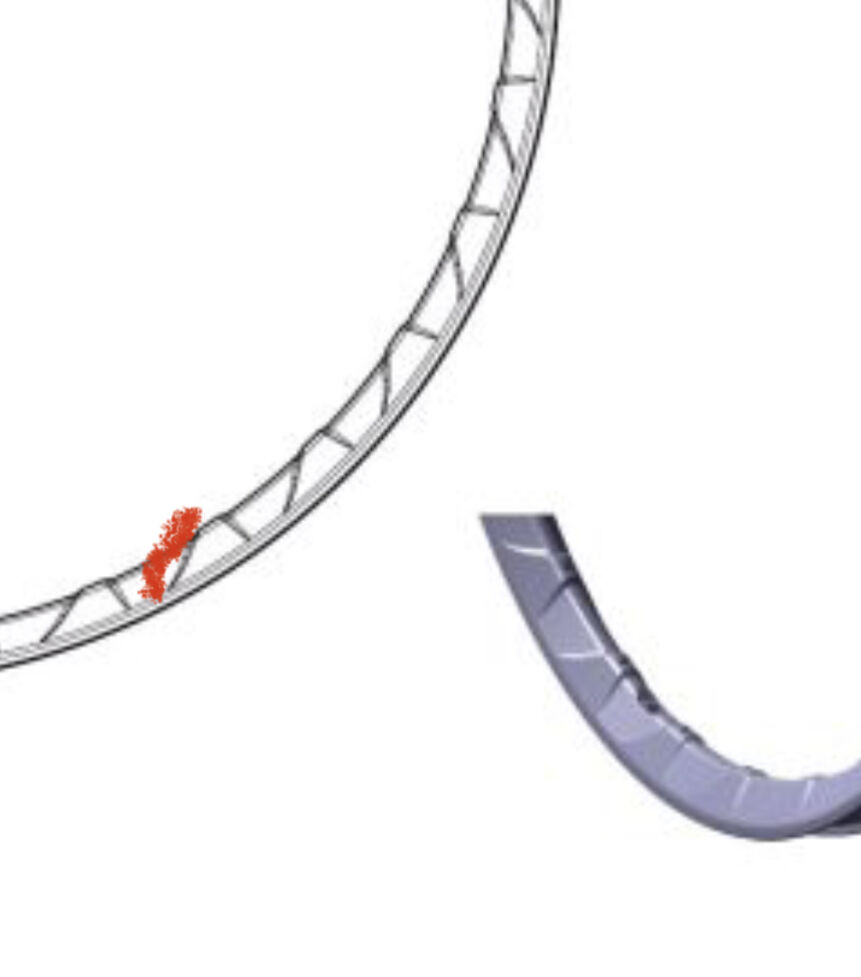

Is there a correct way round to orientate these rims?
I’m talking about the direction of the shapes on the circumference?

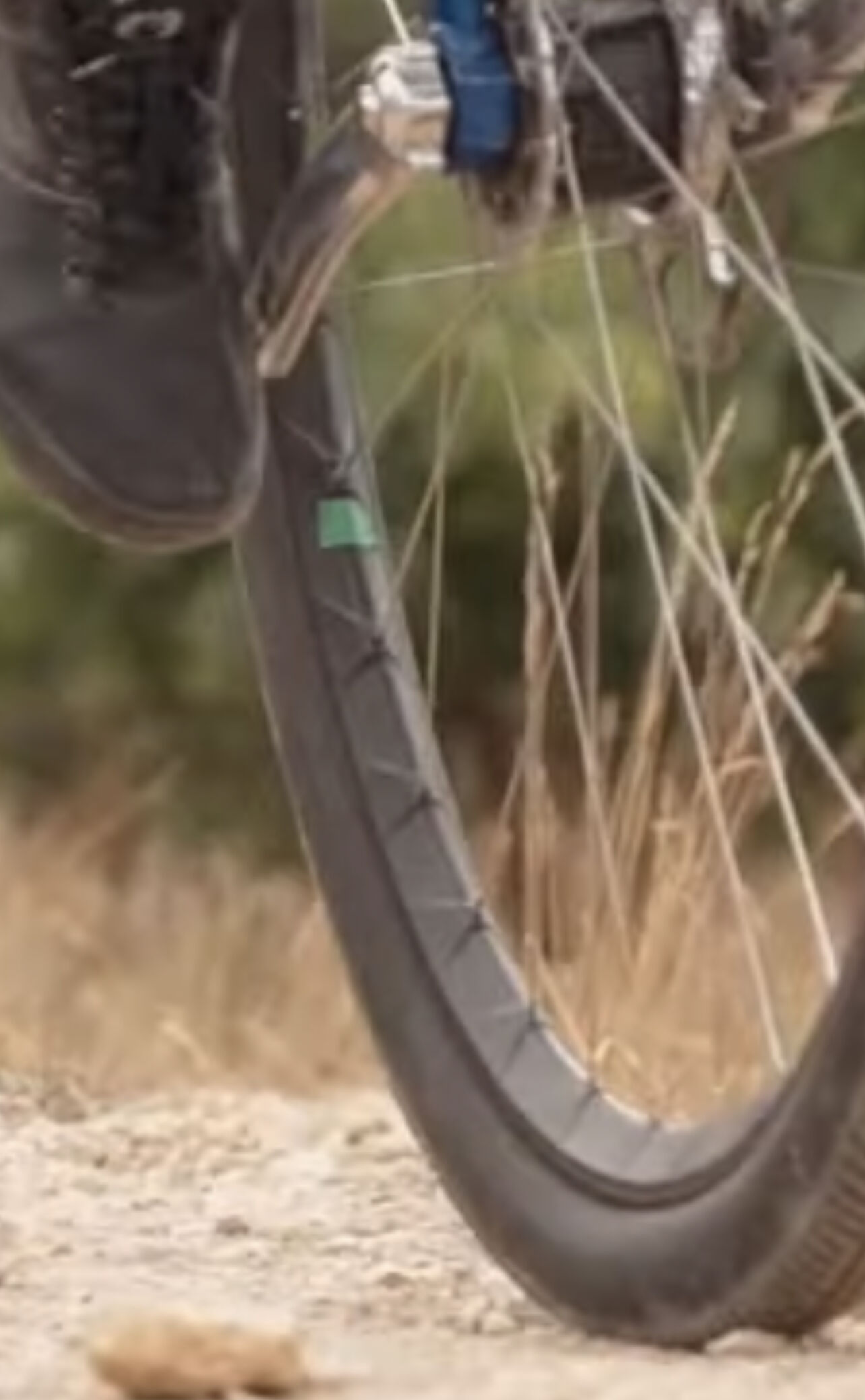

Looking at the gallery here:
Most bikes featured there appear to have the longer line facing forwards - baring one bike where the front wheel has the long line facing forwards and its rear wheel has the long line facing backwards.
I’ve taken a close up look at the amazing video Ride Everywhere and from freeze frames it seems that wheel was built with the long line facing backwards.
Is there any logic to this and is there a way this should be built for unicycle duty?
Long line I speak of indicated in red:

Does anyone have a view on this?
I don’t know if it got missed or if there’s no difference with how the rim is orientated directionally speaking?
:folded_hands:
I don’t think it really matters.
I suppose it’s more “aero” with the long line to the front:
This was the direction in which the first 36" wheels with this rim were built by truebikes (https://truebikes.eu/mtb/). I’ve just seen on your link that they’re built the other way…
Thanks so much for clearing this up, Simon.
I like the way you’ve laced it and as it matches the way I can see it was laced in the Ride Everywhere video - I think that’s clear enough that it either doesn’t matter or that is the best way :folded_hands:
