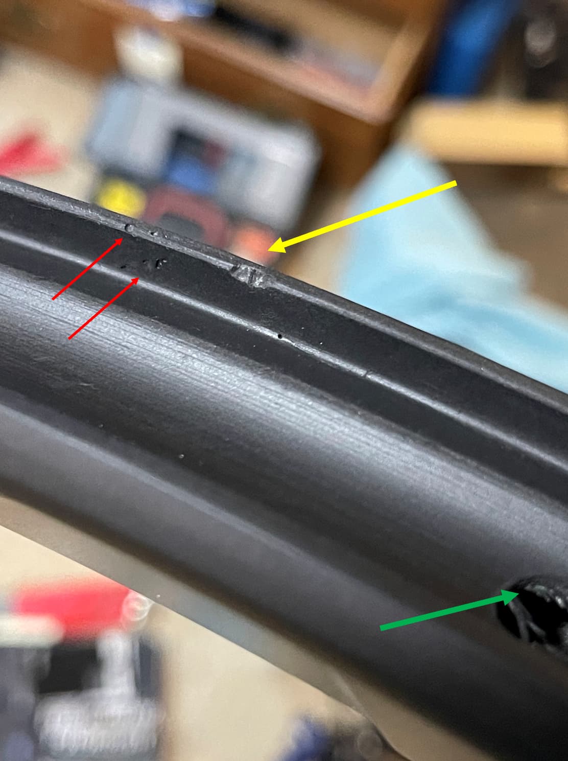

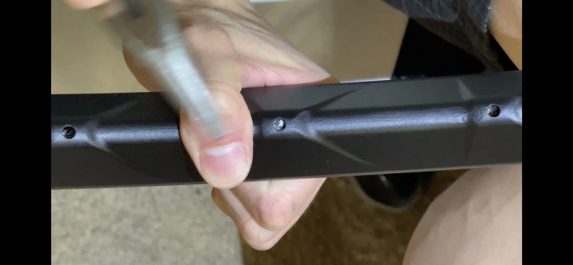

I got another Brauss rim, and it seems even worse than my first one.

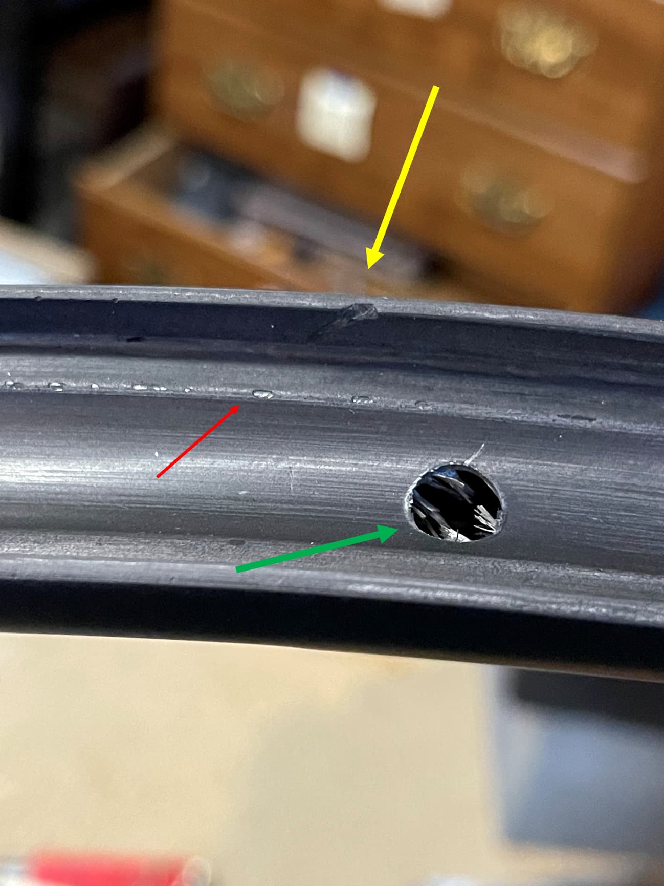

Every single large spoke hole has a bunch of carbon leftover. I am at least able to snip them away with flush cutters, and then use a small round file to clean it up.

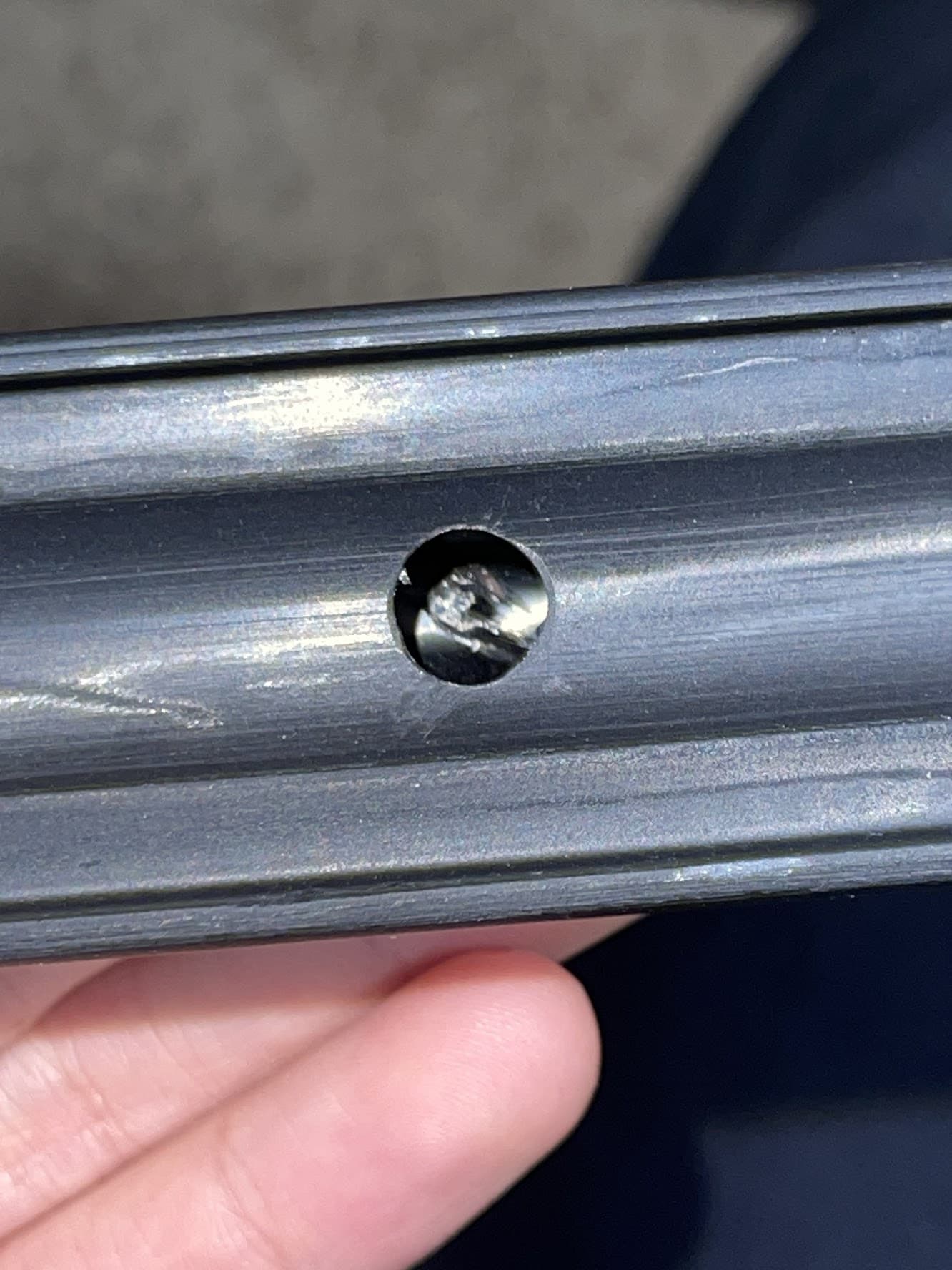

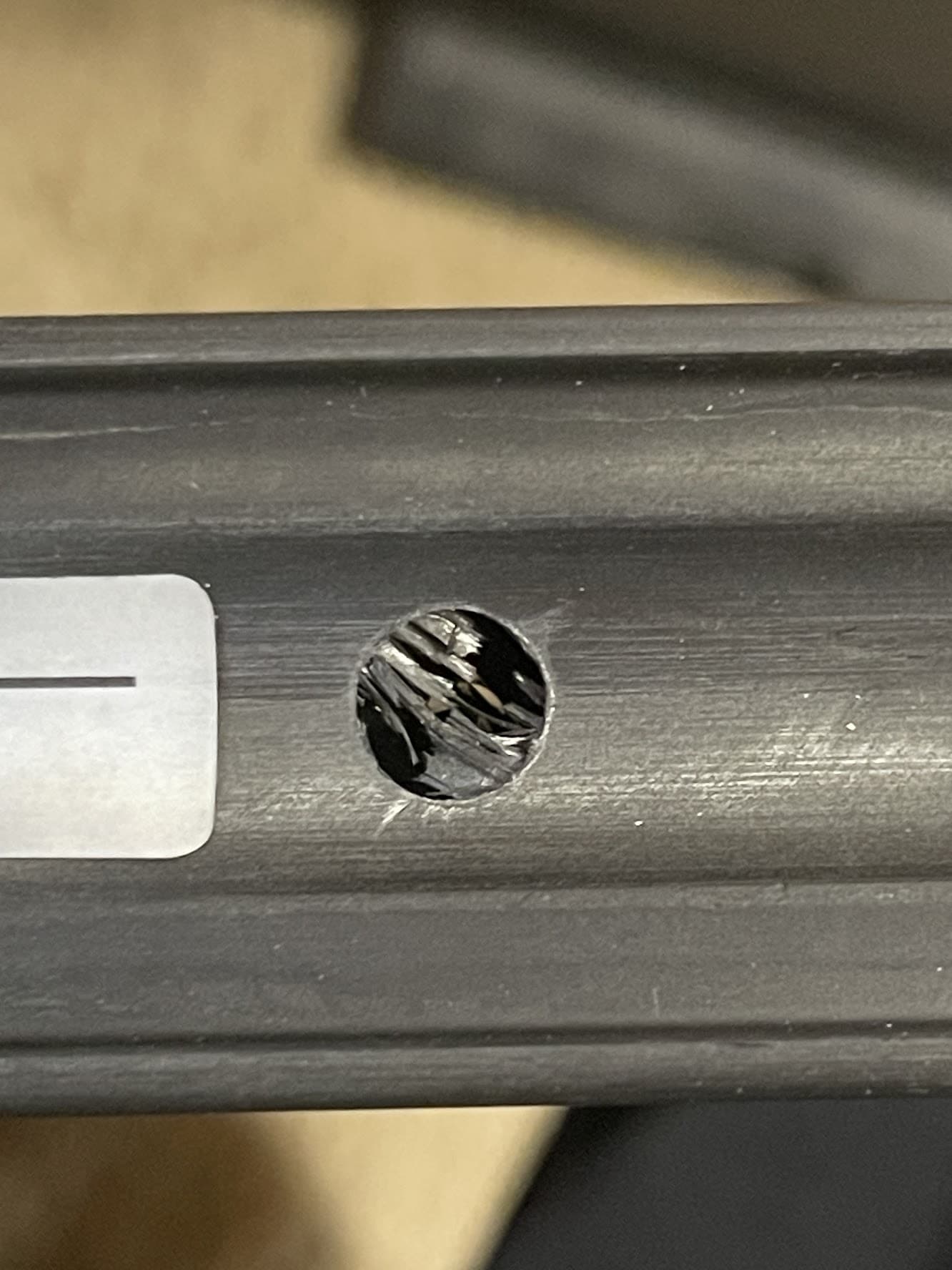

The smaller holes where the nipple sits is more annoying. Lots of thick strands of carbon fiber blocking them, and I don’t know how to clean these out.. For one of them, I tried to push a nipple in from the other side to force the fibers out of the way, then put it back the normal way. I’m a bit afraid of compromising the strength of the rim. Any ideas on how to clean this up, or forcing the nipples in is the best?
Plenty of surface defects, but these I will just ignore now…
First thing to do if you bought this new is to send it back, that’s unacceptable. If that’s not an option for whatever reason, I’d just take a little file and kind of saw at it and then smooth it out, maybe even a dremel for the big stuff.
Can you manage to grab the end of the fibres in the hole with a pair of fine tweezers so you can pull them taught and cut them with the point of a scalpel?
Failing that I’d try to pare them against the edge of the hole with the tip of a scalpel. Pushing the nipple in a bit and cutting them against that might be a reasonable approach too – it would give you something to cut the fibres against and push them out for better access.
Did you get that rim secondhand? If it’s new, those flaws are unacceptable to me.
Not secondhand. Directly from alchemist as a warranty for my first rim.
I have a small exacto #11 blade, and it does not reach far enough into the nipple hole..
Given it took about 10 months to get this second rim and dozens of follow up emails..I am not fond of dealing with them.

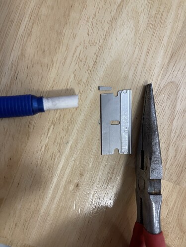

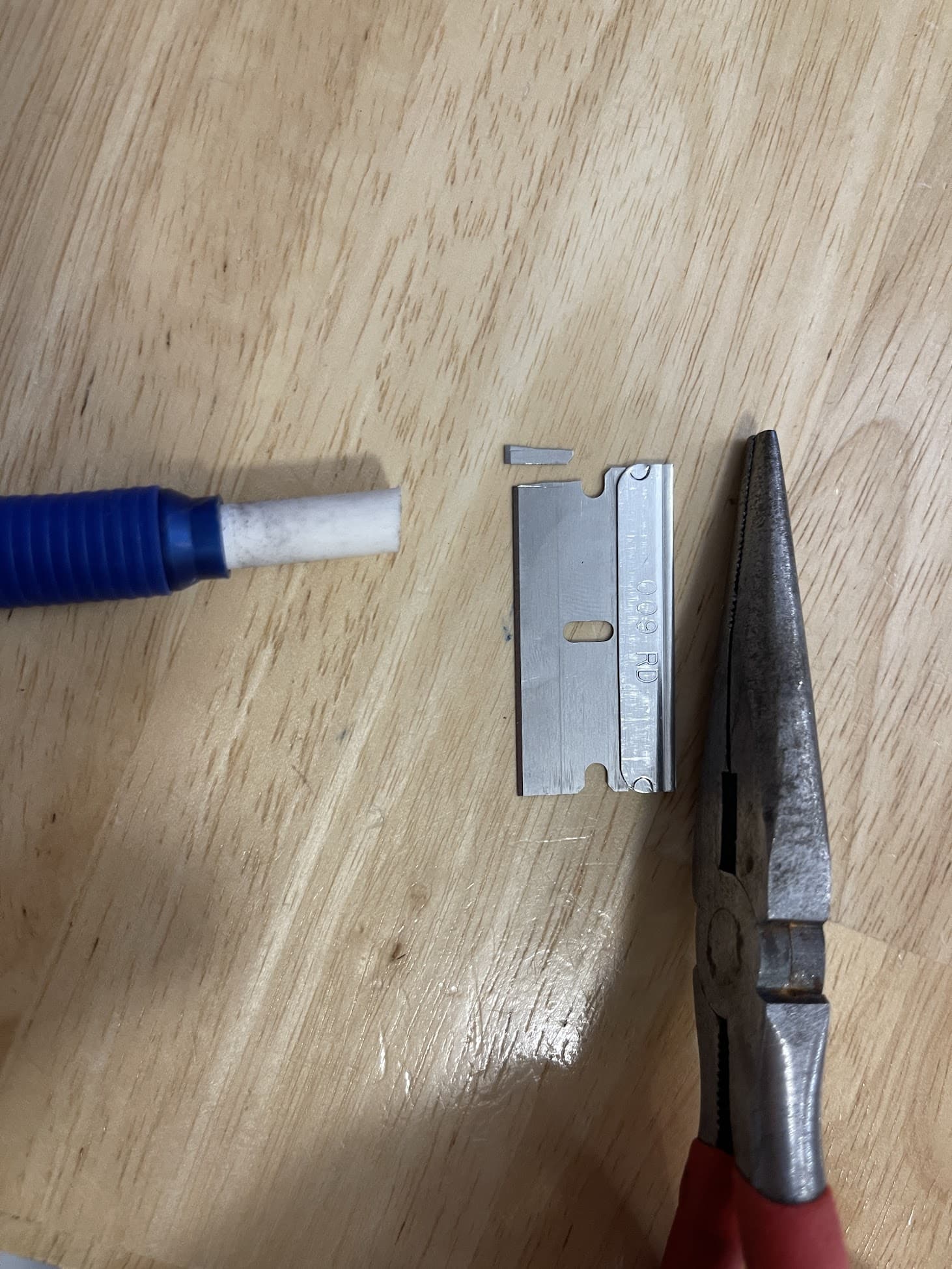

I ended up breaking a piece of a razor blade off, holding it with a pair of pliers.
Then, push a cylindrical eraser up against the back of the hole, and cutting it with the piece of razor blade.
It is a huge pita to do though..
My condolences on these problems with your new rim. Wish you had a proper product instead of having to fix their quality control issues…
The surface defects just seem to be one of those things that they’ve never quite got right, and you could possibly forgive (especially if you were aware that it’s been a pretty common problem), but the fibres that haven’t been cleaned up is just lazy.
For such an expensive product they absolutely should be spending the time to clean these holes before shipping them out and not expecting customers to do it.

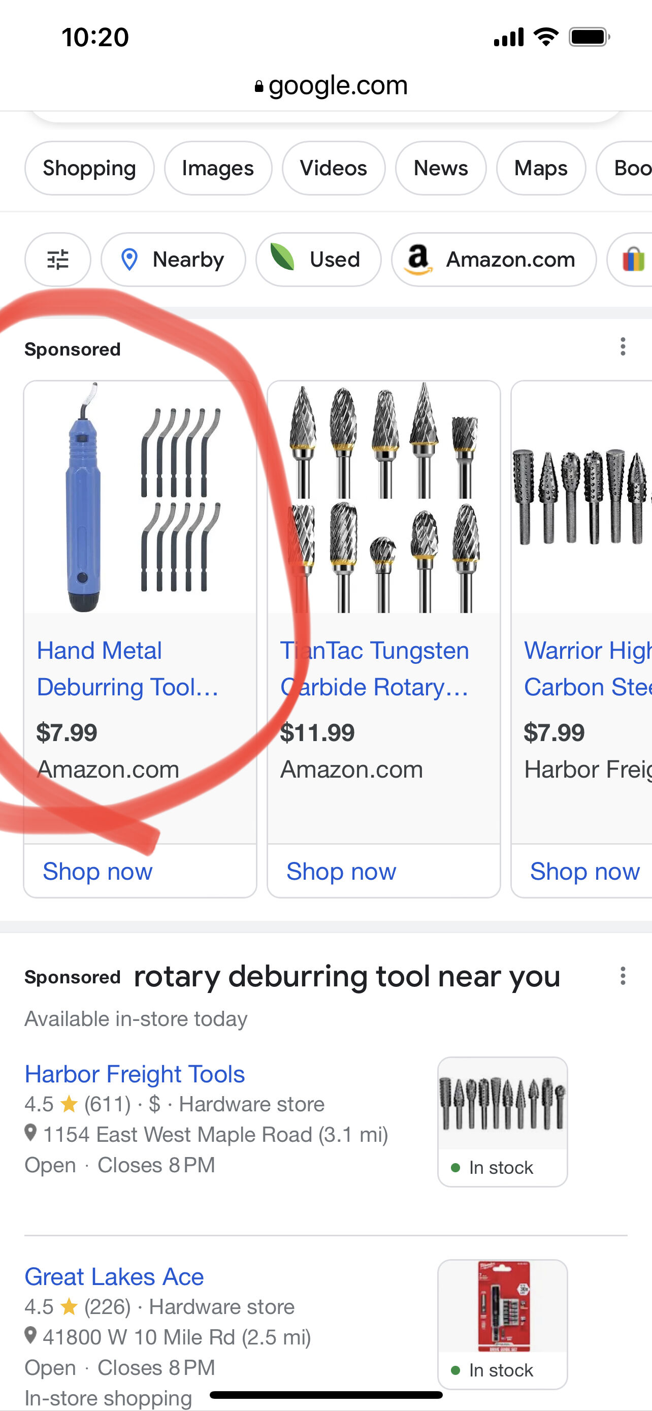

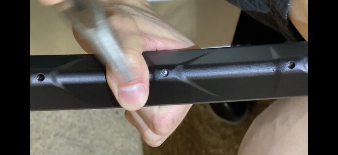

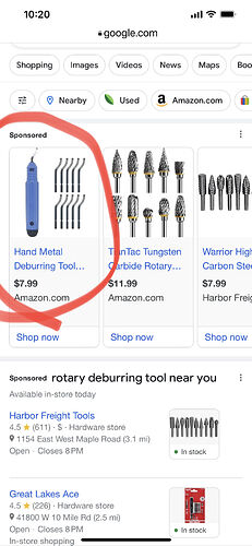

A sharp rotating deburring tool would be my first choice, after contacting them to get some kind of a discount for the trouble.
I tried this type of tool already
It unfortunately does not fit in the small hole. I used it on the larger spoke access holes, and it works to smooth the edge, but the flexible fibers just get pushed out if the way.
