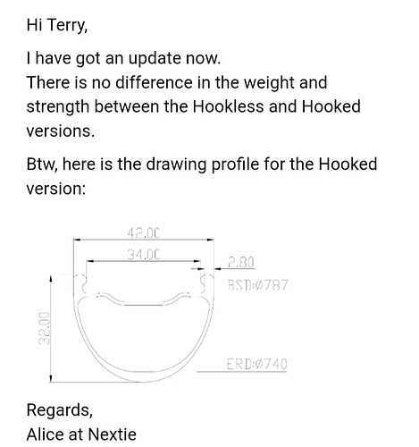

For reference, drawings for the Braus Alchemist and the Nextie rims:
As per our experience, too large rims are more prone to blow-outs. We would recommend to design a rim around 27~28mm inside. Regarding the depth, I don’t know much but Braus Alchemist rims seems really great. Please note that we’re kind of limited by the available inner tubes, too. We can’t have a too-deep rim or we will face inner-tubes supply issues. So sticking to what actually exists would be great.

Least but not last, Nextie promised us their 36" carbon “Unicorn” rim last year. But it was a fail. As unicyclists, we were unaware that the 36" tires made by Innova were a bit out of spec. Nextie told us these tires have an oversized bead after we’ve had lots of blow-outs, with people trying to inflate their tires at 45+ psi. To mitigate this issue, Nextie developed a second - hooked or hookless, I don’t remember which one came second - version… But this did nothing and the blow-out issues are still there. The only solution is to use a Vee T-Monster tire, which were out-of-stock when the Nextie rims came out. They are now back in stock, but relying on a single manufacturer for the entire market seems dangerous to me. So we should aim for a rim that fits both Innova and Vee tires.

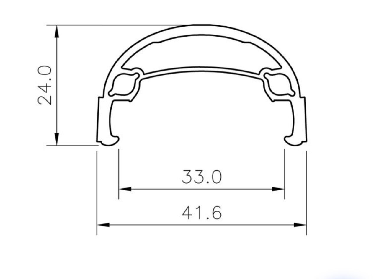

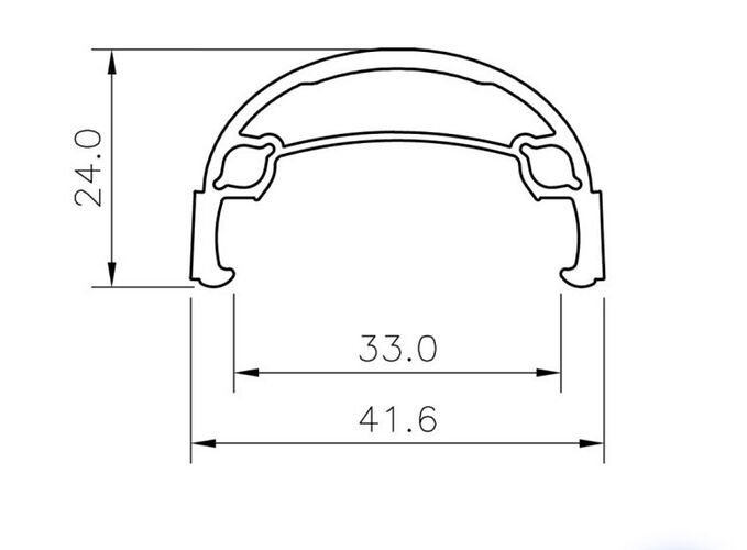

Perhaps useful linking them to the green rim page that shows this:
I’d love it if they took inspiration from the Dominator2 rim regardless of whether this is the most modern design.
Backwards compatibility to older designed tyres should be key IMHO
Do we know the height of the sidewalls for each of the existing rims? It is never specified on the drawings, and according to schwalbe, it is a key element of the “derailing safety”.
Why would you like a new rim to be similar to the Dominator2 rim? IMHO, the Braus Alchemist rim profile looks better for my practice. But maybe yours is different, so you see different advantages :slight_smile:
They’re definitely higher on the Dominator2 36" (Stealth II 36") than the Nextie Unicorn
Nextie stated that they couldn’t make the walls any higher due to physical machinery size limitations.
I guess because I know it works with the NR tyres.
I :100: prefer the Braus design look compared to the Nextie -
But the key thing I was saying was take inspiration from the Dominator2. I think Nextie said they would / were doing so, but … it wasn’t the tested inspiration I’d dream up.
