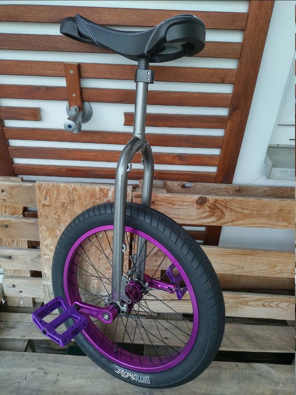

Project and text by a friend of mine who wanted to but was unable to post it here, so gave me permission to do so.
Hello fellow unicyclists!
I’ve been following this thread for quite some time now and I couldn’t get the idea of a 20" free wheel unicycle out of my head.
After years (!) of fantasizing, it was finally time to make it a reality.
Looking at the price tag of the Pipifax hub I had second thoughts immediately.
While reading this thread, I stumbled upon this idea of combining the drift trike wheel from Rideminded and monster fatty frame from einradshop.ch.
This might juuuuuuust work out. Maybe.
But given the price of 200 bucks for both components, I couldn’t resist the urge and try to build THE ULTRA LOW BUDGET FREE WHEEL.
So I took one for the team and placed the orders. For science!
Both shops shipped super quickly.
The frame is built for a bearing space of 120mm but the drift trike wheel has a space of 118mm.
This is not a problem, because the frame is flexible enough to compensate for this.
Now comes the tricky part: the bearings of the wheel have a diameter of 42mm (so far so good…) and a width of 13mm.
That’s one mm more than the specs of the frame.
Even using a proper bearing puller, I couldn’t for the life of me remove those bearings. They wouldn’t move not even the tiniest bit.
Wrote an e-mail to customer support: I turns out those bearings were put ont the hub using special tools. They are not meant to be removed. Ever.
So replacing with standard bearings was out of the question.
I was not amused. The frame has a space of 12.5mm to hold the bearings. To make those parts fit, I would need to remove 0.5mm of steel.
So I grabbed a dremel and spent half an afternoon with dremeling away at the frame and the frame brackets until there was enough space for the 13mm bearings.
Oooof. The rest of the assembly was a walk in the park.
I couldn’t resist the fancy purple pedals, but one could also go super cheap on all other components.
It is done. The proof of concept: A free wheel for approximately 250 bucks (without the need to assembe a wheel) is possible.
At some point I might replace the cranks with longer ones, as those on the wheel are only 90mm long.
Now the only thing left to do, is learning how to ride this beast. I don’t plan to add a brake. Wish me luck!
TLDR: I built a super cheap free wheel using a drift trike front wheel and a swiss fatty frame, but it involved quite some tinkering.
Is it possible? Definitely, but I wouldn’t recommend it.
