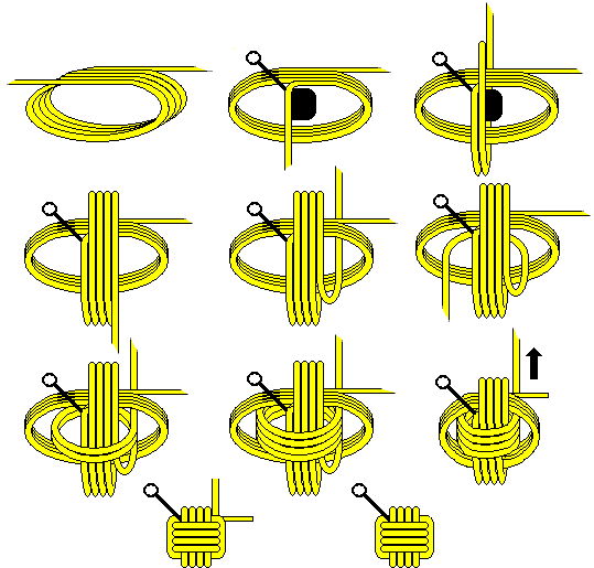

I really need to learn the monkey fist knot

The little piece of wire sticking out the middle is to attatch it to chains. You don’t actually need to put anything in the centre to tie the knot, but it helps add weight to the knot. Soaking the wick in fuel will make it heavier, of course.
Lifted from the The home of poi
I was just thinking the same thing. Here’s the first thing I found on google.

Our monkey fist is made with 14mm kevlar rope, nothing in the middle. With that thick rope it doesn’t need it, and is at least as heavy as you want for hockey.
In this test game, the end was just cut, not tied in, it would probably be sensible to splice the ends together using kevlar thread, as towards the end, the rope did undo slightly and it doesn’t roll so well then.
