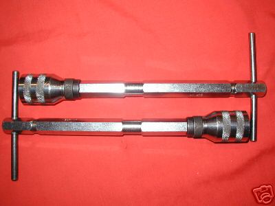

A standard hub has an outside bearing spacing of 110mm. The Coker hub is 140mm outside/outside bearing spacing. Because the old frame is steel, it should be possible to spread the frame to accomodate the new wheel. I have straightened, and opened many bike frames/forks and it is fairly straight forward if you have the right tools. The trick with opening the frame is doing it without denting the tubes.
Unfortunately, the tools used for squaring/alligning the dropouts on a bike won’t work in a uni frame, and so you will have to make a tool for this purpose.
I don’t think it would be too dificult to make a set of tools that gets clamped in the bearing hangers, and allows for applying leverage to the fork blade. I have an idea in mind, if you are interested I can draw it up for you.
