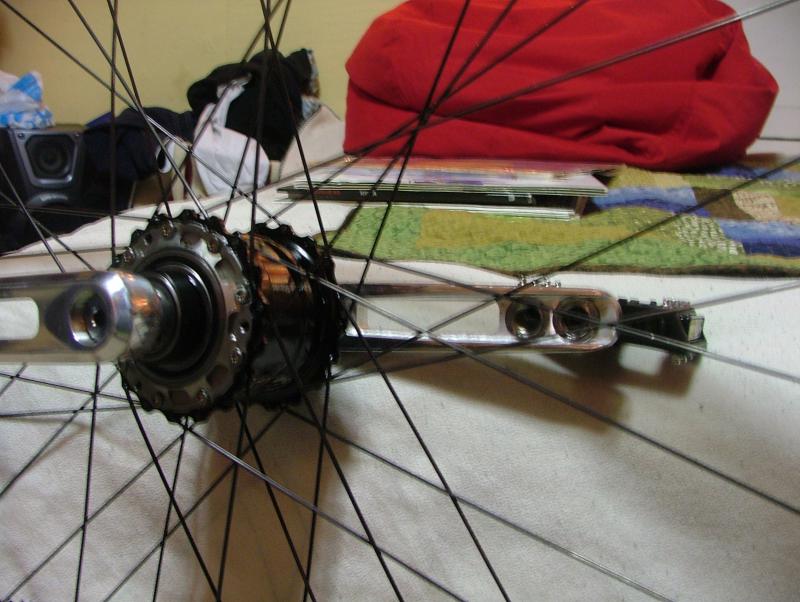

I got drilled cranks from Will Riley on my flatland uni now, it doesn’t feel like the strength has been weakened at all..

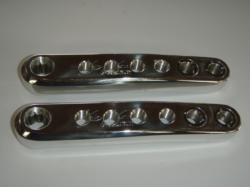

I drilled my moment (150’s), with five 5/8" holes in each crank. I used a drill press a clamped the crank down. I had a little trouble with the bits moving so the holes aren’t perfectly centered, but they’re certainly close enough.
I drilled a set for a second pedal hole and found that if you drill from the back the drill does not wander as much. I drilled in 4 steps to get to 1/2" but feel I could have easily done it in 3.

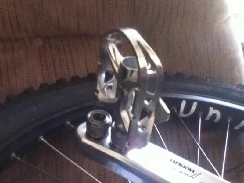

just got these… I cut the cage on the inside toward the cranks so it would pass the second “chuck” and when I get my 36er back from where it is, I’ll give it a try.
Here’s how:
Tools required: milling machine, end mill, vise.

A Milling machine is hands down the way to go.
The idea is to Mill out a channel rather than just drill holes.
Or in my case both:
I lost somewhere between 35-40% of the weight. Ive been riding nothing but these cranks for over two years now and they haven’t bent, cracked or failed in any way, yet.

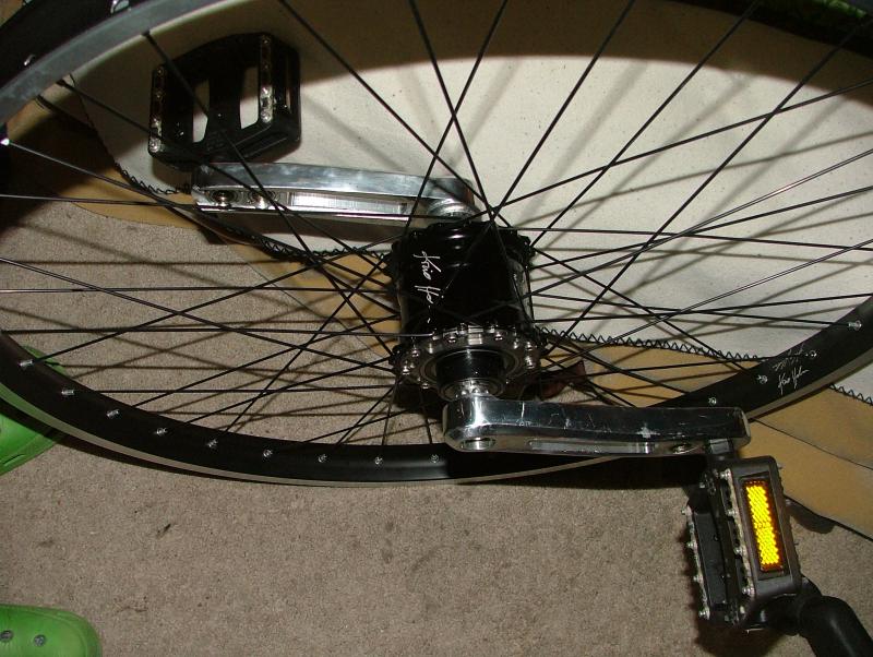

Saves some weight in an important place. Just did it on the 29er, 19 and 14 are still undrilled…
You went all the way through (I think? Pic isn’t too clear) - haven’t seen that before! How much do they weigh now?

Diden’t get a weight, but its definitely noticeable.
Ive never seen bent Moments…I always bend pedal axles first…Maybe they are stronger than you think?
