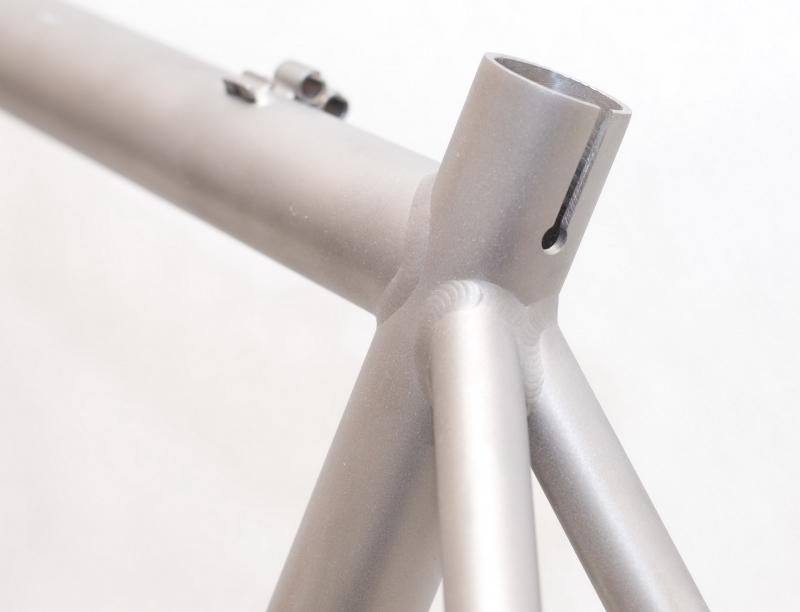

Sponge, you are correct, I have also seen those cable guides crushing the whole fork. But we both ride bicycle trials and we know that the stress and the direction of stress applied on a trials fork is completely different compared to a municycle. Trials riders do things like hookups and touch hops. Which is basically slamming the bike (front wheel) against a wall :slight_smile:
We have been using cable guides on all XC/Trials frames and they have never failed.
They will not trouble a unicycle frame too.
Those stick-on guides looks like a nice idea too. The only concern may be the glued attachment. Are you sure it will stay long?
On a unicycle frame the seat tube may be used to carry the unicycle and thus the guides could be torn off withing weeks (just a guess).
That’s def true for bike frames with cable guides, but I guess bike frames die earlier at other more stressing points like the headtube or chainstays.
I have noticed on some trials frames that the cable guide’s welding forms a bit of small ‘wrinkling’ after a while. For a uni frame though the stress placed on the seattube is pretty high, so there’s potential for a stress riser to form eventually. It’ll take longer on a Triton than say an alu frame but still… it’s good to keep the welding to a minimum imo. As such I’m totally against integrated seatclamps welded onto a frame… I’ve seen a few disasters before on BMXs!
Those stick-on guides are really really grippy. I doubt Tartybikes would run them on some of their own bikes otherwise. If positioned in the right places I don’t think that there would be much chance of them being rubbed off by say repeated leg brushing.
I think most people carry the unis by one leg if not rolling them so having those guides stuck onto the neck isn’t too much an issue.
Well You are all right about welding on hose mounts and seat clamp bolts.
I’m a Motorcycle Engineer and on e-mailing Dmitry asking about the hose mounts and knowing the XC Muni riding I do! I think it well last Me for years to come (until My next design idea).
I was after a clean look and I think this is as simple as hose mounts, No welded on seat clamps (the seat clamps I have used clamp all the way around the seat tube! unlike a weld on clamp!), Loads of room for Mud and stones, and a short seat post (to save weight).

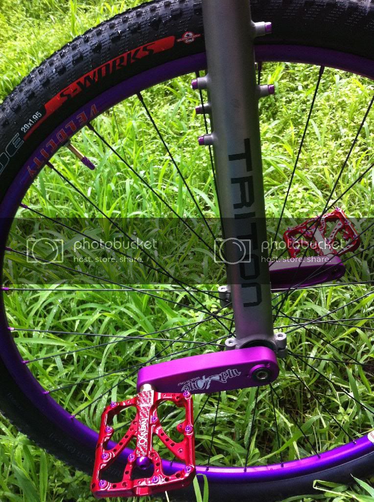

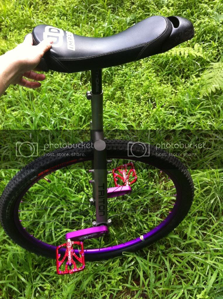

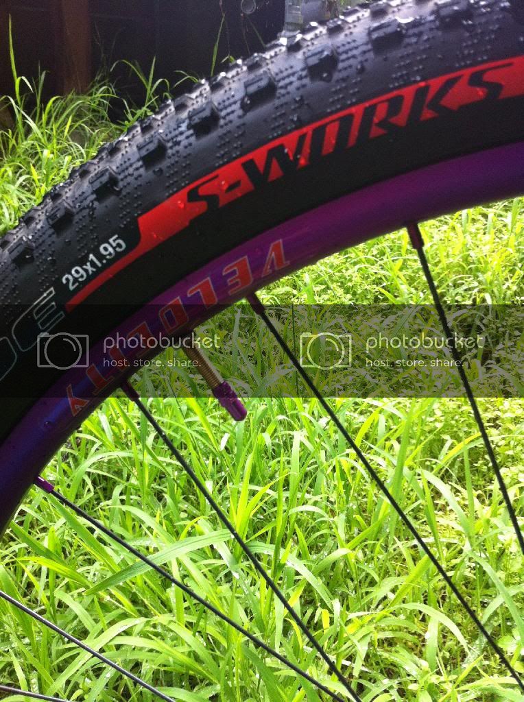

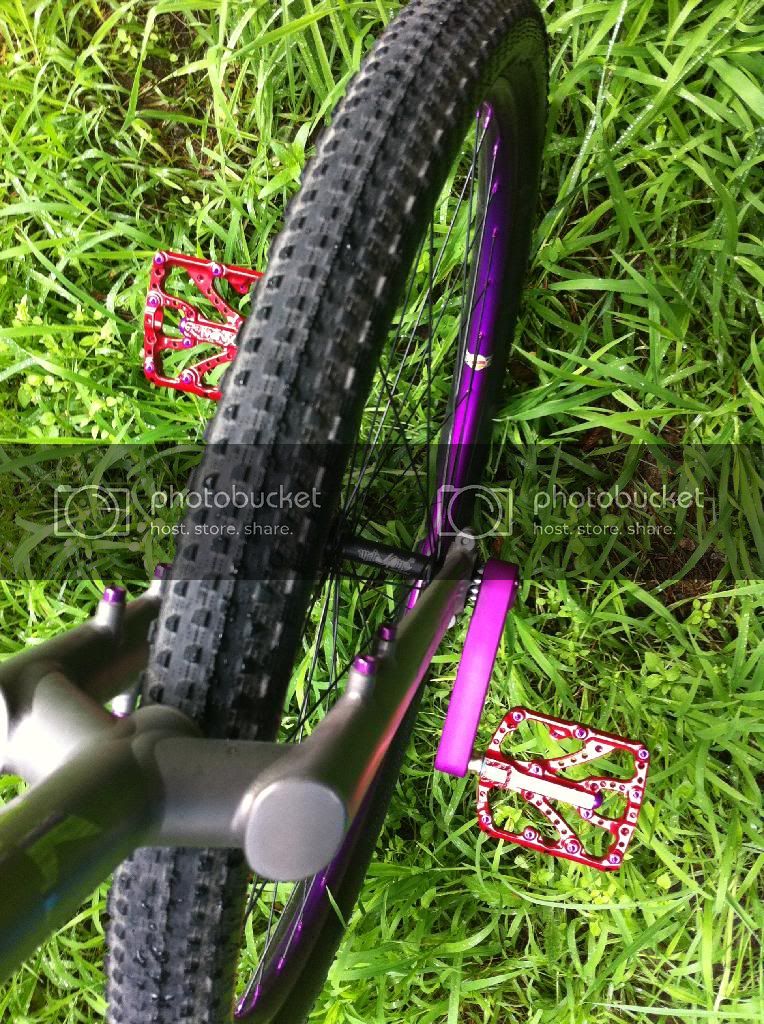

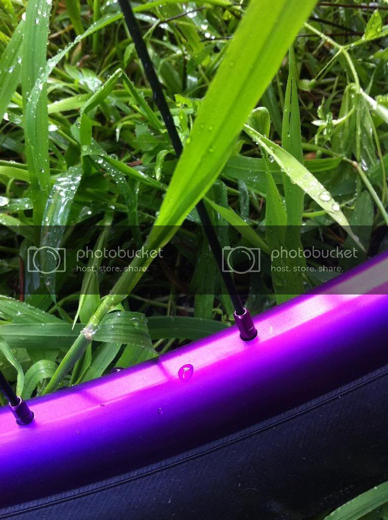

Built a tubeless 29" wheel for my Triton frame. I plan to use it to commute about 10 miles to school over the course of the next year on both concrete and dirt paths. Maybe I’ll include some light XC and some bike polo if I have time. :slight_smile: Eventually I want to use it for racing, but if you’ve followed my recent posts, I’m not having much luck there.
Specs:
Impact Naomi foam and cover
Scott Wallis CF base
Thompson Elite seatpost
custom Triton 26/29 frame
Specialized S-Works Renegade tire 29x1.95
Purple Velocity Blunt SL rim
Purple DT alloy nipples
Black DT Comp spokes
Purple Deity presta valve cap
Black cromo Mad4One hub
Purple Mad4One ergal aluminum light race/road cranks 125mm (352g)
Red Twenty6 Predators with Ti axle and purple pins
Big thanks to Marco for superior customer service. :slight_smile: Mad4One is awesome!
