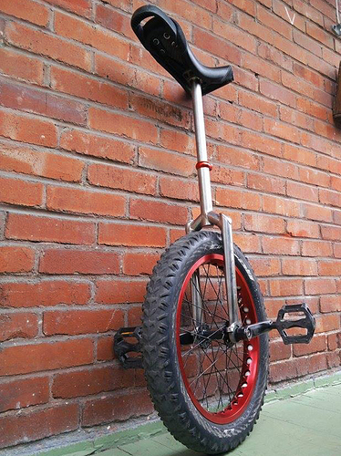

The mountainuni set-up and the color (and the allowance for the purple chainring bolts). :slight_smile:
Seat Carbon Fiber seat base (Axel) + Impact Naomi foam & cover
Seat post Titanium seat post (Koxx-one titania plate + tube welded by Jakob)
Seat post clamp Salsa lip-lock - red
Frame Triton Sponge #7/7 - polished
Hub Nimbus 32h
Cranks Qu-Ax tubular 125mm
Pedals VP-560
Rim Echo Urban - Red
Tire Try-All light
Is the weight savings you get from riding with no bearing caps worth it? :sunglasses:
yes
Maybe don’t do any hops without them though… Strictly a racing uni :sunglasses:
Or just some really extremely epic wheelwalking stunts.
Well, I was in the process of packing my uni for some travels, hence, no bearing cups. I actually ride this wheel now, I like the green better, and the koxx 140s more too.
It’s 4.5kg.

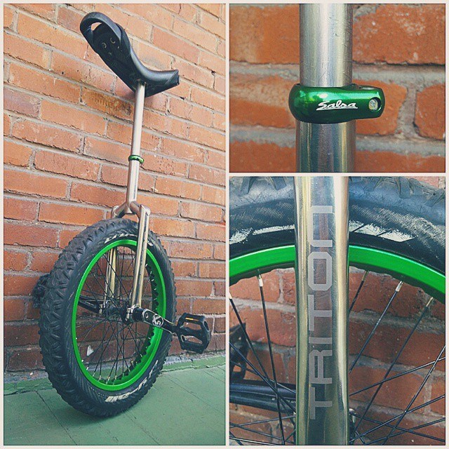

Seat post clamp Salsa lip-lock - green
Hub Koxx-one light
Cranks Koxx-one light 140mm
Pedals VP-560
Rim Mad4One
Tire Try-All light
The green is much nicer
Amazing weld quality!
I’ve been a metal model maker/ fabricator for over 35 years, and have worked with some talented craftsmen, but I have NEVER seen better welding than what’s on the Triton frames. Pure artwork!

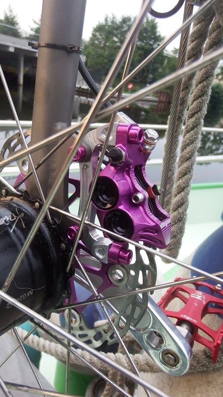

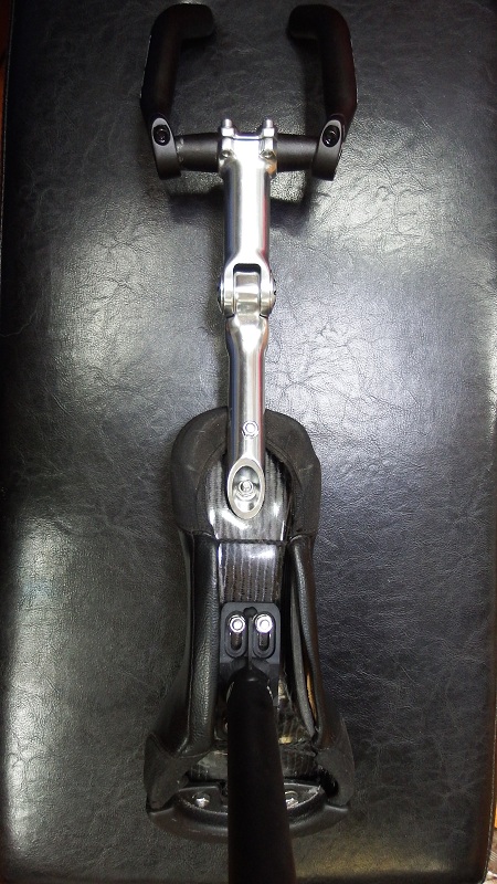

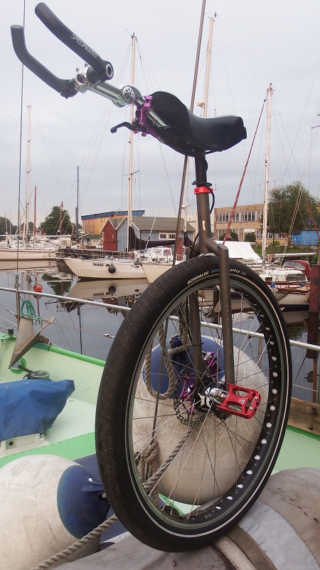

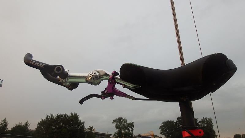

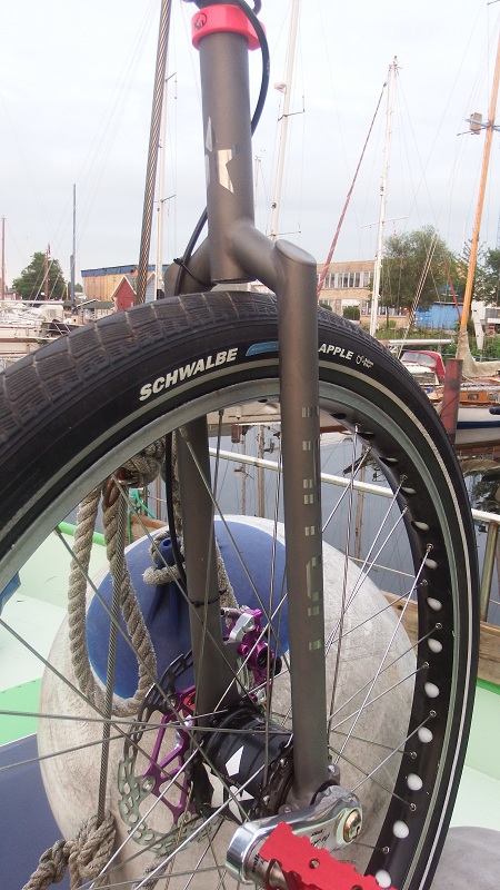

29" Triton-Schlumpf
26-29 x 3 Triton frame
Schlumpf hub

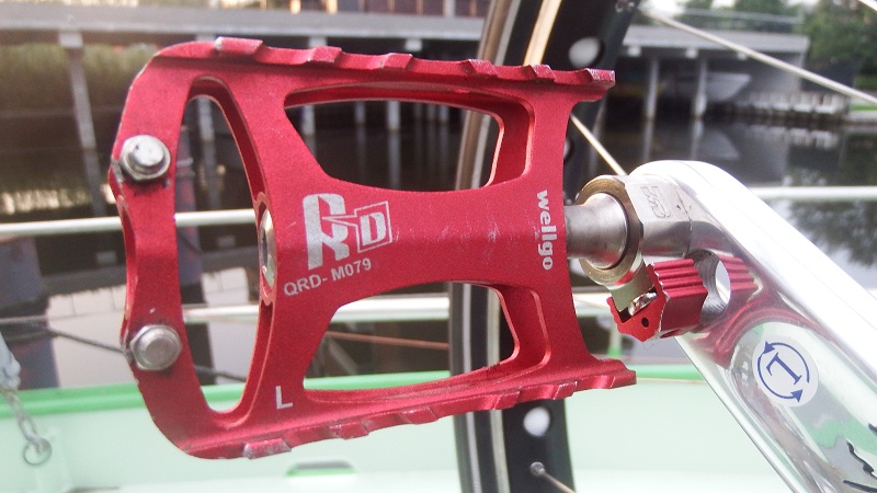

127 x 110 KH spirit cranks
Hope Tech 3 E4 brake 183mm
wellgo QRD M079 Pedals
29KH 47mm rim
Sapim spokes
29x2.5 schwalbe marathon
Koxx seatclamp
Koxx pitfighter II seatpost
Axel Kaestle Karbon seatplate
Adrien de la Croix seatcover
Jogi assembled Handlebarr
:D:D:D Thank you :D:D:D
Too sad, that it’s not possible to install two of theese QRD adapters at the same time.

Is it the new Triton design with smaller and lighter titanium tubes ?
yes, 1 inch tubing,
500g:D
but all this frames are gone…for very old orders.
5 more are done but not jet shipped,
20" trials are done but not shipped,
36" and 24" and 26 - 29 wide frames will be made soon… (- in the next years? )
