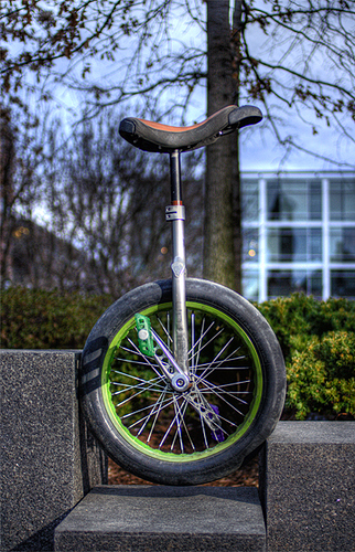

I am happy to say my Triton has served me quite well. It has taken the severe thrashing I have given it, with a smile. Only one small dent. Many many more rides to come. I still, on occasion, hit my knee or shin on the crown, and shortly after I jump around in pain I am super thankful its a Triton crown…:stuck_out_tongue: I still wish I opted for the long neck when I had the chance.
Here are a few shots of my current setup as well as a couple actions photos of what it can do.
photo: Brian Oley
photo: Brian Oley
In action:
photo: Brian Oley
photo: Brian Oley

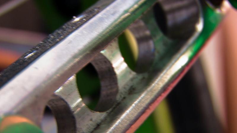

For those of you who want a close of up the drilled Moments:
Like I sad before, those drilled Moments are HOT :sunglasses:

Sam is that the second set of drille moments?

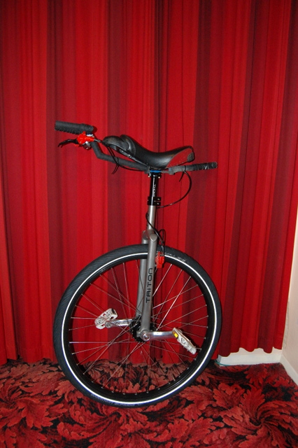

Anyway, I know I’ve written lots of good things about the Triton elsewhere, so I’ll just post a few photos instead to get you all drooling;
The lovely looking crown (slightly different from the trials version)

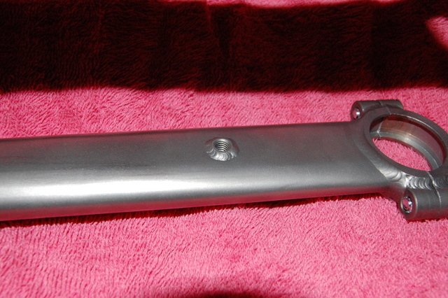

Detail of the Schlumpf torque arm bolt hole and bearing holders. Just gotta love that welding!
The complete Triton-Sponge-Schulmpf uni

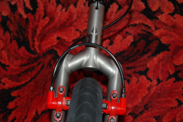

Magura mounts
