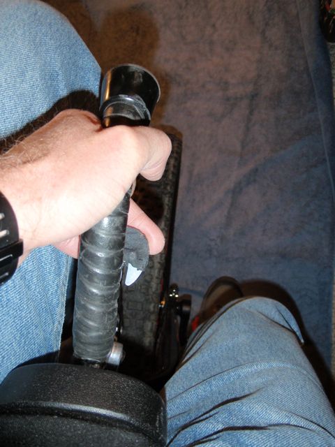

I thought I’d share a few photos of the Nurse Ben grab handle set up on my Oracle 26. It’s pretty much the Standard Nurse Ben set up, with a few customized features – most of which were suggested by Ben, with a few “twists” added by me. :roll_eyes:
As Ben recommended, the handle itself is a long “rotationally adjustable” bar end that I bought off E-Bay. Because it rotates, it can be aligned to project straight out and down from the saddle, in perfect alignment with the wheel and direction of travel. Once I found the right position, I used blue locktight on the adjustment bolt to keep the handle from loosening and twisting. I went ahead and swapped out the regular plastic grab handle on the saddle with a freestyle handle so I could grip the new handle close to the saddle, but you can always just saw off the grip portion of the standard handle that comes mounted to the saddle. Despite its proboscis-like profile, I have yet to get “tangled up” in the new handle during a UPD. :smiley:
A thoughtful chap at my LBS provided the idea of protecting the new handle by wrapping it with strips cut from an old inner tube, but I soon discovered that 3M Temflex Rubber Splicing Tape (2155) was a better idea. Why? It’s thicker and grippier than inner tube rubber, and it comes pre-cut in a perfect 3/4" (19mm) strip. Plus, it’s pretty inexpensive: 22 foot (6.7 m) roll is only $2.48 at Home Depot. It’s sticky on one side, but not as sticky as regular adhesive tape.
To finish the wrap and hold it in place, and also to protect the end of the handle, I simply twist on a 1" “rubber leg tip” over the end of the wrap. These caps are inexpensive too, and readily available at Home Depot or Ace Hardware. (This is probably my greatest contribution to the ever-evolving world of grab handle design. No expensive lacross stick ends for me. No modified skate wheels. No custom delrin balls. Just a big goofy rubber leg tip. Looks hideous, but works great and is cheap to replace.)
To position the brake lever closer to the handle, and further back towards the saddle, I made a brake mount out of a “repurposed” sawed-off straight aluminum bar end. It goes on the mounting post first, before the handle itself. The result: The brake lever is exactly where I want it and is very well protected by the drooped handle with attached rubber leg tip.
Like Ben, to make the Starfighter spooner less likely to take a chunk out of my leg during a UPD, and to it make it easier to grip, I cut a small piece of closed cell foam as a central insert (placed between the “wings/engines”), then covered the front two thirds of the Starfighter with insert with 3M friction tape. It’s now super easy to find and engage, and can no longer bite my legs or fingertips. :stuck_out_tongue:
This configuration works well for me, although I sometimes find the straight-out handle to be less than ergonomically perfect. Still it’s super solid since it incorporates a standard KH stiffener plate. And, with the brake mounted on the sawed off bar end, the lever is within easy reach and well protected during “nose dives.” :astonished:
I’m brainstorming designs for more ergonomically correct handles that would mount on the post of the Nurse Ben style stiffener plate, and will post again if I “reduce it to practice.” (That is, if I actually make one.) :wink:

Bert, yer rubber leg tip idea was awesome, and I now happily sport one on the back of my Shadow set on my new 700c climber. I have animal grips on the front that protect my bar ends pretty well, but now I have a bumper on the back to keep my seat from getting hammered.
Thanks Keifer. I’m glad you were able to incorporate my “bob tail” design on your 700c to protect your nice new saddle. That’s one sweet ride you built. Enjoy the climbs!
BTW, the bob tail not only protects the saddle from drops to the rear, but provides an ergonomically correct handle for pushing your uni up steep hills. Of course you’ll probably never understand that feature since you’ll be riding up all those hills! :wink: But for us mere mortals…
Just to add to this, a way to make those ends last longer is to put a washer inside that is just bigger than the end of your grab handle. The main way those caps fail is that the (relatively thin and sharp) tube gets driven through the rubber cap. A washer in the end solves that and your end should last a long time.
Good suggestion, since I don’t use an end plug in the handle so I can fold the tag end of the wrapped Temflex inside it.

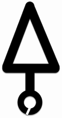

Here’s what I was envisioning for a more ergo handle:
I’ve been thinking about that ergo/triangular handle a bit more. I’m OK with the big pointy bit at the front, but am wondering about the issue of knee strikes on the corners back by the seat. That could be painful. Thoughts on that?
On a 36er I wouldn’t worry about it. Actually, it seems to me that on pretty much any uni you should have the seat high enough not to hit those with your knees. People don’t have problems hitting their knees on the saddle bumper.

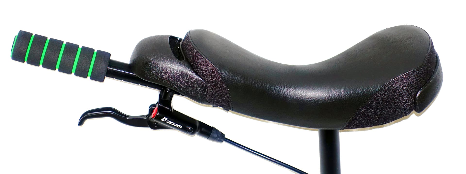

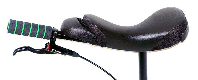

The ONE4ALL Unicon Handle
Only 100g
You can mount the Brake under the saddle handle or in front of the saddle handle
https://www.einradshop.ch/einrad-kaufen-schweiz/einradsattel/1731-one4all-unicon-handle.html
