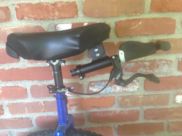

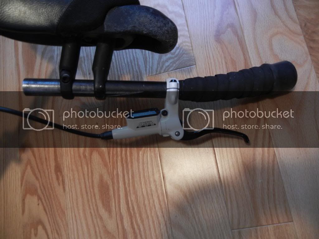

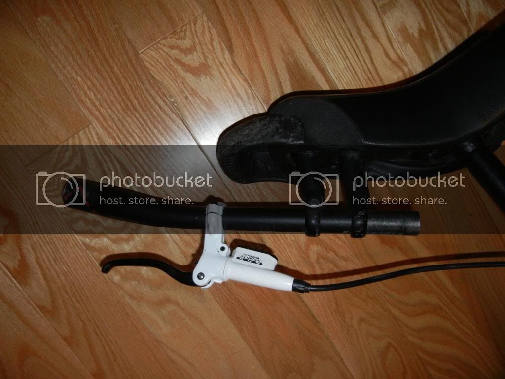

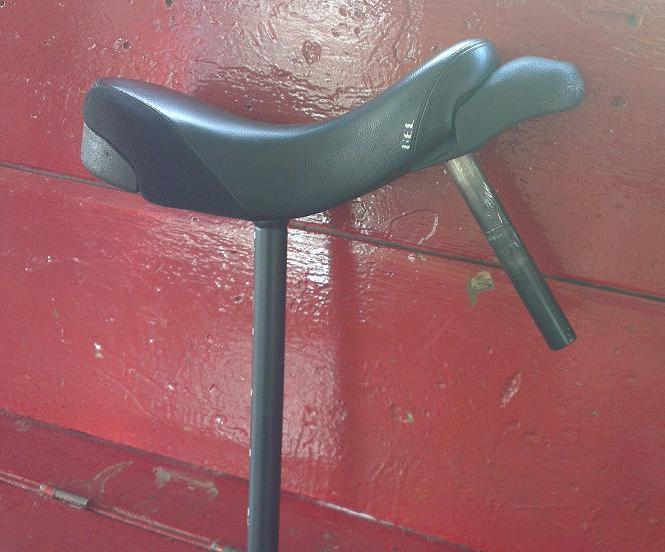

Custom KH T-bar without the T

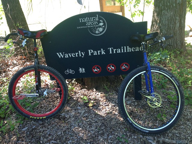

Pictured here are my Oracle 26er with a Nurse Ben custom grab handle and my KH 29er with a KH T-bar.
Here is a before and after of the KH T-bar. The before picture has the T-bar in place (sans bar ends while tinkering). It’s difficult to tell from this angle but I have narrowed the T section as per Kris’ recommendation but I still felt like I might (and often did) get tangled up in it when I UPD off the front. Also, I like the placement of the ergo grip so much (closely replicating my NB handle) that I rarely found myself using the bar ends out on the end except for those few XC stretches between singletrack which is surprising because, on my 36er, my left hand rarely leaves the bar ends of a fully extended Shadow Handle. But, that is on the road and my 29er (with and HD on a 47mm wide rim) does not see much road action. It is my favorite MUni (until I get tired and grab for the 26er).
Here is the after picture.
I sourced cheap $5 straight 12" piece of chrome post from my LBS to replace the T-Bar. I put the other of the pair of field hockey stick end bulbs (the first having been used on my NB handle) on there and I really like it a lot now that it is paired with a NB ghetto flat saddle though I was beginning to get along with the brake lever under the saddle with the built in handle. I found myself doing a lot more hands free riding which can also be great fun.

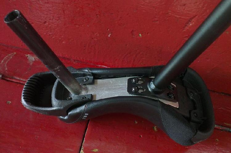

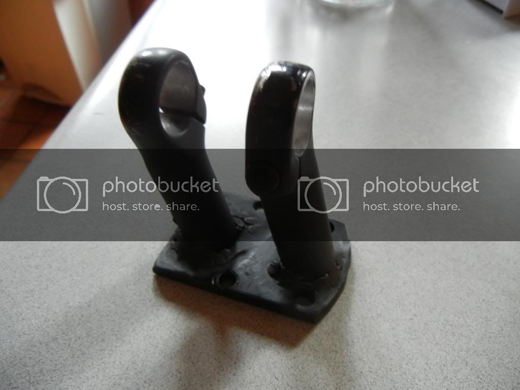

Just to add a twist to the pile of good ideas here… I liked the design that Tirving/Brycer1968 had due to the adjustability, the fact that it uses ā€œnormalā€ tubing which gives more shape choices for the handle, and the greater stiffness. However, I don’t have the fabrication skills (or time/patience) to make all the pieces.
For simplicity, I really like Nurse Ben’s design using bar ends and a post. However, I tried that and didn’t like the downward curve of the bar end that was necessary to protect my brake lever. That made my wrist sore after a short ride.
So, stealing liberally from both ideas, I put together a hybrid setup:
Instead of a single post like Nurse Ben’s, I went with two for greater stiffness in all directions. Instead of Brycer’s seat clamp on a tube, I used the bar-end clamps themselves. I drilled two holes in the base plate (Aluminum, so I could use spade bit drills made for wood. A 7/8" drill was just the right size for the free bar ends I found.) Then, I could weld the bar ends from both sides. I use the term ā€œweldā€ loosely, as I am just learning, and my welds show it!
Now I can mount it and slide in sections from any handlebar with any shape I want. It’s length adjustable, and I can rotate it to change the direction of the bar curve as well.
A little bar tape recycled from my bike bars, and a cap for a kitchen stool leg, and we’re all set!
The best part is, the whole thing cost me less than 5 bucks to make with some scraps I had lying around and a free set of bar ends from the local bike collective. :smiley:
To all who posted on this thread, thanks for the ideas. Happy riding.

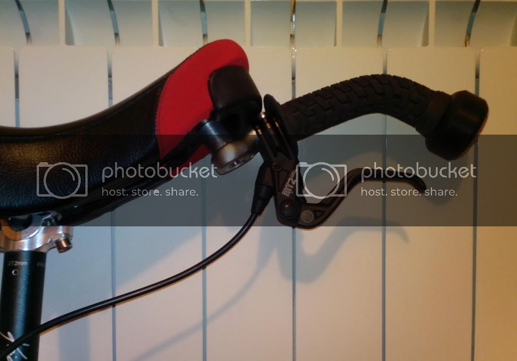

My attempt to custom MUni handle.
Tried several bar end shapes (short, long, etc…) but found every of them to be too short on the part where you rest your hand. Also some brake lever (almost every one I have) get in touch with the bent part of the bar.
So I modified a bar end using a milled ergal extension (approximately 30mm long) to obtain a longer bar end in the middle section.
As a front bumper I used a modified skateboard wheel :smiley:
Still need to deep-test the handle but for now seems to work very well.
First review! It’s awesome! I’m glad I made it. The brake lever is a little bit far but I think all it needs is an adjustement. The grip is amazing, the position is perfect. I changed the grip for a shorter one (100mm instead of 130mm). I even have enough space for both hands on it when I ride on road!
