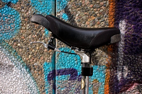

I got a friend with welding equipment to add some cantilever brake posts to my steel Nimbus Muni frame:
Like tholub points out most V-brakes will not clear the larger Muni-tires. This was the case with my 3" Duro and therefore I went with cantilevers. The fact that they stick slightly out beyond the frame has not been a problem so far even though I was a bit skeptical at first.
The wire goes up to the saddle, makes a U-turn at the back of the saddle (lightly held in place by a small piece of zip-tie) and ends up at the handle. The relatively tight bend does slow the cable movement somewhat, but when braking I pull extra hard on the handle anyway…
slick cable routing! do the canti’s clip your heels?
