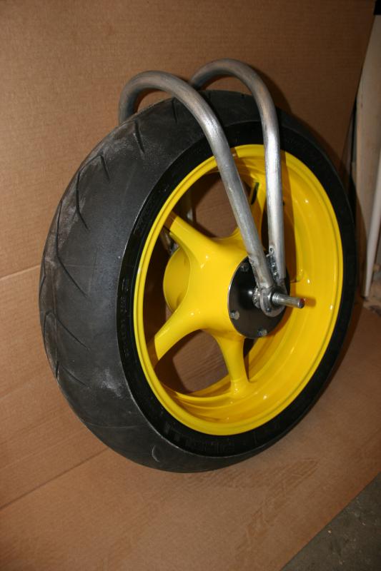

Hey everyone, I am an old uni rider from way back (70s) and the bug has bit me to get back on again. Bit older now and need the excercise. Have been looking around at all the different makes and models out there. Way back when it was a Schwinn 24". I decided to build my own. I have started out with a used Yamaha R5 rear tire and wheel and have built from there. Kind of desiging and building as I go on. I think I am to old for the trials riding or freestyle, tho I would like to try both. So I am going for the cool factor. Will post more as the project progresses. Sorry about the sideways first picture. Not to sure how to change it. Steve-O

Sounds HEAVY, Looks COOL!
you’ll have to post the weight when its finished. Looks like a cool uni.:smiley: Also Is it isis or splined or square? In the pic it looks isis but Im not sure.
It is going to be a bit heavy. I am guessing 30 pounds or so. But I figure its more for straight line riding. Right now I am going to use the cranks off my old Schwinn only because I have them and the seat. I will have to get a seat post to fit it. Should be a head turner. Steve-O

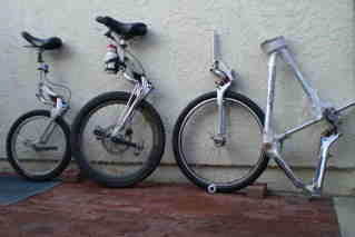

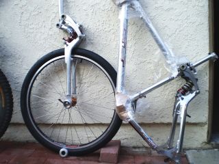

One suggestion. Be lazy like me and use already awsome premade bike pieces cut off the frame, (seat post, clamps, mounts, bearing holders, etc…)
Welding it together looks well within your range, be inventive steal ideas and great looks.
I like your ideas. Having a hard time finding steel tube that is the right diameter. Gotta go out and hunt up some old bikes. Are thoes unicycles you made? Very cool. Like OCC Choppers, I may go with a theme cycle.

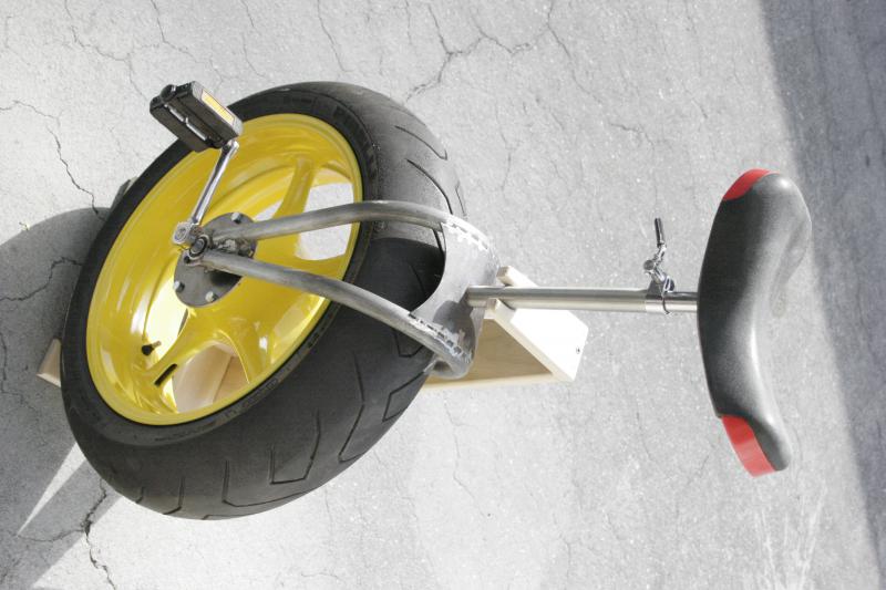

Latest Update: I have everything tack welded and the cranks and all installed. I hope to have some pictures tomorrow. As of today it weights 35 pounds, which is not to bad. I figured it was going to weight more than that.
I was not able to try it out as the the collers that hold the shaft are slipping. So I need to dimple the shaft a bit. Keep checking for updated pictures.

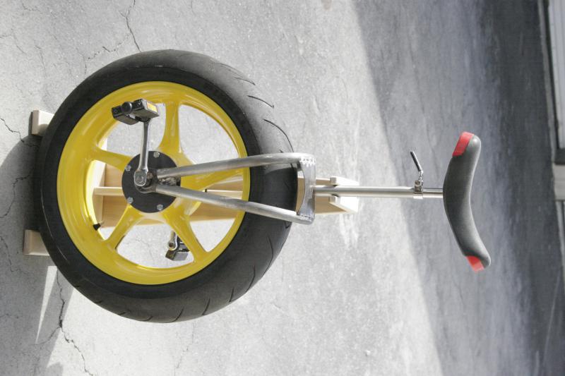

Latest Pictures: I was able to get it all together and snap a couple pictures.
As I posted yesterday, it is 35 pounds. I still need to dimple the shaft for the set screws. Tried to get on it and the shaft spins even tho I have it tightened as much as I can. Still have some grinding to do on the welds and some bondo work to smooth everthing all out. Not sure about the paint. Kind of has that " Mad Max" look about it. Any suggestions on the paint?
That looks AWESOME!! btw, nice stand. I would clear coat it.
