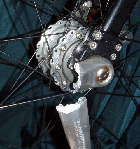

Heading down Clerkenwell Road, I was approaching some traffic lights that were about to change, so I had to speed up a bit to get through. Just as I got to the other side I noticed my right foot felt a bit wobbly. If you’ve ever had a loose crank, bent pedal spindle or pedal bearing loss then you’ll know exactly the kind of feeling I mean.
So I stopped ASAP and took a look. I waggled the pedals but the felt ok. Wiggled the crank and there was a bit of movement. Was that it? Ah, no, it’s a Schlumpf, so there’s always a bit of play. Tried wiggling the crank in relation to the opposite one and it was solid. With the uni upside down I ‘rode’ it with my hands but couldn’t feel anything out of the ordinary. Maybe I’d just imagined it. I’ll jump on and carry on home.
Strait away I notice that something really wasn’t right at all. So I hopped off and took another look. This is what I saw;
Now, I don’t do trials. I don’t hop, and, apart from the odd kerb I drop down, the thing almost never leaves the floor. At 13 stone I’m not exactly a real heavy weight. So, I long ago resigned myself to never being able to tick the box on the unicycle quiz to say that I’d broken a crank. But there it is.
I know that when I’m in high gear it does feel like I’m pushing very hard on the cranks, and particularly when I change up it can be a push. But I really didn’t expect it to go like that.
So, all you non-splined Schlumpf owners out there, are there any particular brands of crank that you recommend? I’d guess ones with very low Q factor, but I’m just wondering what works well for you.
STM - gutted to be losing almost a week of RTL training :frowning:
I wonder if hard knocks from UPDs caused the initial crack rather than just regular hard pedaling. Then once the crack was started regular hard pedaling could have made it bigger till it became noticeable. The anodized coating could have covered up the crack (or manufacturing defect) during the initial stages so that it wouldn’t have been noticeable by casual visual inspection till it got to the point where the crack expanded and became very obviously noticeable.
You ought to see if Florian wants you to send in the crank so he can see if there was possibly some sort of manufacturing defect (a void in the metal or something).

It could have been there for a while I suppose. I’ll admit that I’ve never really inspected the cranks for things like that - but then again, I’ve never felt the need to. Although I’ve had several UPDs, I can’t remember any that would have been particulaly harsh on the pedals, although I’m normally paying more attention to how I land than what the unicycle is doint!
I’ll send Florian an email anyway as I expect he’ll be interested to at least see photos of it, and possibly post them if he wants.

Mine did exactly the same when I was in NZ. I think it may be a warranty thing, but you have to wait for the part to come.

Yup, that does look like exactly the same thing!

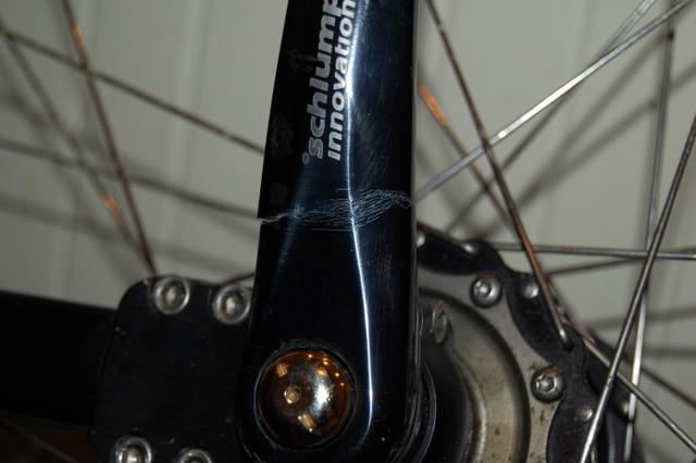

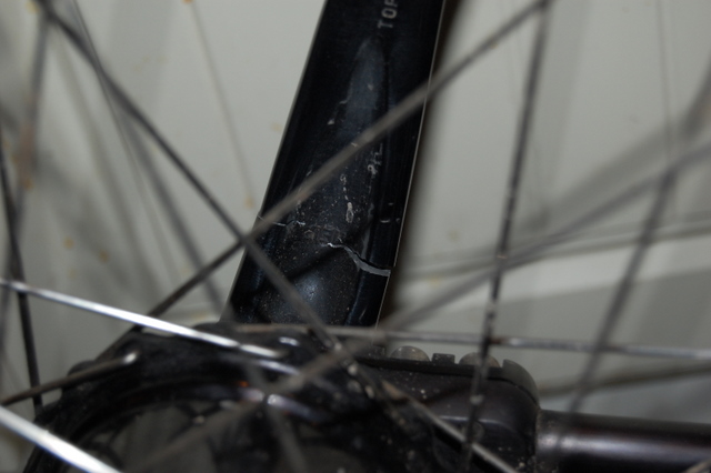

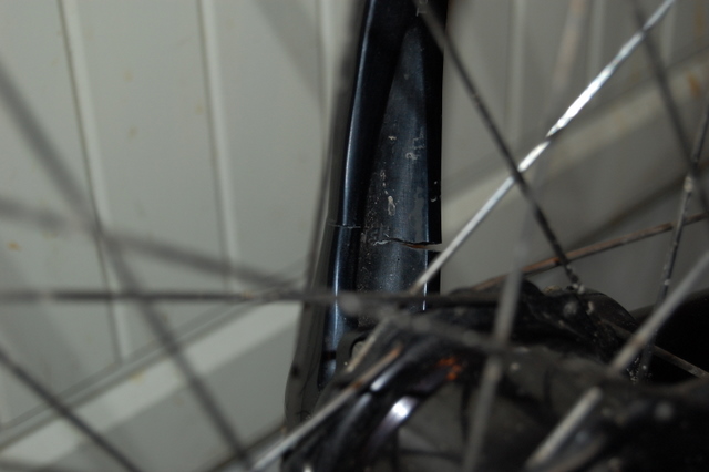

Well, at the weekend I changed the cranks over. Of all the unicycle related scary things I have ever done, I think that changing a Schlumpf crank is the worst. Tightening the crank extractor in to the adapter which then goes in to a finely crafted and delicate mechanism was bad enough, but the pressure I had to put on it to actually get the right crank off (the left wasn’t so bad) will give me nightmares for months to come!
Anyway after close inspection of the left hand crank, I noticed that there’s a crack appearing in that too in exactly the same place. Florian has confirmed that there was a dodgy batch of 152mm Schlumpf cranks about 2 years ago and is sending over some replacements. If you are riding with a set of these, I’d suggest you give them a careful inspection soon.

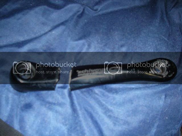

One year old and here’s the pic.
I was climbing a moderate hill in 2nd gear, then I felt a wobble for a 1 second, then upd. Landed on my feet so I’m okay.
Since I had the Schlumpf, I put a few drops of oil in the hub and that’s it. I never touched the cranks bolts. But a funny thing; I just got a torque wrench for christmas.
Where should I get new cranks?
You can either get the same schlumpf cranks at http://www.schlumpf.ch
Or You can try out some ProWheel cranks.
You probably want to get a crank with some Q factor b/c if you are using a crank with no q, you increase the chance of an accidental shift.

If you are talking about the dual drilled KH moment 125/150 cranks…they will not fit on your schlumpf hub. You have the square taper road schlumpf hub, not the KH/Schlumpf muni ISIS hub (by the look of the pic in your thread).

Emailed schumpf to see if I can recall the hub. And/or to order new cranks but no response yet.
