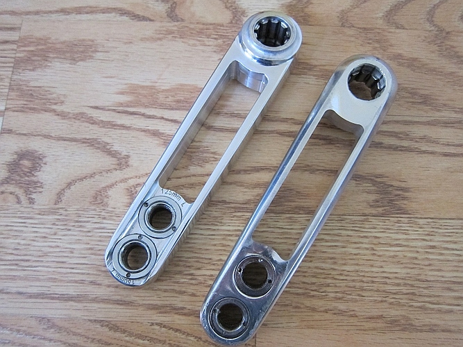

@muniorbust: fancy posting a pic of your machined moment cranks?
Mark
A friend of mine milled my moments. I gave him a picture of KcTheAcy’s milled cranks from this post.
He took out even more material, which makes me nervous.
I don’t care much if they break, especially with Moments being $50 now, but I don’t want to get hurt.
Looking at the picture makes me more worried than in real life. But they’re still pushing the limits more than I’d like.
What do you think?
WOW! yeah he really went to town on them didn’t he! :astonished:
I guess we won’t know until you get out there and ride hard on them for a bit. Once I decide on what crank length I want to have on my new G26er (tossing up between 125 and 137mm but will test both out in the next few weeks) i’m going to do the same thing. I think i’ll get the machinist to leave an extra 2mm on each of the sides and maybe even a small cross beam in the middle of the cut away.
I hope they hold up for you!
Mark
I have a unicycle that was close to 9kg a few years ago and is now under 6kg. The only part that is the same is the hub… On another unicycle I just swapped a 1200g tire for a 1860g tire
light weight is great for most stuff but having that extra bit of momentum can help in other situations.
EDIT: thinking about the forces going into cranks I think you should be OK as long as you don’t do a bunch of crank grabs and dent one of the sides.
