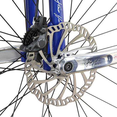

The disk-mount crank system has to be on the right side, because the rotor has to be to the right of the calliper. The only way to put a crank-mount system on the left side would be to flip the frame around so that the calliper was on the forward side of the frame. Personally if I was doing a lot of trials on my KH24, or if I regularly sent my unicycling tumbling down the hill through rocky terrain, I’d probably stick with Magura rim brakes. But for trail riding, so far I’ve never damaged the rotor and have no reluctance using it. Plus if it is damaged it is not really an expensive replacement and is available at any bike shop.

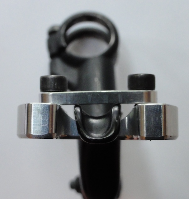

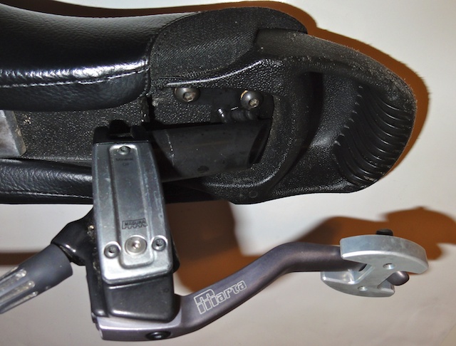

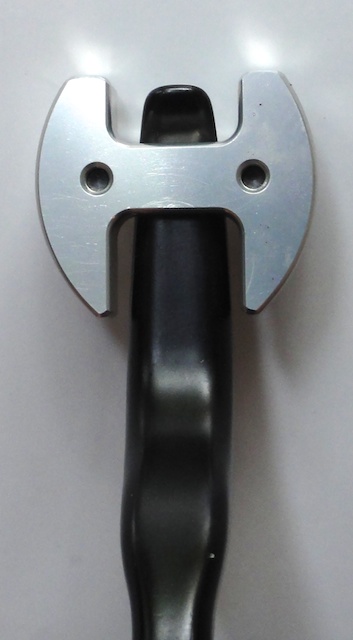

Attached are photos with the Starfighter installed on a Magura Marta brake.

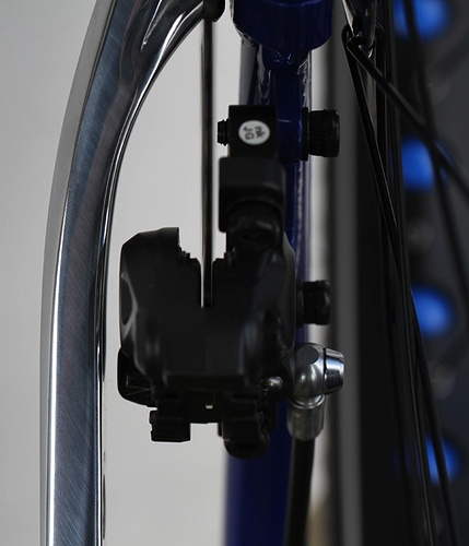

IS disk mount on the right fork blade

Oh no, you’re right and I can’t believe I didn’t notice that. I had someone take those photos in Taiwan, in advance, and it looks like they put the wheel backwards in the frame. Classic mistake =(. Will fix that as soon as I can get new photos taken.

Here are photos of a Shimano SLX brake with 180 mm rotor, installed on Spirit Cranks. You can see what I mean about it being challenging to get the design right in the tolerances (spacing) to fit the rotor and clear the crank, frame and spokes. Photo is courtesy of Roland at municycle.com
