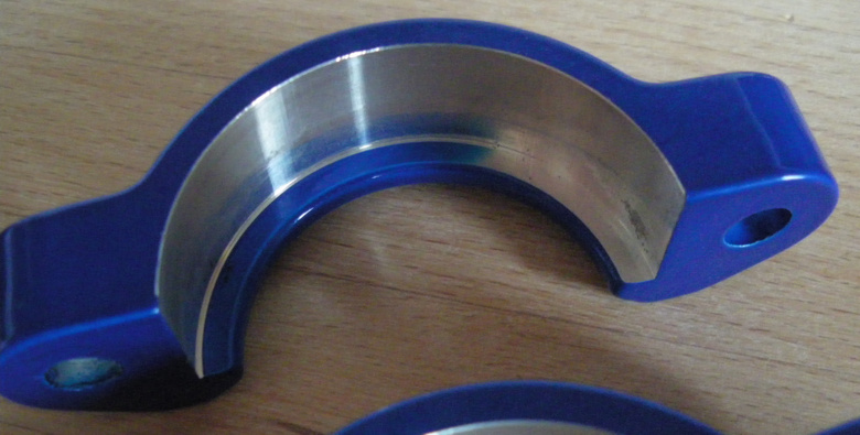

Bearing holder changes?
Does anyone know if Kris changed the design of the removable bearing cups on his new frames to remove the inner lip? My 2 new frames both shipped with removable bearing holders like below (no lip), but the frames bearing cups still have the inner lip like normal bearing holders. I know he reduced the outside edge of the bearing cup by 2mm, but he never mentioned anything about the inner lip… :thinking:
I’ve emailed him to check, seems a little strange to have the lip on one side of the frame and not on the other…??? :thinking: I’m a little hesitant to put my schlumpf in my new 36er frame until I confirm if the bearing cups are indeed meant to be that way…
