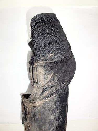

I completely forgot to mention about one more upgrade: Percussion Armour now has moulded hardshell knee protection, underneath stretch-nylon/kevlar. I don’t have good photos yet, but see the attached (slightly muddy) photo.
This narrows the profile of the armour even further (because the knee cup is curved) and increases the level of impact protection.
This upgraded armour has already arrived in Europe, North America, and Korea, and will be in Costa Rica soon.

Kris, is this the same new and improved Percussion Armor that I bought from UDC last month? I have the original, the improved version I bought last month, and am hoping that the improved is the same as what you are now announcing.

If it has a molded knee cup with stretch nylon on top, then it’s the new version =)
:smiley: I see now the old were 1100 denier ballistics and the new arm and leg are 1200 denier ballistics! I have both and am good.
