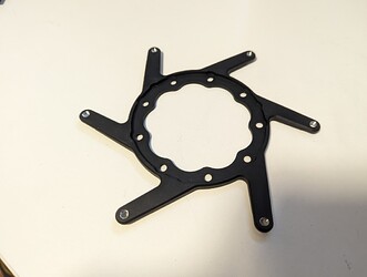

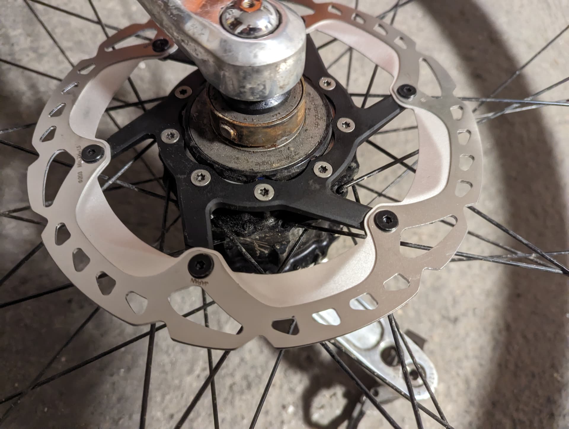

This meant I had to find a solution myself. I knew about the Breakfast adapter and tried to design something similar. After I was satisfied with my design, I ordered this part online for only $53.36 (including shipping).
Here’s the final solution:
I’ve been riding with this setup for half a year now (since February 2025), and I’ve never had a problem with it.
If anyone is interested in more details, feel free to ask.

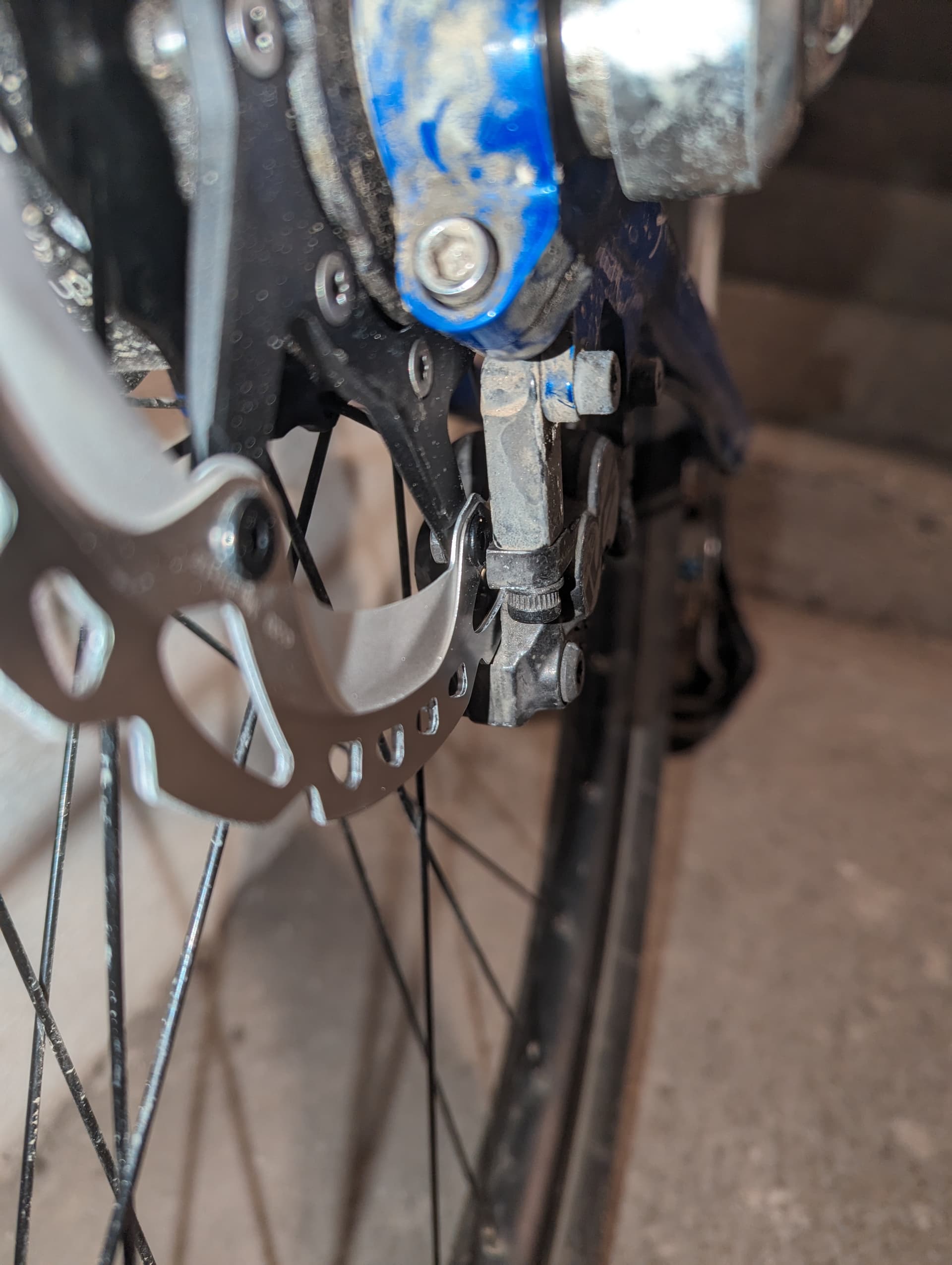

Which brake caliper do you ride? Have you ever had conflict between the caliper and the screws?
I use the Shimano Saint one. I had to file a bit of the brake caliper mount (maybe 2mm), but not the brake itself. The screws have the thinnest head I found.

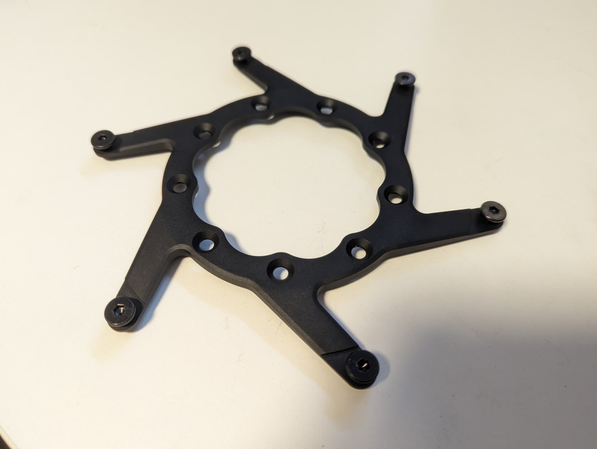

That is very nice. I can understand for the screws, I couldn’t find anything thin enough so I had them custom made for the Brakefast adapters hahaha.

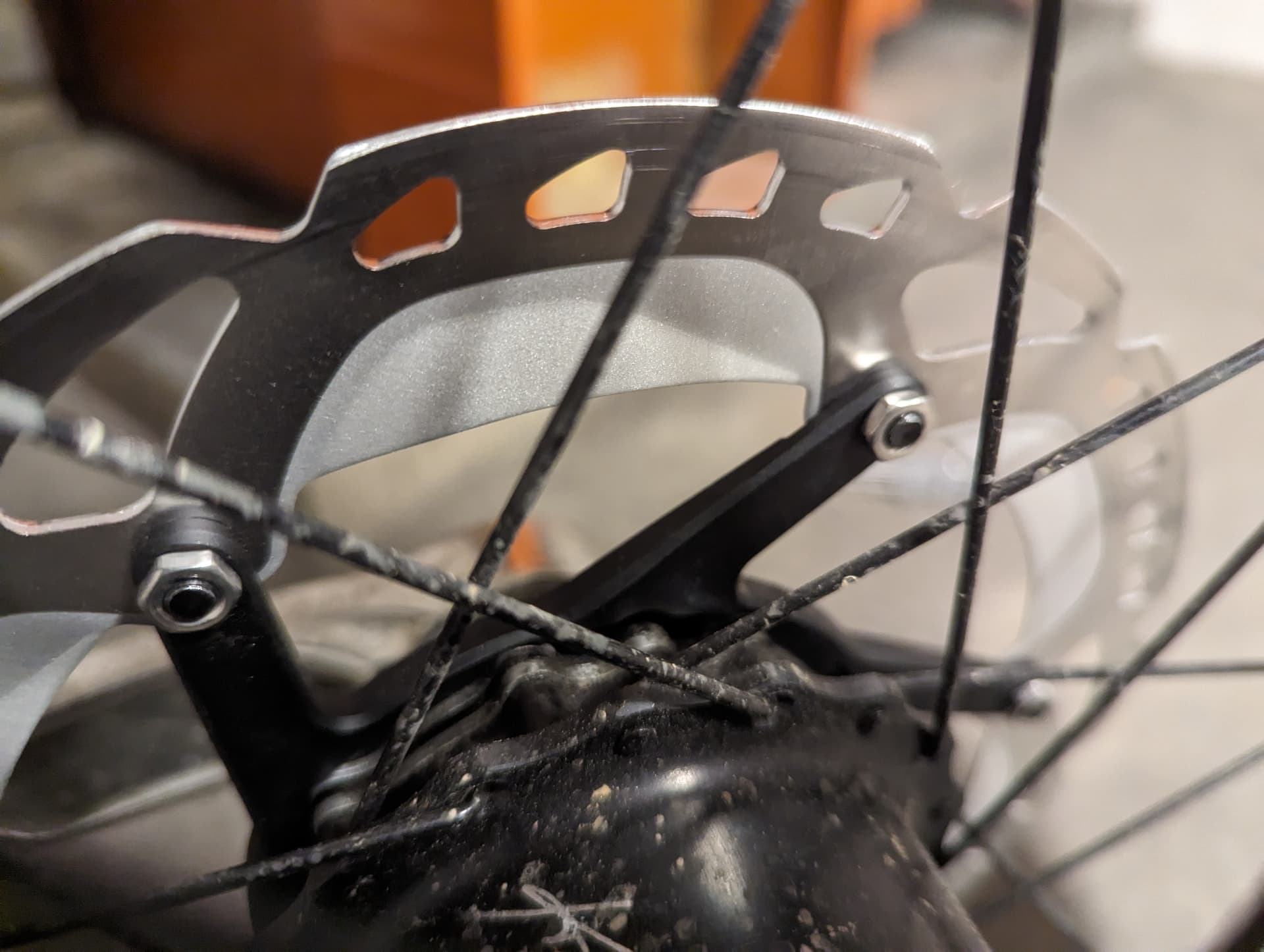

The black arms have threaded screw holes, but there are nuts added on the back. Why are the nuts needed?
I’d say as counter nut, because there isn’t that much thread in the black part.
The head of the screws I found is 1,4 mm thick. Your custom made Screws are probably even thinner than that.
The thread in the aluminium is just 3 mm thick. I added the nuts just to be sure they don’t get pulled out. Although this adapter is made of 7075 aluminium, a M5 thread has less then four full turns in 3 mm material.
Maybe these nuts are not necessary, but I didn’t do any simulations or calculations on that. So I feel better while riding to have them. At higher speeds it could end badly if the rotor gets loos.
