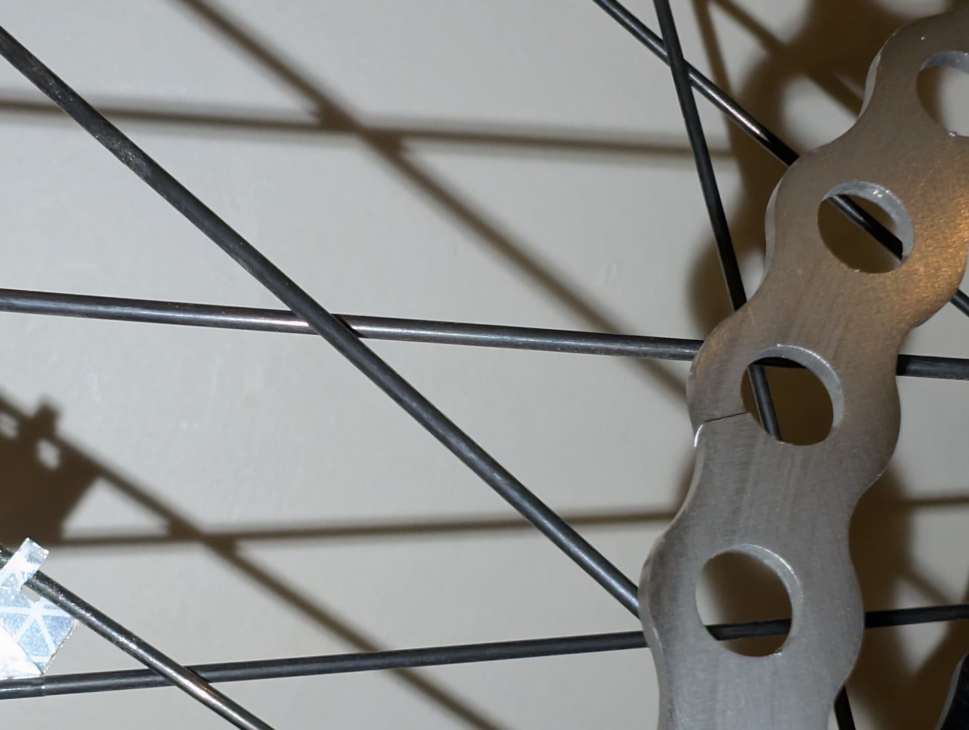

Well, I have a bit of a disappointing update. I went for a ride today and while braking I heard a loud snap. I dismounted and looked over my uni but didn’t see anything. Upon returning home I gave it a closer inspection and found my disc rotor has cracked.
Using an adjustable wrench I was able to seat it back together. But seeing as how this was already my second rotor (the first was warped and adding spacers only made it worse).
For reference, I have one set of spacers between the rotor and hub.
