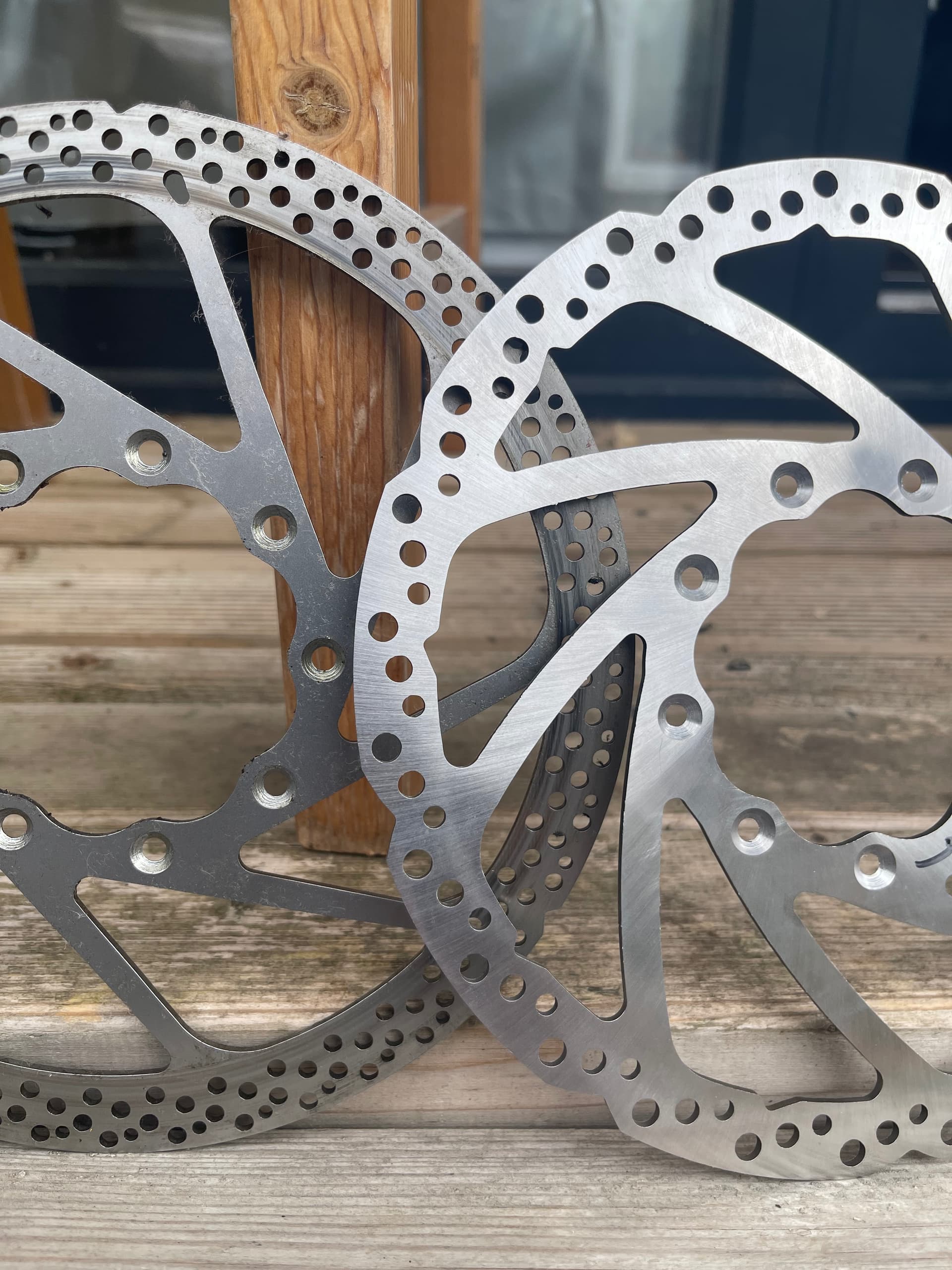

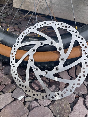

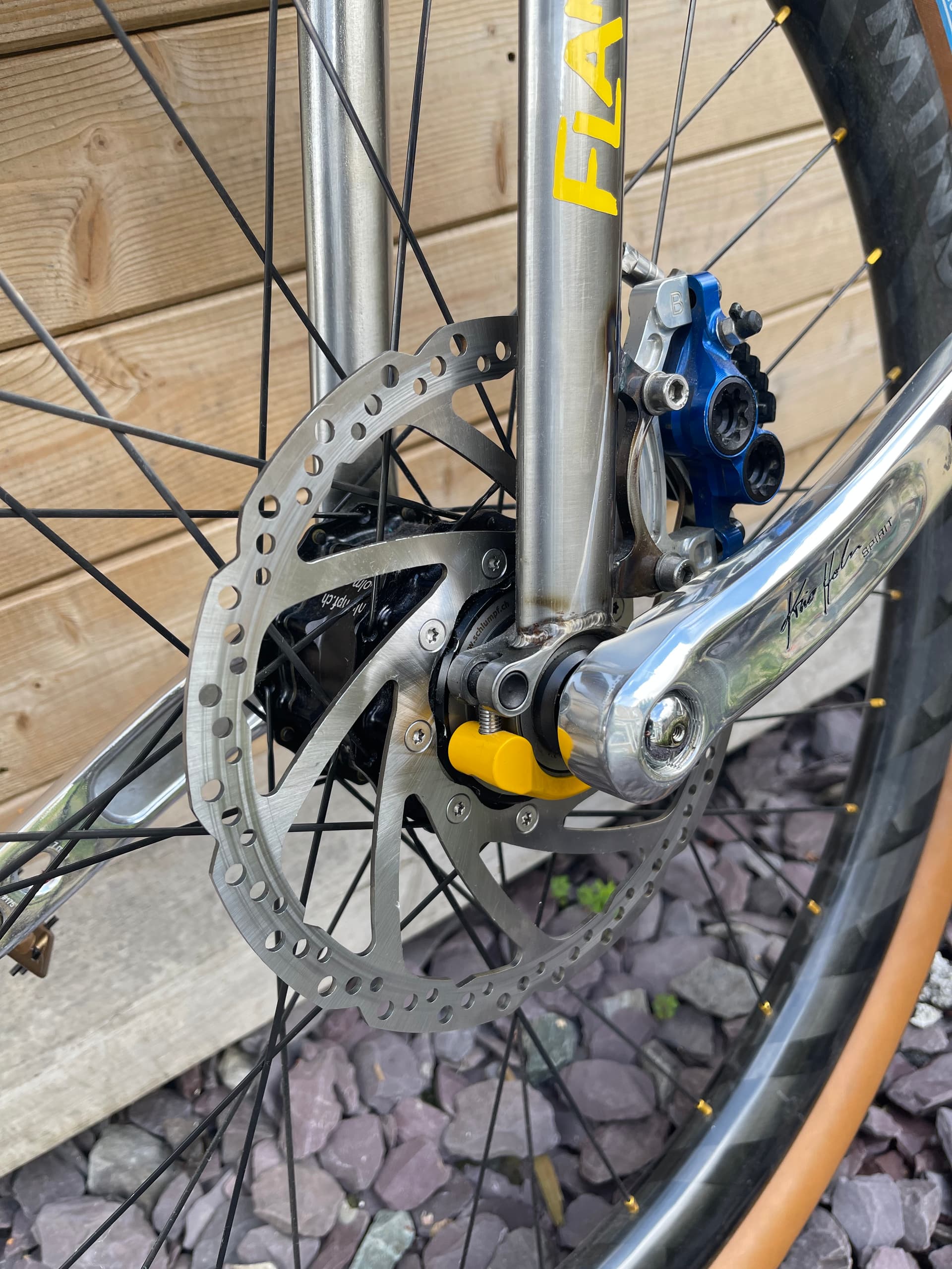

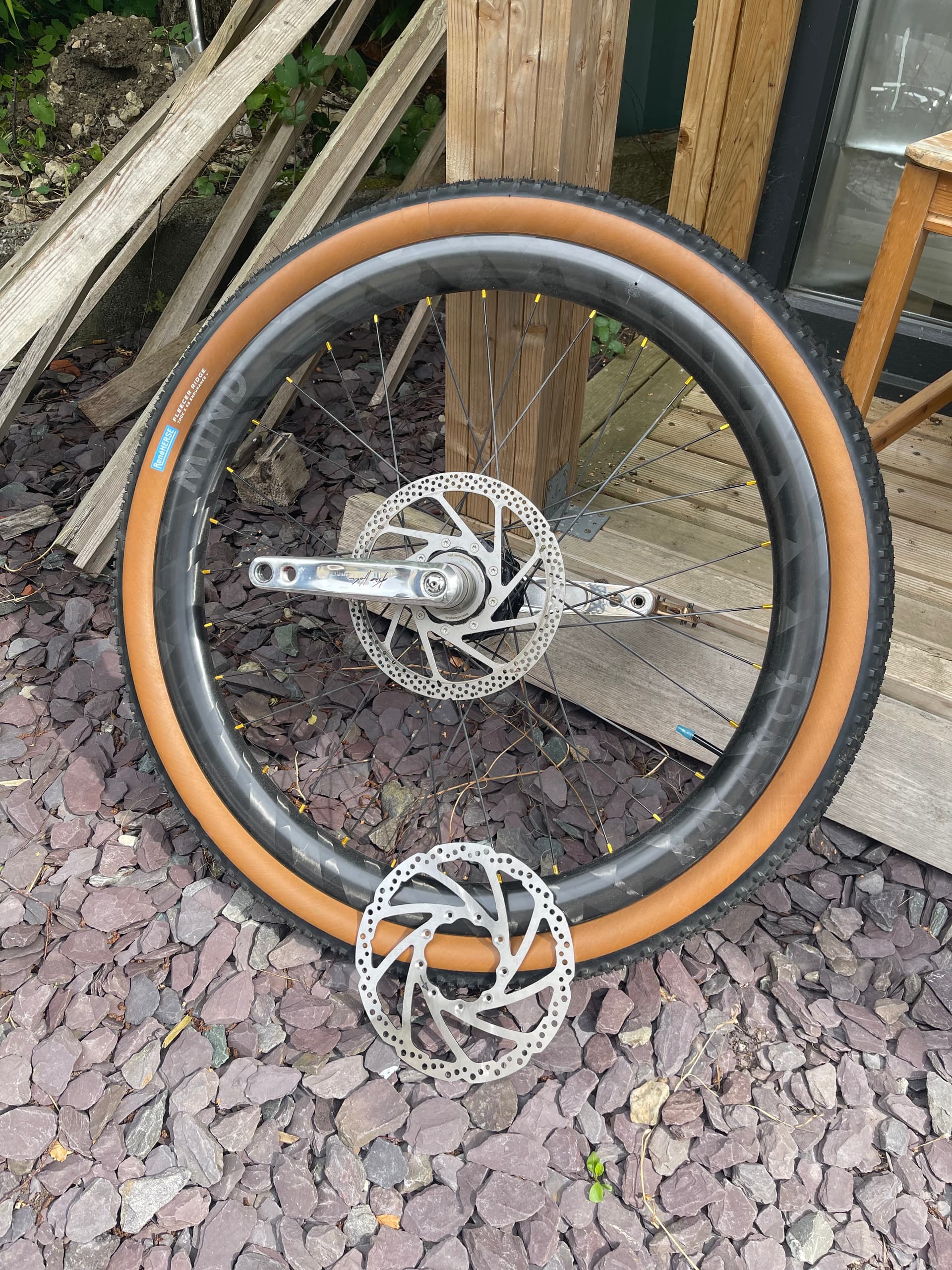

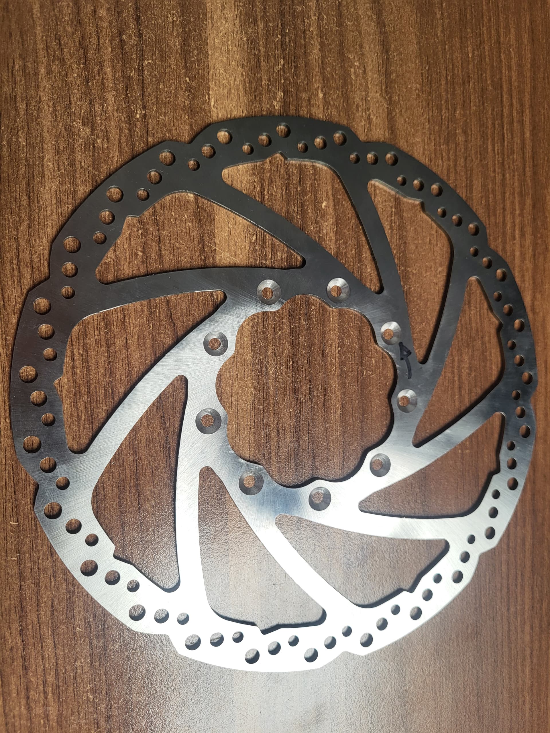

So it’s here and it does look pretty amazing. A Hope rotor for a Schlumpf. Funny when paired with a Hope brake.
It is however a tight fit - much like my BrakeStuff ones were. But this means we will need to file down the tips of the hub interface area:
A hand file should be all that is needed and we just need to remove a small amount all round or possibly from 3-4 tips. I’ll report back when I’ve done this and have it mounted.

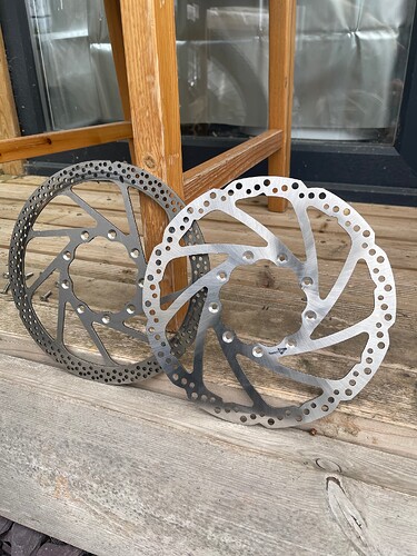

It’s a heavy piece of metal and speaks of robust quality. The finish isn’t as nice as BrakeStuff. That’s been sandblasted and has a lighter texture. But it’s from Hope. So they know what works.
That’s what you get when you all wish for 203/2.3mm instead of 180/1.8mm :rofl:.

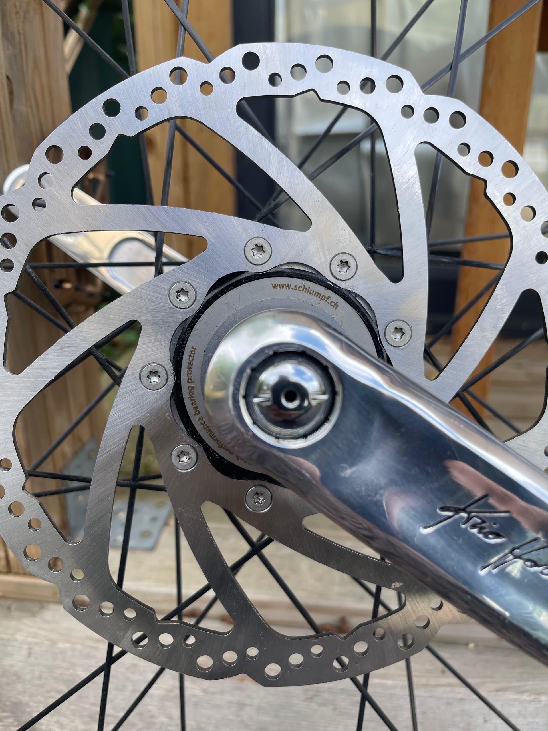

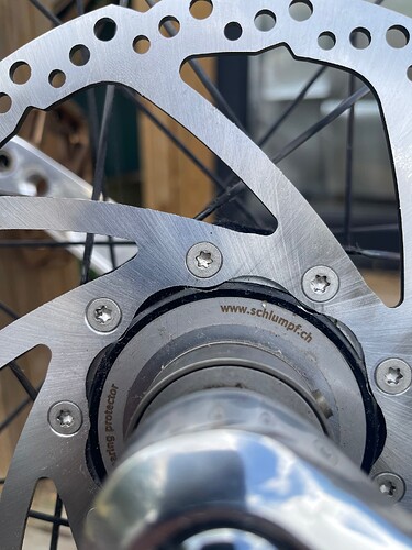

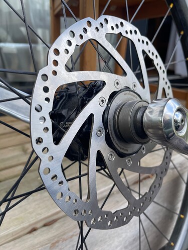

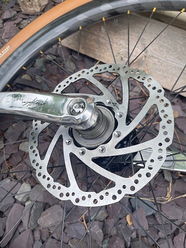

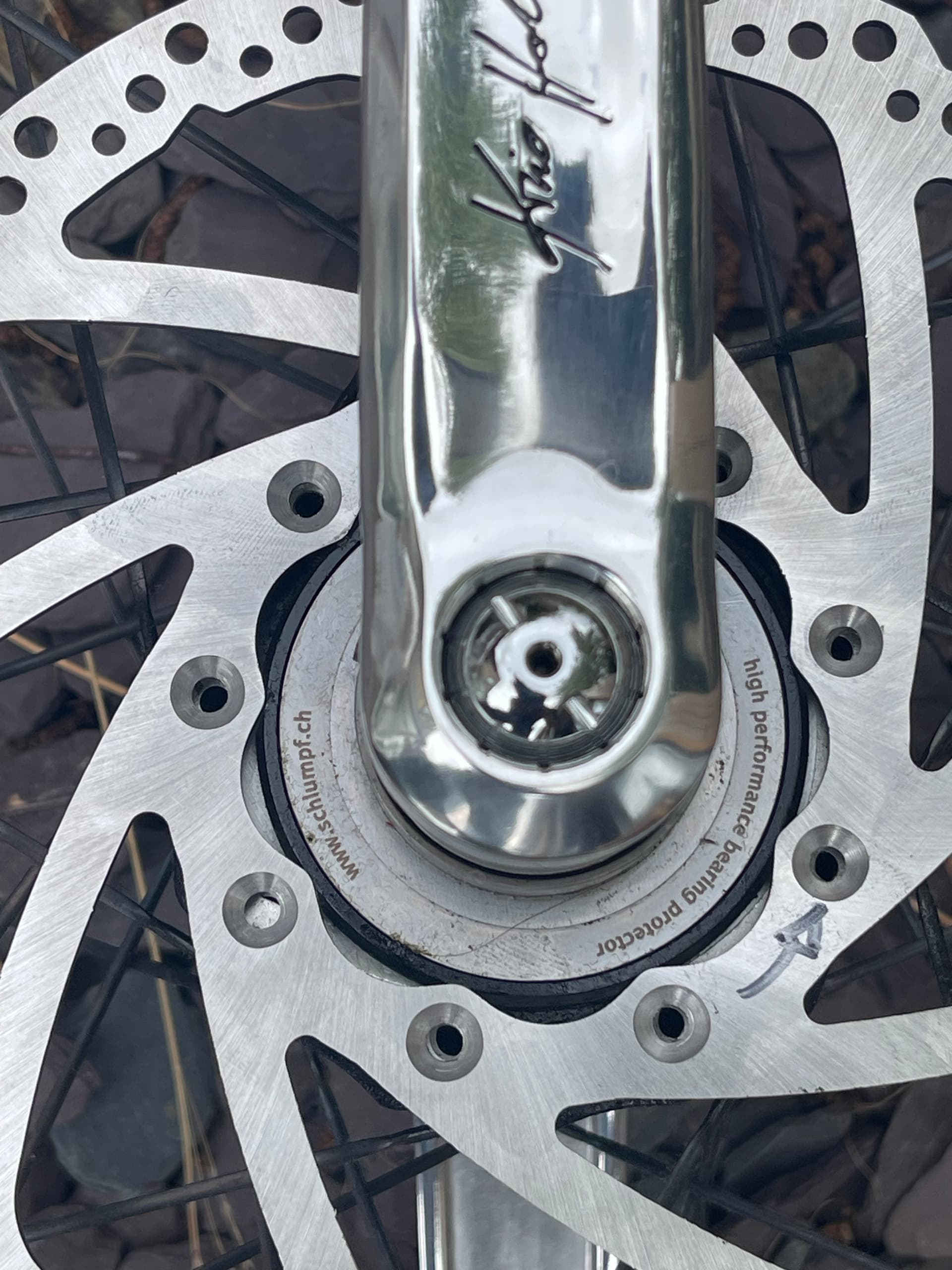

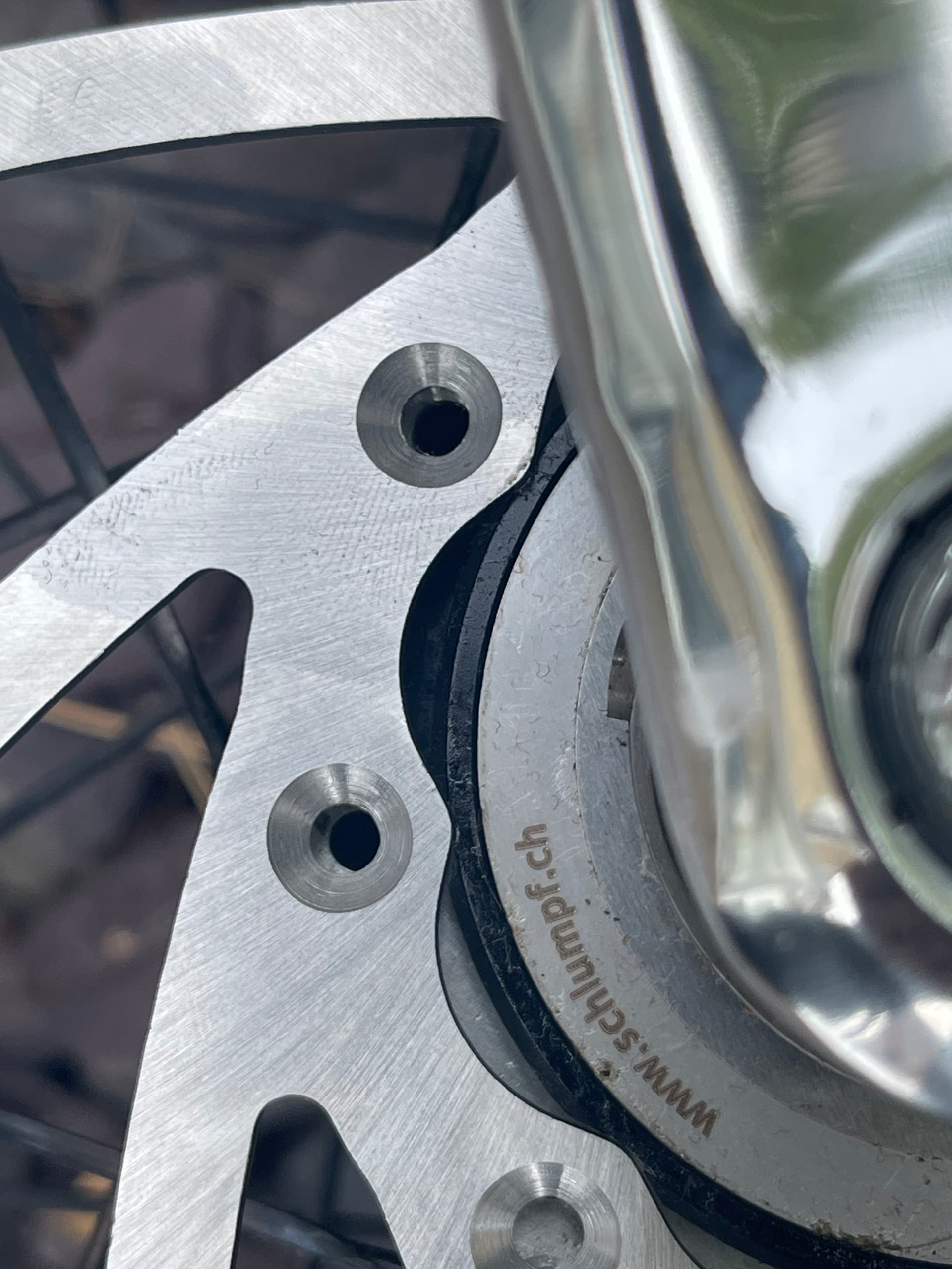

It fits! @rogeratunicycledotcom
After a good bit of elbow grease on filing the high areas down. I may have gone a bit further than I needed in some parts but it fit on without any friction or forcing needed and locks into the notches well.
Putting some air back in this beast and taking it down the road and back to finally get a feel for it.
Rotor seems like it will offer the same braking quality of the BrakeStuff or better.
But the oil on the rotor issue is still a real one. The old rotor I pulled off was very greasy - both sides.

Does someone even know in the first place why the rotor and the hub have this wavy inner interface? This is not something I have ever seen on other rotors/hubs and it doesn’t really feels necessary provided that the screws are tightened and glued with loctite.
I think there is merit in this interface design. Mainly due to the fact that this hub is looking to support braking when in high gear so I presume the forces on the rotor are greater than that on non-geared unicycles.
I also spoke about this design choice to Roger the other day and he mentioned that motorcycles’ hubs have this kind of rotor interface… so of all the possible failings that Florian may have made with this rotor set up, I don’t think this hub-rotor interface choice is one of the areas.
Apparently even well tightened bolts can get weakened by slight vibrations and over time break. I think this interface may help that kind of stress from happening.
Don’t rotors on bike support much more forces than on unicycles? Although a single brake has to stop us unicyclists, we go way slower than bicyclists and they don’t have this kind of interface.
However, I kind of recognize one merit: if screws loosen, the rotor doesn’t move. It happened to me because I forgot to put threadlock on them and I was happy the rotor didn’t move and the screws didn’t break. But that should not happen in case of a correct setup.
