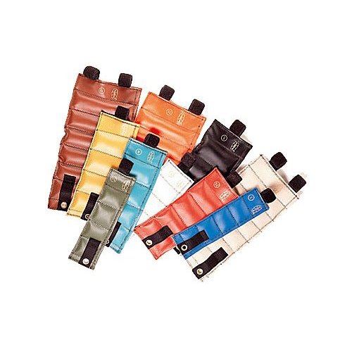

But what about a 36 commuter ? I got this idea with these wrist weight straps someone left in my yard. They look like the picture. Together all 3 weighted 4 lbs. I strapped them around 3 spokes and tightened the Velcro, right at the rim. There was 9 spokes between each of the weights, to achieve balance. Installation time, 3 minutes. :slight_smile:
I have just came back from a 2 hr. ride. I fully expected this to be a bad idea, but it was free and easy, I couldn’t resist just seeing how bad it was.
Actually I like it ! It was very much like an unweighted wheel. I got used to the slower turning pretty quick.
There was some very real advantages. I could ride faster with less concentration. Hard pedal inputs have less effect. The uni tracks straighter. Balance, no doubt due to the gyro effect, was helpfully improved. I could easily ride with both hands on the saddle, something I never much tried before. It had the effect of transforming me into a smoother rider who could pedal harder and straighter with less effort, and better balance.
I’m not saying this is for everyone, but 36 riders, and maybe 29’ers might like to try this. I’m going to leave the weights on for now. I’d try more weight if I had them !
I guess I’ll go to more fat girl’s garage sales. :slight_smile:

I want to emphasis that I only tried this because it was free and easy, not because I believed it would a useful mod. So I sorta expect others to be skeptical. I was surprised at the results.
Acceleration was about normal. I’m about 180, the uni was 17 lbs. before I added 4 lbs to the rim. So I figure the extra 2 % mass I need to accelerate is unnoticeable in practice. Anyway, it starts and stops about the same as before. I don’t have a brake.
I think that the most positive effect of the rim weights is due to 2 things. A gyroscope like effect that improves balance, and an "engine like " flywheel effect, that requires fewer good pedal strokes to keep it up to speed and aiming straight. The whole rig seems much more forgiving, like riding in a wagon. Corrections that would be needed on a lighter wheel aren’t needed. Hard kicks that would turn a lighter wheel to the side, move this one so little, that the natural tendency is to kick harder.
It wasn’t more tiring to ride. The extra friction caused by 2 % extra vehicle weight was made up by the lack of effort needed to control the thing. My general impression is that this rig is as safe and handles better then without the weights, particularly at high speeds in a straight line. It does have a way of making me pedal faster.
Anyway, these weights can be had for 12 $ / pr. of 5 lber’s. , that can be adjusted in 1/2 lb units. I used 3, but they aren’t adjustable.
I think I will leave them on for now. Maybe buy the deluxe set of adjustables later.
If I really get into the heavy 36 rim concept, I have a better design. I’ll use 3 inner tubes. One will have no stem and be slit all around the inside. This one can be installed into the tire first, with a bit of rubber cement to hold it in place.
I’ll drill a stem hole in the rim 180 degrees opposite of the first one, then install and inflate 2 tubes. This has 2 advantages. The flywheel weight is placed farther from the wheel center, then with spoke wraps. And an edge against punctures. Most punctures would only get one tube, so the tire would only lose 1/2 pressure, and could be pumped back up without first needing to fix the flat.
