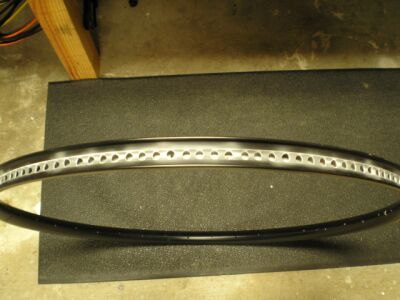

Ken, I just got a new industrial drill press…I’ve made 4 of these so far. Pete
The heavier the wheel the more it will resist change of inertia.
Bad acceleration, but easy to ride along in a straight line.
Wo is that a drilled Airfoil?!

And yes, that is a drilled Airfoil. The stock weights are in the 1300g range, and my best one so far came out to 1026g. After considering how far to go with this, it would take a mill or CNC machine to cut the exterior surfaces (like drilled trials or XC rims), so I won’t be doing that with my press. This method doesn’t sacrifice any strength.
HA! i call BS on that, i bet the double walled AirFoil Coker rim is the same weight or maybe even a little heavier that the thin sheet medal like steel of the stock rim.
I’m sure sombody will post the weights on here, I don’t have them.
..but I will say this. I’ve ridden airfoil equipped cokers side by side with steel rimmed cokers. This difference isn’t even close to subtle. The steel rim is HEAVY.

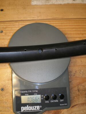

After our last 33 mile outing, I disassembled the Greenasaurus wheel and, among other mods, drilled this Airfoil rim as well (but conservatively), and got the weight down to 1066g. I think a strong sub-1000g airfoil is very possible. I’ll get to work on it.
Pete
