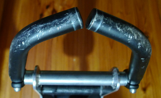

Here’s a photo of my geared KH26 with my handle setup for this particular uni. I like having both handles; I guess you could cut off one of the sides of the bar but it would expose the brake lever and not gain much IMO. Key to this setup is that I cut the “T” narrrower (to 120 mm width); otherwise in such a close and low position it would bump my knees. With that width it also makes it easier to grab the brake (closer to your fingers).

That said, I really like my T-Bar. I’m probably not advanced enough to have throughly tested it while riding, but I’m unadvanced enough to have very thoroughly tested it through many ungraceful falls, smashing it down unmercifully on pavement and tumbling it down rocky slopes. :smiley: I’ve got the 2nd generation, and no signs of any problems at the weld. I switch mine back and forth from trail to road-riding mode, so I have yet to cut it down like Kris. However, I hope to get a second one at some point and will then cut one narrower for xc muni.

Hey Kris, how about replacing the T with a bar end clamp that would hold a u- shaped piece of tubing. This would allow all sort of rotation combinations as well as having the extension and angulation choices using the stock mount.
My current setup is a curved bar end on the t-bar for my 24 guni. It ends up being like a reeder handle. I can grab it on the side or out in front. A short, straight bar end on the other side would complete the loop. On rough single-track, I seem to need one arm free.
Where did you find that super curved Onza?
I used bar ends similar in shape to the Onza, but cut down so I can use both left and right (my handlebar sits a bit further out so there is enough clearance to go wider).
