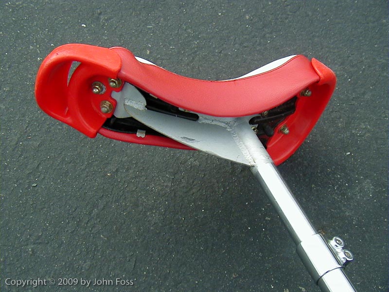

My solution to this in the past, when alternative parts were not available, was to get a gusset welded onto the post. The strongest approach, back in the Miyata/Torker LX seat days, was to extend the seat plate to the front bumper bolts, then attach a gusset under that. But a small gusset can still do the same job on a KH/Schwinn style post. All you need is someone who can weld and a couple of triangles of tough metal (to match what the post is made of). May as well do the back when you do the front, so it doesn’t die that way someday either.
But then the seats will start to break… :slight_smile: I think the new KH seats and posts are built to address this weak area, and will last much, much longer than the older stuff.
Here’s the seat post on my old DM ATU. Steel Miyata post with extra plate at the front and a big gusset. This is overkill, but would be great for someone who does nothing but Trials or big jumps/drops.
