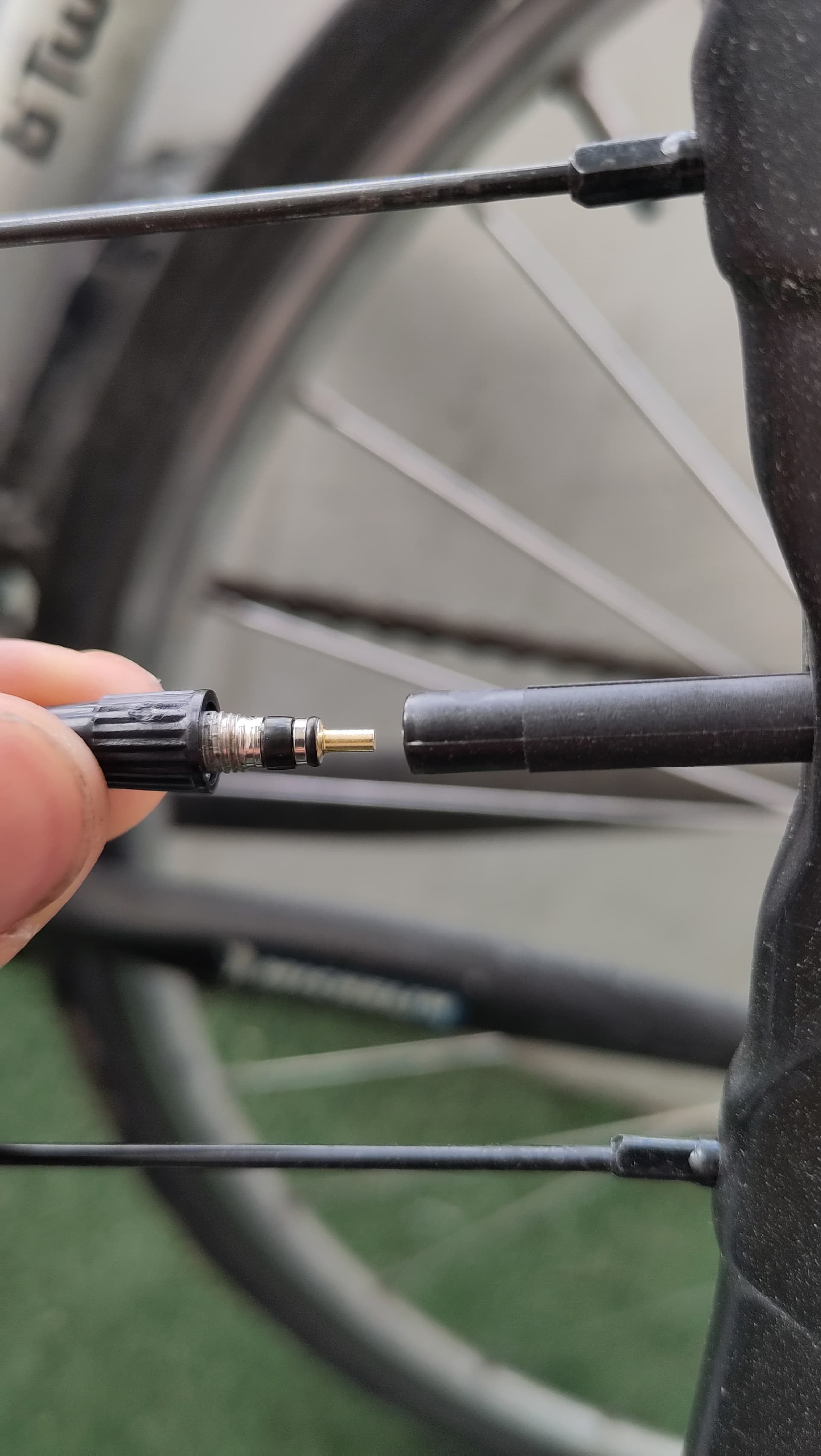

Any bad point? Yes. But… Not a too bad one. After having inflated the tube, the core can come with the pump. It is easy too replace, but you’ll have to re-inflate your tube again :wink:

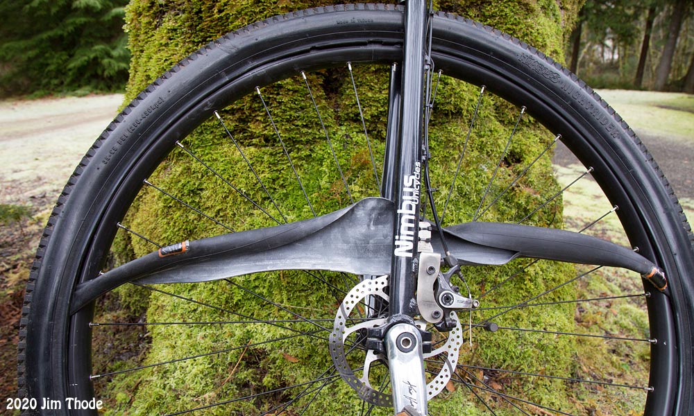

The revoloop TPU Fatty Tube has a range from 26x 3.8 - 5.0

Which valves are you using? Unfortunately, the FV (SV) valves are much more common than AV. I myself hate those thin FV valves. If you inflate them with a hand pump there is always a risk of bending them. I have now contacted manufacturers whether it is possible to produce 20, 24, 26, 27.5, 29 x3.0 with AV valves and asked for quantities and weight. I’ll probably be able to test samples soon. I am very excited.
Only SV valves for me. Most of my rims accept only these valves, so I can’t use AVs. But I haven’t had any issue until now, so it’s OK for me.

I am glad to hear that I am not the only person who prefers AV valves: The whole mountain and road bike industry seems to follow the ridiculous philosophy: “AV for cheap ‘Walmart/Baumarkt’ bikes and SV for all quality bikes and especially high-end bikes”.
I am guessing that with TPU tubes there is a lower tolerance in sizing? e.g. a normal 26" fat tube will usually also work in a 27.5+ or 29+ (my 2 primary Muni sizes). Actually I think I presently have the same normal “plus tubes” from Schwalbe that work for both 27.5x2.6 and 29x3.0.
I would be interested in 27.5x2.6 and 29x3.0 and 29x2.6, even more so if one size would fit for all 3 tires. And only with AV valves, as I also hate the “high-end” SV valves that frequently break and and anything but high-end.
I have never broken an AV valve with a hand pump. However, these SV (FV) valves do! It’s easy to bend the thin valve part that you unscrew.
TPU tubes are not as stretchy as butyl. It doesn’t make sense to use them for different sizes. Once stretched, they stay the same size. But I still think it’s great, especially as touring luggage. I always have a spare tube with me and it’s nice when you don’t have to carry around as much weight. I have not yet tested all aspects of these hoses. I suspect that they are a little more stable at the tire’s air pressure limit and have less of a bouncy effect than butyl. This is probably because they are simply less stretchy. Yesterday I rode a Surly Dirt Wizard at 0.7 bar (26x 3.0) because it was icy on the way home to achieve maximum grip on the road. I found the rolling resistance terrible since I also had to drive up the hill. Of course I missed the direct comparison to butyl. I would imagine that the rolling resistance is slightly higher than butyl at the limit. Since I’m not a physicist, it’s pure speculation. Since the advantages outweigh the advantages, I have no plans to go back to butyl for my personal unicycles.
