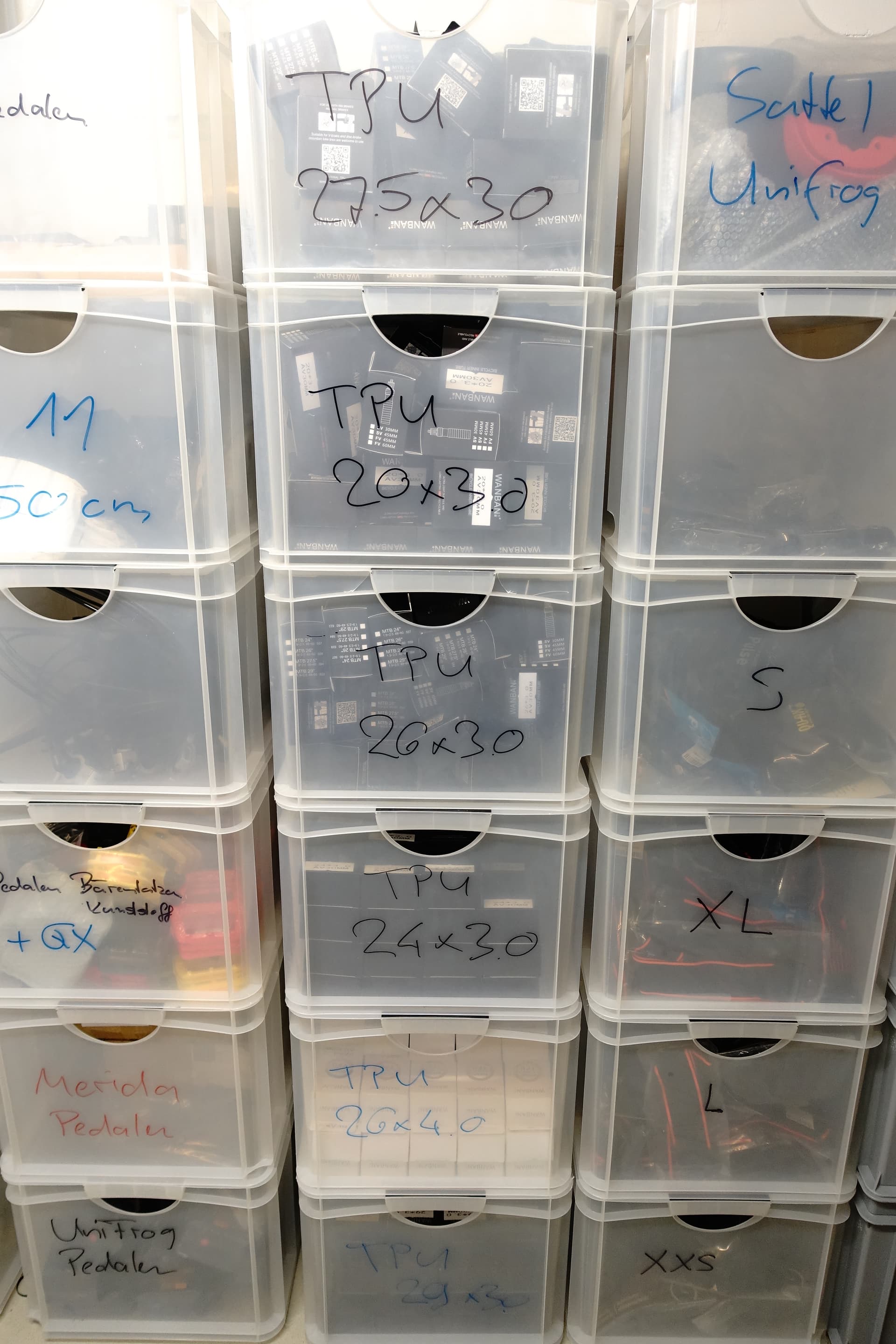

There will only be a small increase in inventory. 600 TPU tubes in 6 sizes are already here
600! Fortunately they don‘t take up as much space as butyl tubes :wink:
