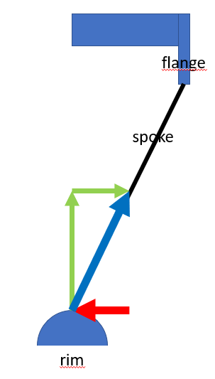

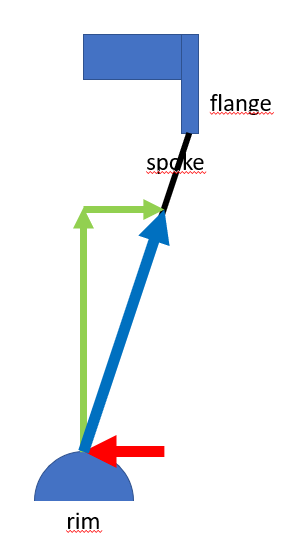

Basically, if you push on the side of the wheel (let’s say with 100 N), it will move a very little bit and put stress on the spokes, which will maintain it in place. But the constraints are vectors, so to resist 100 N from the side, you need 100*(SL/SLx).
  • SL : Spoke Length
  • SLx : Spoke length along the x axis
    So if you get narrower flanges, the constraints increases greatly. You can see a visual demonstration on the following pics :
I appreciate that analysis. I looked up the hub geometries on the unicycle.com spoke length calculator, and (in this model) the difference is more extreme than I expected. The 25 mm difference is split equally between both the disc side of the hub and the non-disc side, but there’s significantly less space on the disc side to begin with, leaving the 100mm variant with just 17.2mm of offset. This means the 100 hub has nearly a 2x greater force concentration on those spokes if the model is representative.
hub & side SLx SL Force concentration
100 mm disc side 17.2 335 19.5
100 mm non-disc 38.4 337 8.77
125 mm disc side 29.5 336 11.4
125 mm non-disc 51.0 338 6.63
