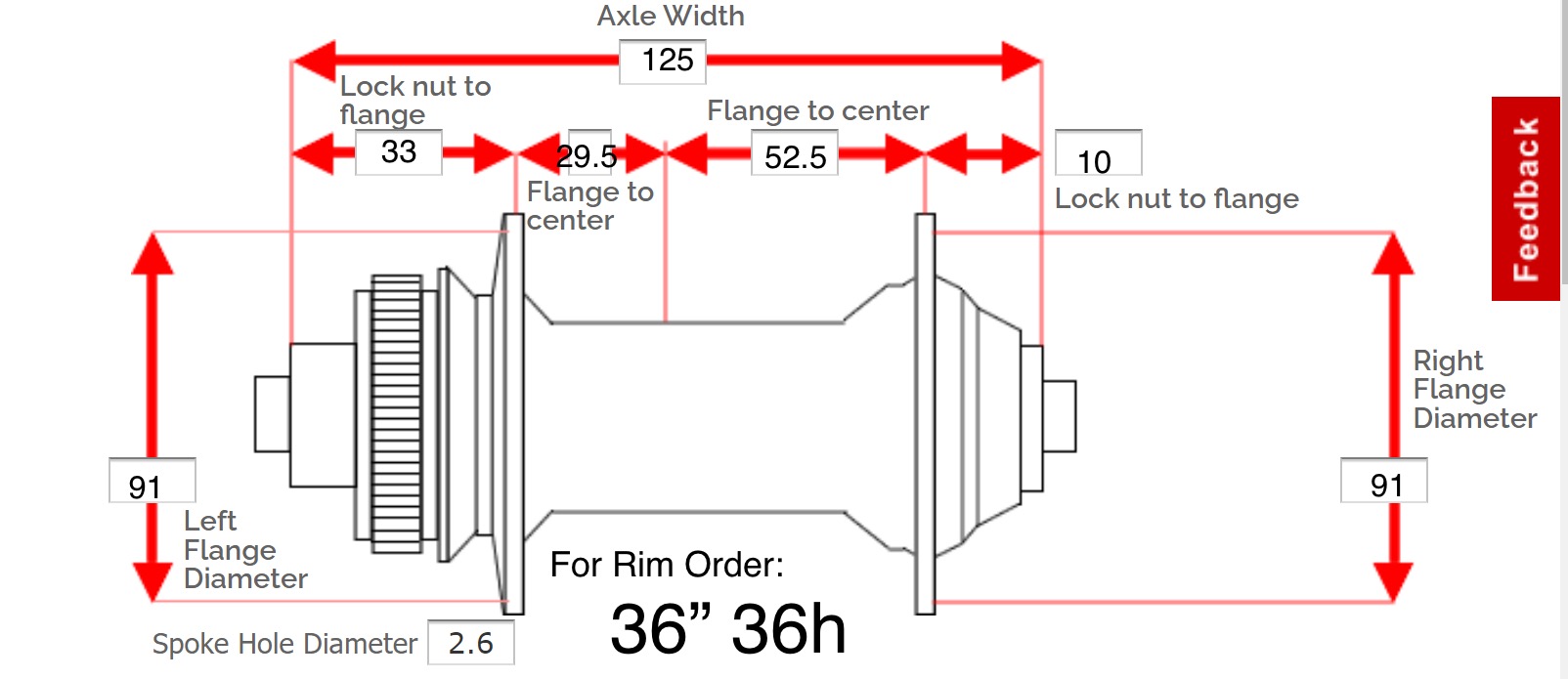

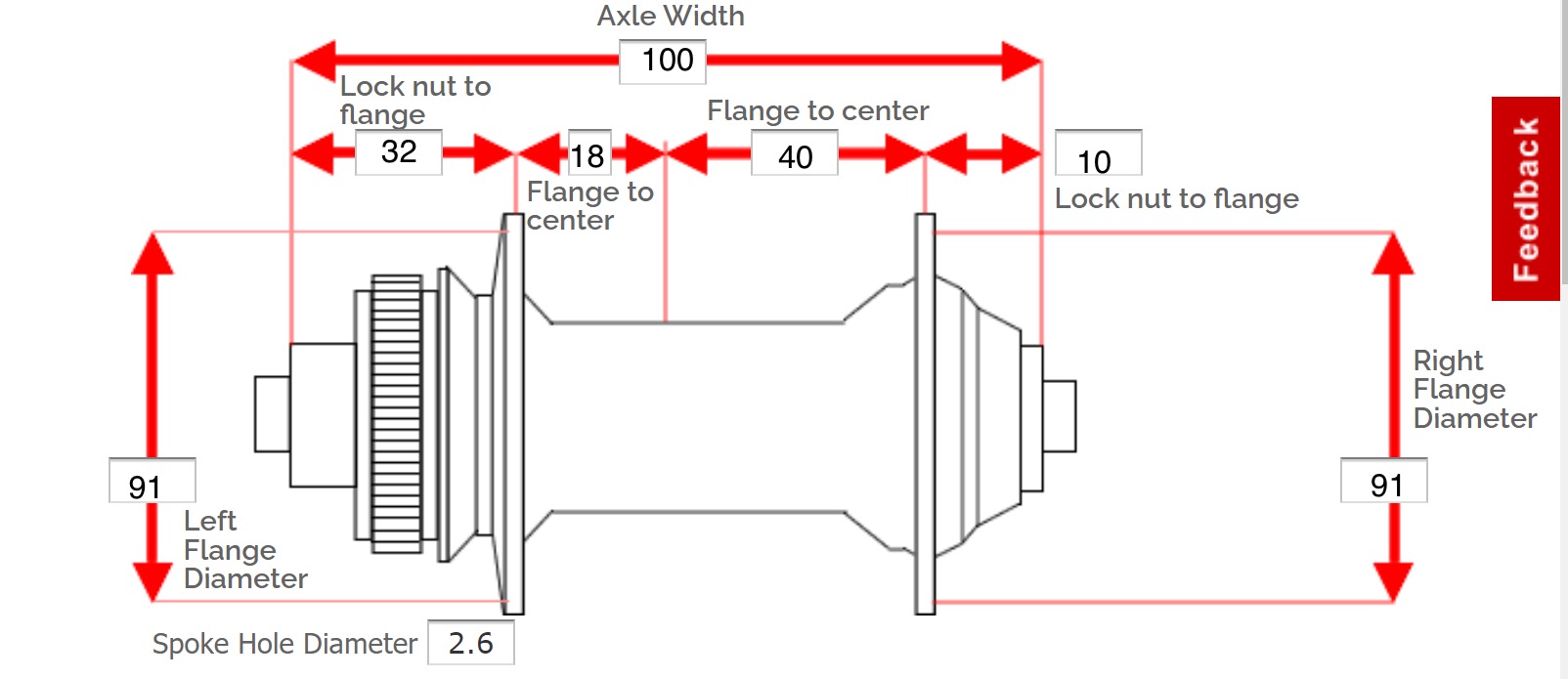

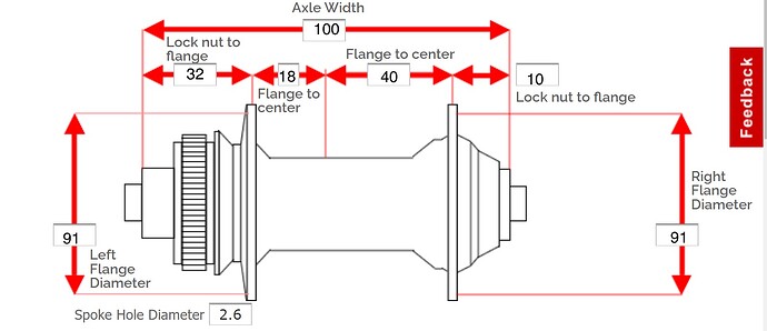

This should be helpful for getting spoke holes drilled to match hub flange spacing at 100mm:
While I’d personally be nudging you towards a 125mm hub regardless of the limitations re frames for this (Nimbus or Flansberrium) - the good news is however - with an asymmetrical rim such as the one from LB and good spoke hole drilling angles - a 100mm hub can be built up to be pretty strong - and stronger than any 100mm 36er Schlumpf with either the new disc hub or the BrakeFast set up heretofore (using the previous symmetrical rims available)…
So the magic sauce here is the LB rim and probably evens out the gains you’d get from a 125mm 36” wheel build.
The above screenshot numbers should help you figure out spoke lengths for the LB rim.
Lots of chatting mostly to myself here: Game changer - 36er CARBON wheel! - #313 by mindbalance
… around ERD shenanigans - main up shot is LB list the ERD as 755 but in reality this isn’t where the nipples’ heads / spokes are destined to wind into so depending on nipples used - it is needed to add around 2mm per nipple or more again depending on nipple - but that all makes sense 759 being 755 + 2mm + 2mm as a base line.
I built my 125mm hub with 360/362 spokes so you can probably fathom the ERD I ultimately decided to go with.
I’ve probably gone and over complicated it for you now - but wanted to still share this as getting A-OK spoke lengths will make for a really robust wheel. In short. Worth the head scratching and manual ERD measuring when you have your rim + desired nipples :nerd_face:

Alright, well, after sleeping on it you all have convinced me 125mm is the way to go. I take it then I’ll require 360/362mm spokes based on the ERD you went with, @mindbalance?
In the back of my mind I was also considering a 29" Schlumpf as a good all-round hill climbing/distance uni (more portable for flights, too) in which case I could’ve used the 100mm hub. But, guess I’ll have to become a billionaire to own two Schlumpfs at once one day!
Very true. I was probably trying to not be too much of an advocate for the hub I’ve got - there’s always that sense that we’d recommend what we have / know, rather than be fully objective.
This is very true in the sense the 100mm hub is more versatile for other wheel builds. Nothing stops you moving the 125mm hub to a 29” wheel but it would require a Hatchet frame or perhaps using a 32” nimbus frame. Not as adaptable I guess - but not impossible to make work.
Going back to the 125mm - as the current deal price it is just the better value - and likely to be a rarer / more unusual Schlumpf down the road. Plus you’ll have zero issues with rotor clearance given the wider hub and better bracing angles of the spokes.
Should be 360/362 but when you get closer to the build - I’d recalculate them as nipples etc make a difference - I can do this for you nearer the time.
If you’re ordering the 125mm you’ll need to let LB know these details for the drilling angles for this - or just say: drill it like Felix’s 36” rim :joy:
