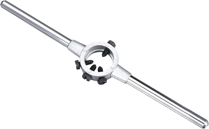

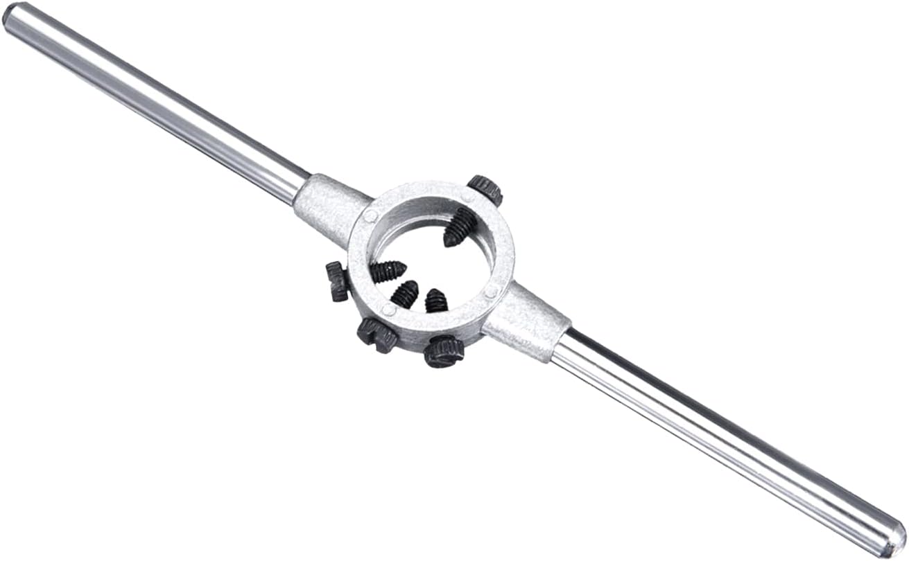

I maybe misunderstood what you were going to do with the wing nut, but I don’t think you are meant to cut it into two pieces, just a single slot on one side. I think that that is then supposed to act like a ‘die’ when you thread it on to the remaining thread, cleaning out the damaged threads as a die would but less aggressively – the saw cut allows for the damaged parts to ‘cut’ out and cleared.
I’m also not quite sure why you want to cut the die you have. Do you have a die stock to hold it? Something like the one linked below (the first I found on Amazon, so nothing specific). You just put the die in that and thread it on. You’ll see the screws I mentioned in the post above in that photo, the screw by itself (opposite the group of three) should go into a split in the die, as I mentioned above, you can use that to open up the die a bit so that it doesn’t cut too much.
If you think of your die in a die stock/holder like that you can see the analogy with a wing nut.
