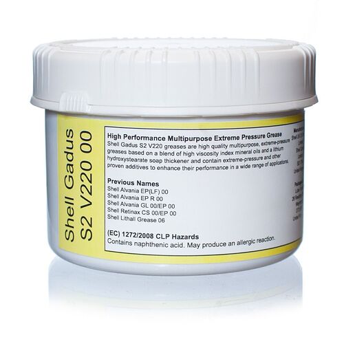

I asked Florian if this grease was OK to use on the new hubs: Shell Gadus S2 V220 00 - 400g
Pretty sure it is very close to what has previously been provided. Got two of these tubs and it’ll last me until the year 3023!
The advice I got back to my query regarding this product was:
Indeed “00” refers to the viscosity, and we use “00” too. So this may be quite good, and you know the qualities already. The only thing that can occur, is, that it’s getting stiff at low temperature, with the risk of unproper shifting.

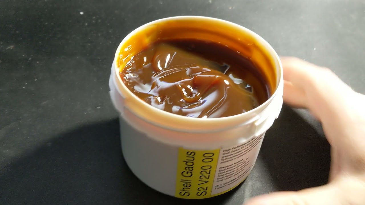

Looks like caramel, don’t you just want to pour some over vanilla ice cream? :yum:
It does look like (quite runny) caramel, but certainly doesn’t smell like it! However there maybe could be cautions on the tub to warn people with a bad sense of smell! (I recently bought some daffodils that had a label saying ‘Do not eat!’ - on flowers?!)
