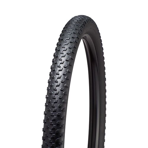

Sorry. A bit late on the reply but I ride a Specialized Fast Trak T5 in the 2.35 size. I ride mixed trails, asphalt and packed limestone screenings. I find that on pavement I don’t feel the tread but it is very grippy but on the trail it is amazing.

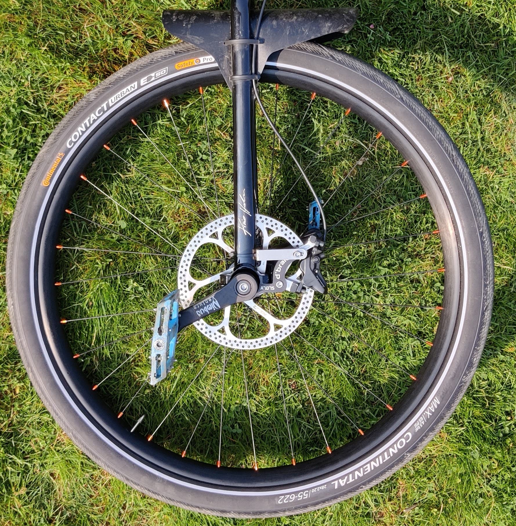

I bought the Contact Urban in 29x2.2 (622-55) - could not find the 2.5 anywhere.

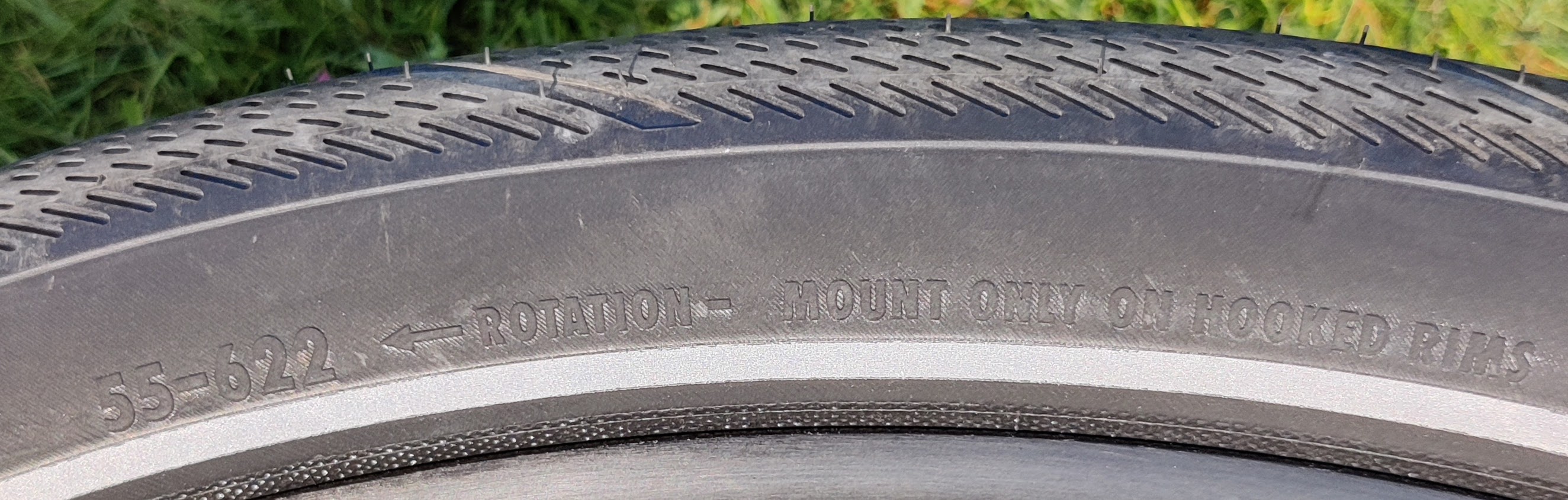

“mount only on hooked rims”… sure …
I have mounted it with an inner tube on a Race Face AR 30 (30 mm inner width) which is hookless. I put 3.1 bar in the tire and left overnight and reduced it to 2.8 bar before taking it for a ride. No issues with the missing hooks. Don’t know if it possible inflating to the max of 4.5 bar on a hookless rim but I have no intention to do so.

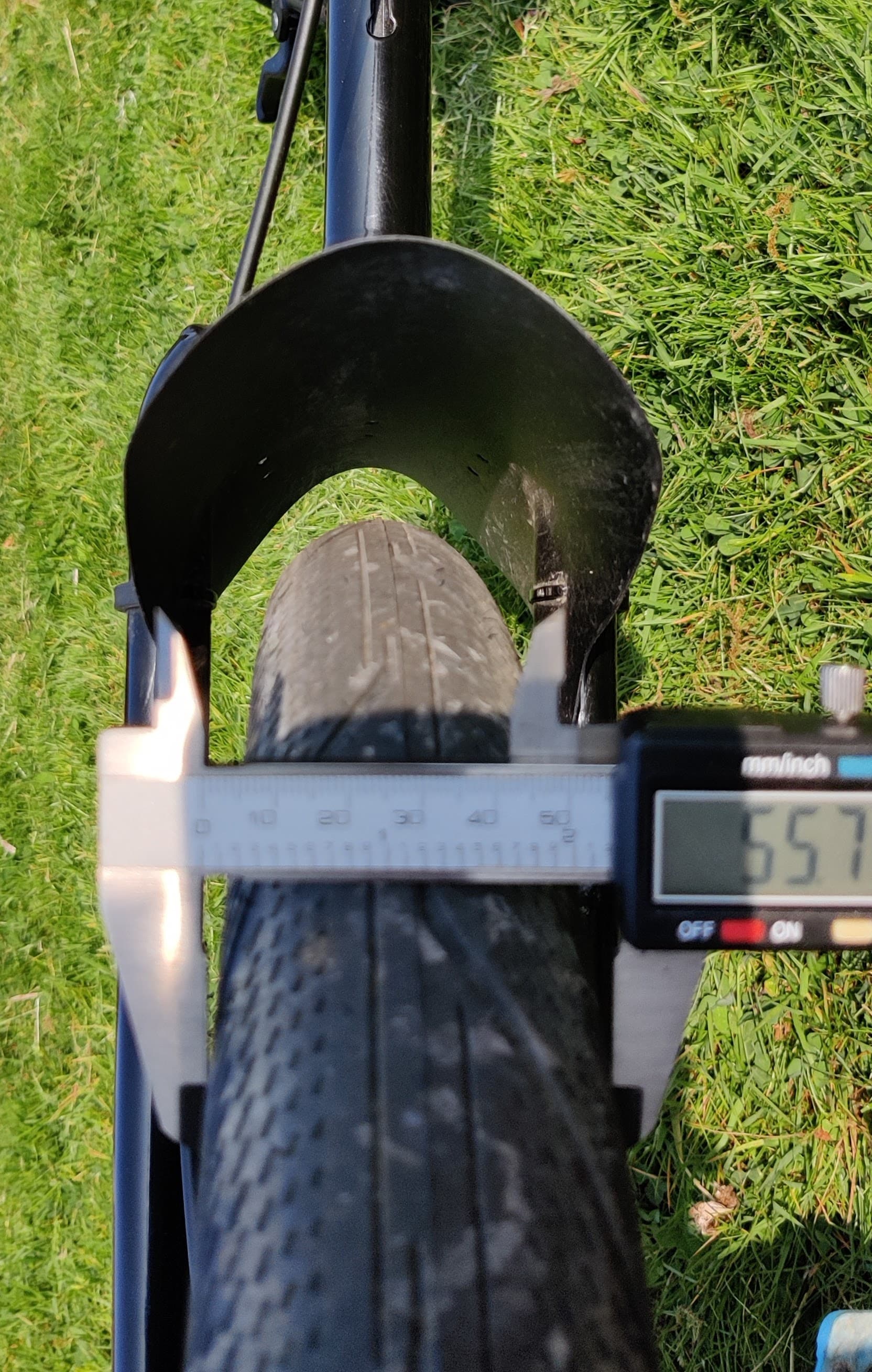

It has a round profile and measures just below 56mm.
I have approx 20km on the tire now and it’s nice and quiet on asphalt and seems to handle the dry gravel sections around here just as fine as my knobby tires.

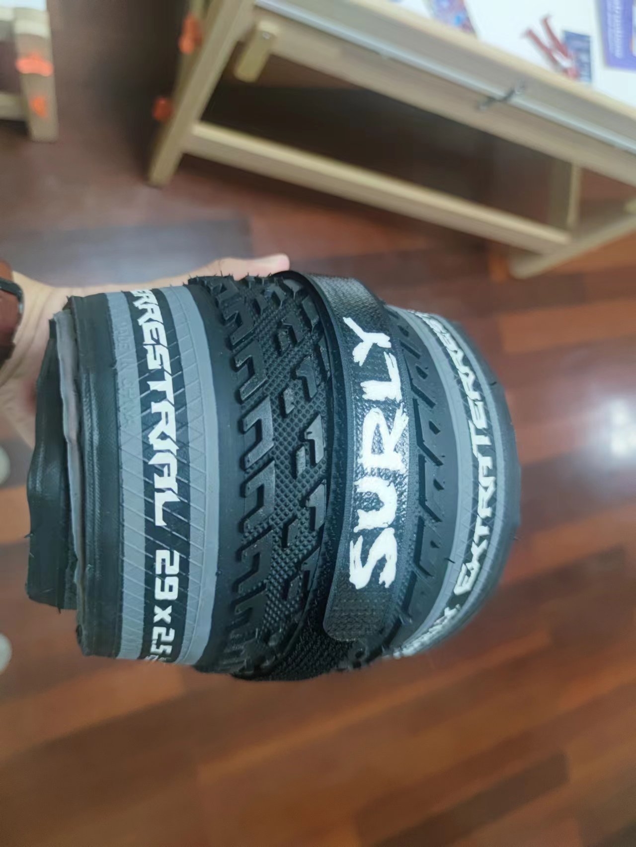

Apparently the Surly ET has an extremely tight bead, the LBS guys failed to install it, they broke two levers and only managed to put on one bead. I wondered if @Tripthebalance and @pierrox, and any others who have used this tire, had the same problem? Any insights?
Thanks! I failed to install it myself before I took it to the LBS. The tire is ridiculously tight, I’m starting to think if my rim has some tolerance problem.
It’s a Nextie carbon wheel, 35mm inner width.
I’m gonna see if another LBS can handle it, if not I’m afraid I’ll have to choose another tire.
