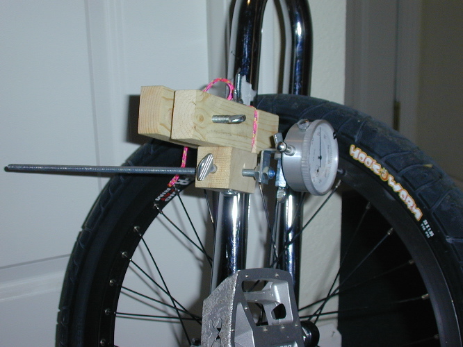

My latest use for threaded rod is in a jig holding a dial indicator for wheel truing.
The various thumbscrews let me adjust the position of the indicator for measuring roundness as well as lateral truing.
Ken
What a neat idea for wheel truing. Yet another credit to the ingenuity of the unicyclist.

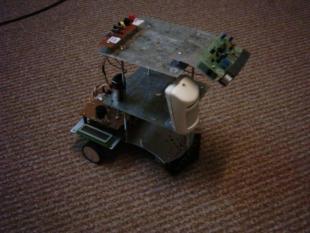

It’s clearly there for
The threaded rod is clearly available in the hardware store for the singular purpose of allowing robot hobbyists to quickly add new decks to their creations.
Apologies for the darkness and size of the pic. I haven’t got photoshop running yet.
