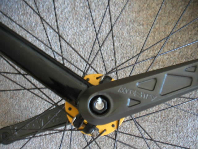

'Visually' check the tightness of your nuts
This is something that makes sense. (That’s why it took me 2.5 years to figure it out :()
By dabbing whiteout on both the nut and the spindle, you can see if your nut has come loose when they aren’t in the same place any more.
However, if your nut spun exactly 1 turn, you may not be able to tell.

Apparetly it’s only the short Monty cranks (I have the 158’s)that don’t seat on the spindle. I just got back a few hour ride with many drops, grabs, and the fun stuff, and my white out remains intact :slight_smile:
I’m putting shorter cranks on my 29er so I can do the Unithon in under 24 hours. I assume the aforementioned and aforepictured nut is the thingy that holds the cranks on?
Shouldn’t you have an opaque plastic cap there? That way the rain won’t wash away the white out? :slight_smile: Anyway, thanks for showing all of us what’s behind those plastic caps.

Those plastic caps, although useful at retaining the nut if it falls off, get in the way of checking and tightening. I throw them away, as I’m always changing cranks around.
I thihnk that white out is pretty solid there, if not, I have more

Finger nail polish would probably be more durable.
Dust caps would be needed to make anything survive for a long time.
Doug
I use a black Sharpie to mark the spindle and nut.
