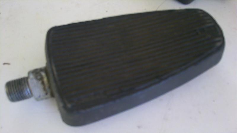

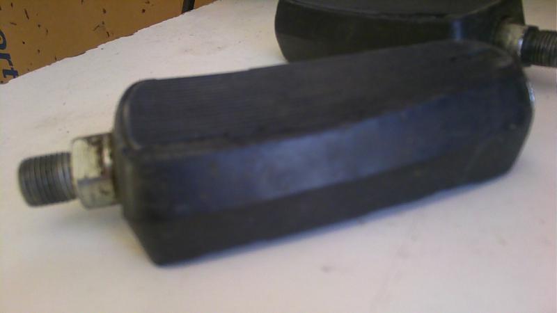

I have an original 1967 Schwinn uni that I inherited from my uncle. These are the pedals that came on it:
I am not sure what size they are, and I doubt that you will be able to find another pair…

Yup, love those old schwinn “wedge” pedals. Not. I don’t know what they were thinking with those…
