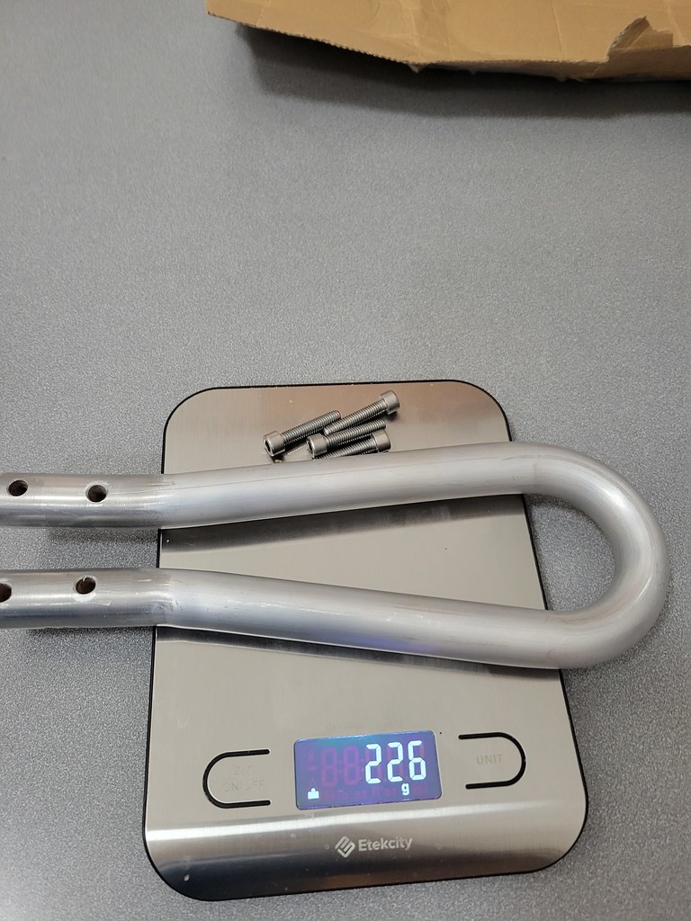

Total cost was $78.60 for me, for a small/short bar shipped to the USA.
It goes for the shipping and the bar. It’s not so expensive.

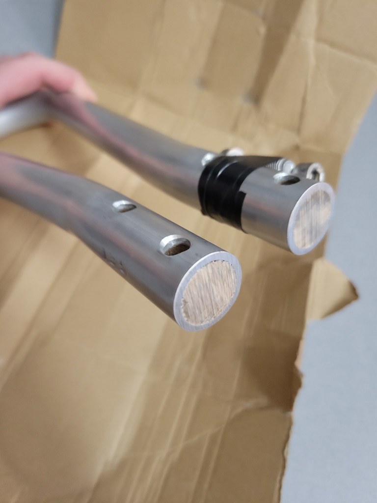

The ends around the bolt holes are filled with some kind of filler, Bondo maybe? Anyways that explains why you won’t have any problems with the bar smashing down by [over] tightening the mounting bolts and it also seems like it would significantly strengthen the bar against kinking near its highest stress point.
Test fitting it, it felt very solid. I think it will work great.

hi, the filler are wooden.

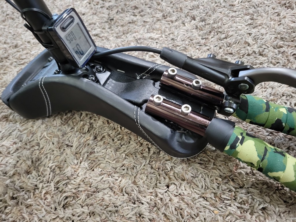

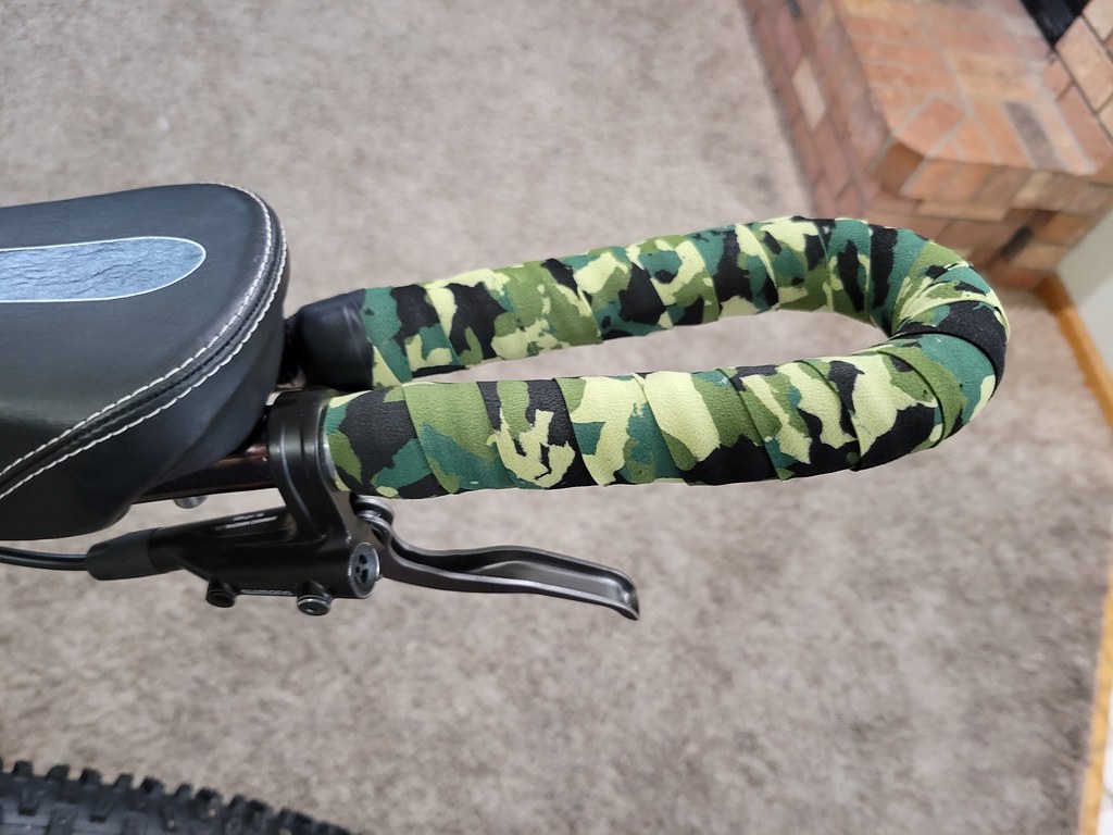

Well I didn’t get a chance to get to the auto store so I just ordered the stuff online I ended up getting that self fusing silicone tape you mentioned above Ryan as a pre-wrap (great suggestion btw, i think it helps with padding, adhesion of the top tape, and probably to ease future removal) followed by the below:
MARQUE Suede Bike Handlebar Tape - Road Cycling Bicycle Handle Bar Wrap for Drop Bars with End Plugs - 2PCS per Set Amazon.com
It’s not a good time of the year to paint and I didn’t like the silver bar ends against all the black, so I improvised using a black permanent marker for now.
I’m happy with the appearance, it feels great --not sure about the durability yet-- but as Ryan says, I have enough to do it a 2nd time when this one needs replacement.
